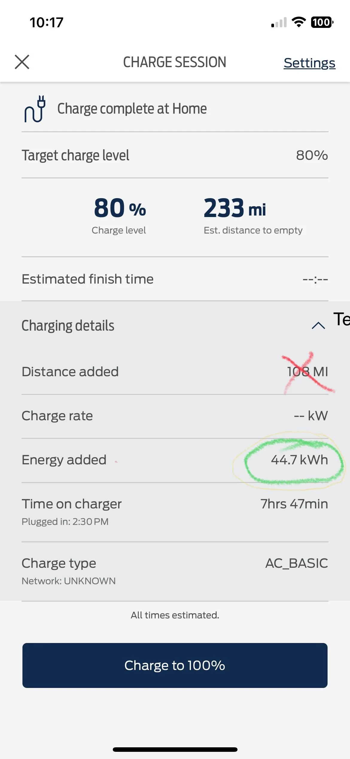

I track my Lightning charges. The Fords pass app will give you two different energy added numbers dependent on if the truck is still connected on the charger. If you look at the charge log while the cable is still connected you‘ll get a kWh to a 10th of kWh. Ignore the miles added. Not even close to accurate. This is what you get even while actually charging.

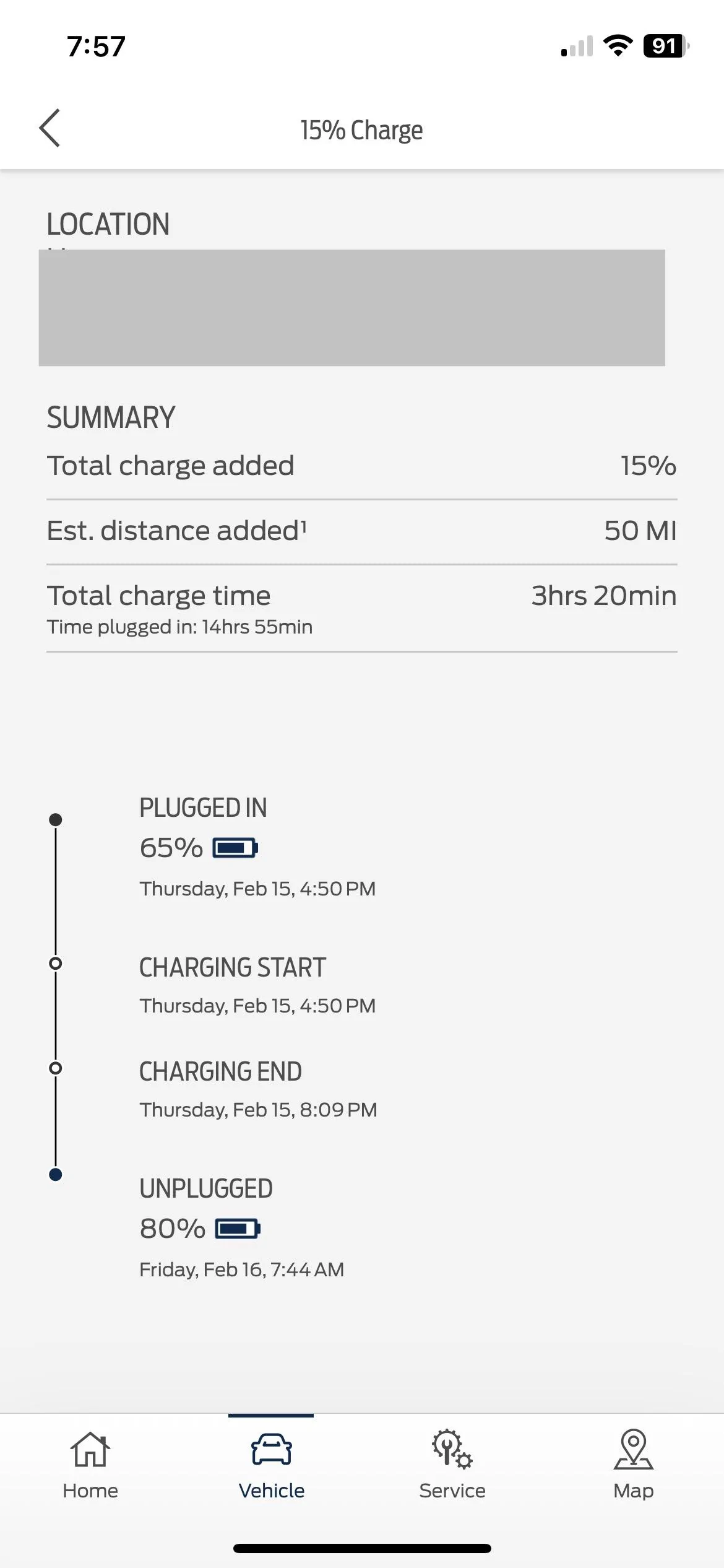

But if you disconnect the cable you get this... just the %. You’ll have to multiply by 133kw to get actual kWh added. I’ve found that they are very close. Within pennies on my calculations.
