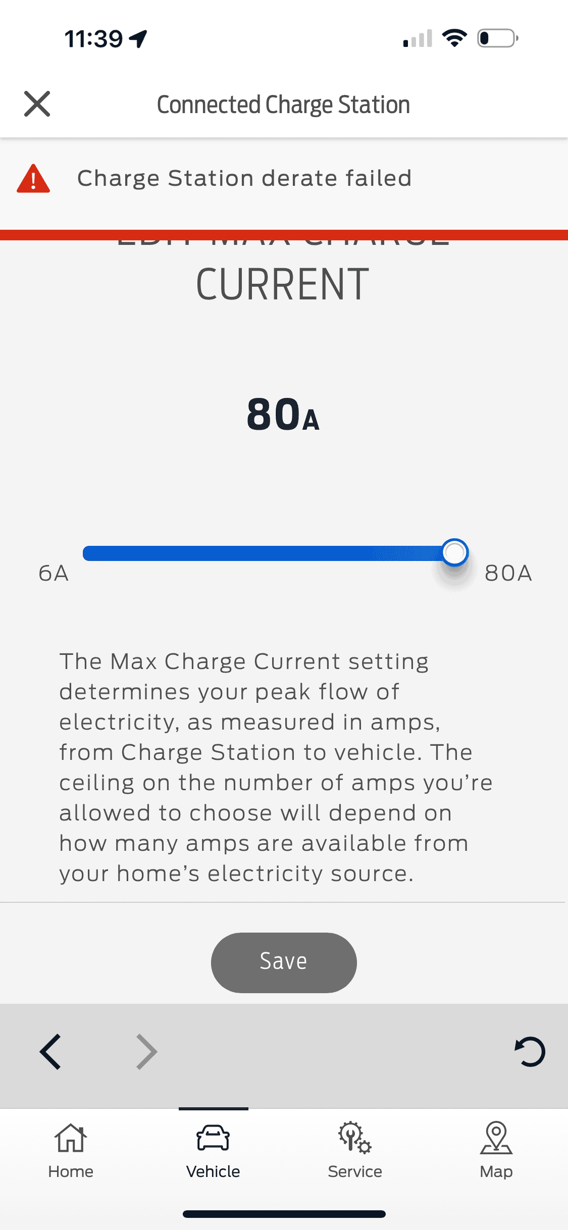

Unfortunately I didnā€™t get very far. I get this error when trying to derate below 80A. I tried removing and reconnecting the CSP from Ford Pass but still get the same error.

Next charge I tried to move the app to 56A and it fails to update with the error ā€œcharge station derate failedā€ - good.
It will only let me save the app setting to a max of 48A, which matches the dial setting - good.

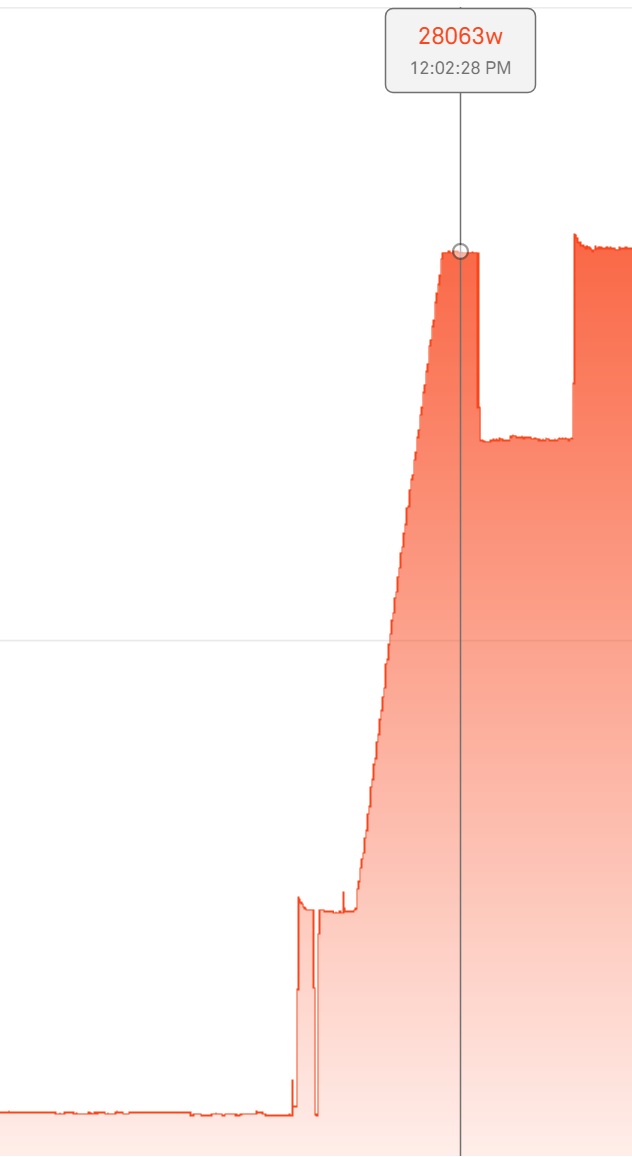

Mine is a little more specific. What I mean by that.. is I ran 2 gauge wire and installed a 100amp breaker. so my physical switch setting is on 7 = 80amps. This part works and I can confirm using my home energy monitoring system sense.com that the number of kW being consumed equals out to around 82amps.
When I go into my FordPass App and adjust the rate down to anything below 80. I've tried 50,40,30,15,6. The kW being used according to my monitoring system do not go down at all.
I have a wallbox charger as well and it supports turning down the AMP's. I can clearly watch the kW drop on my sense.com monitor.
So what I am saying it's not guess work. It's actual data showing it's not dropping. I am curious if anyone else has similar tools to validate if it's working as expected or are most people just trusting the app that it adjusted down. I hope this makes sense.

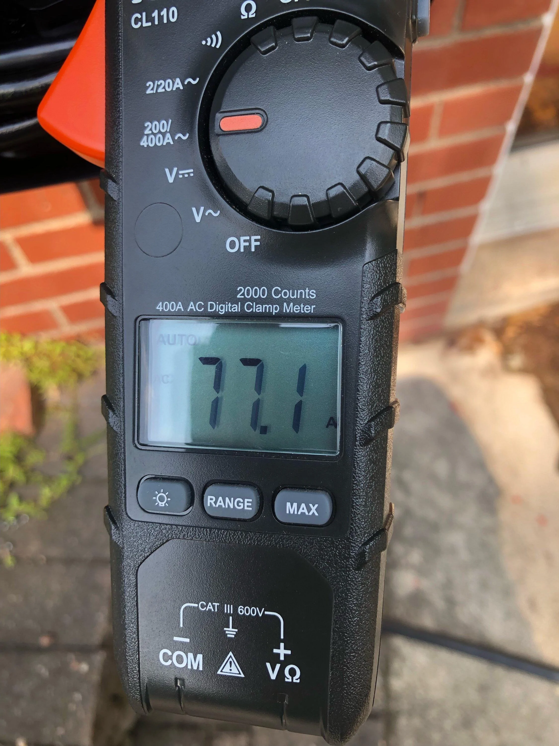

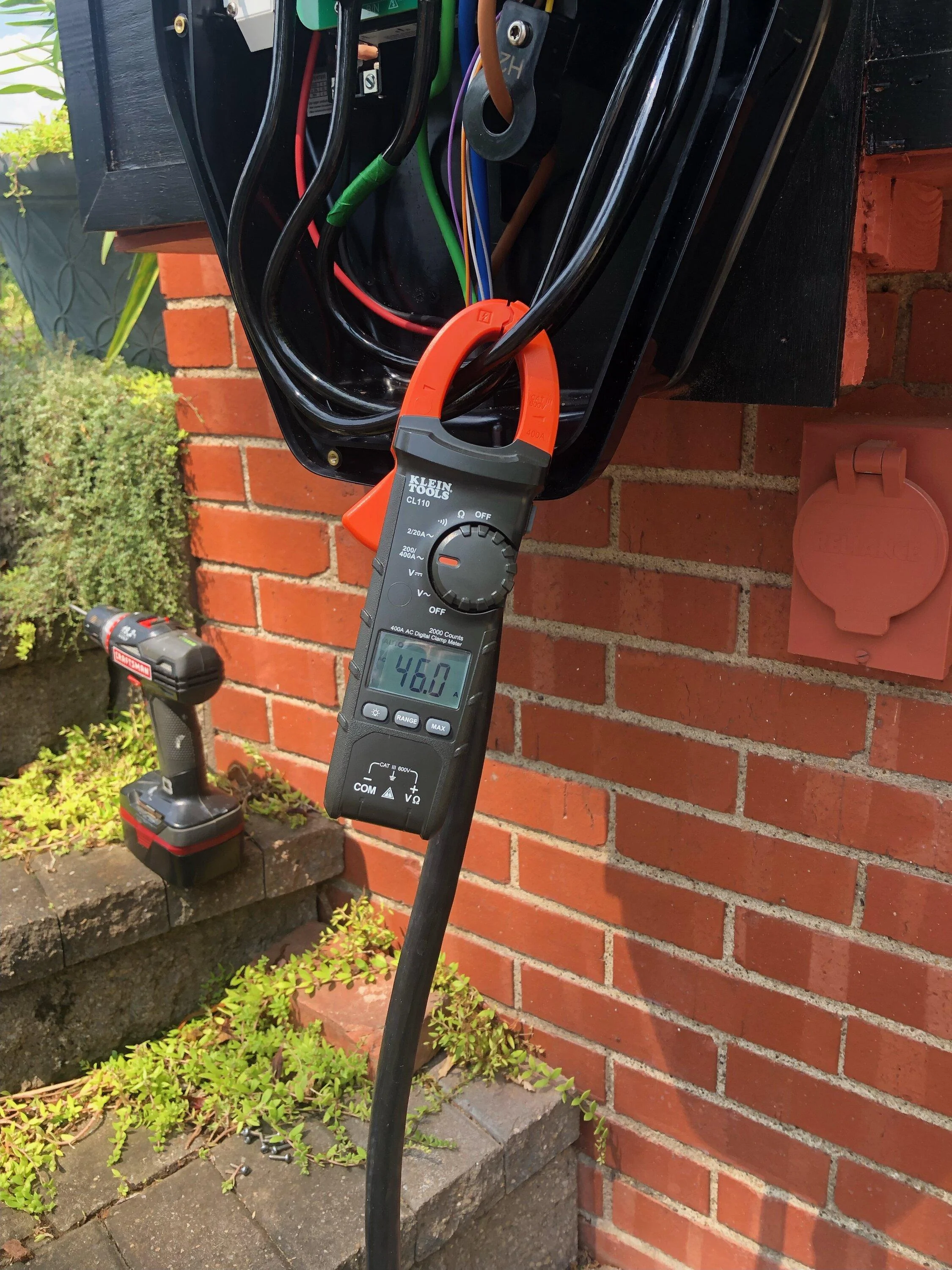

I measured withnclamp meter

So if you turn yours down in the Ford Pass App does the AMP draw go down? Mine does not.
Exactly. Those readings are for 48 amp and 80 amp settings. Iā€™ll concede some error in the clamp meter but not much. Maybe a few % of reading.
I apologize.. I didn't see the second photo of it showing the lower amperage.. Ok.. well maybe there is something wrong with mine... :(

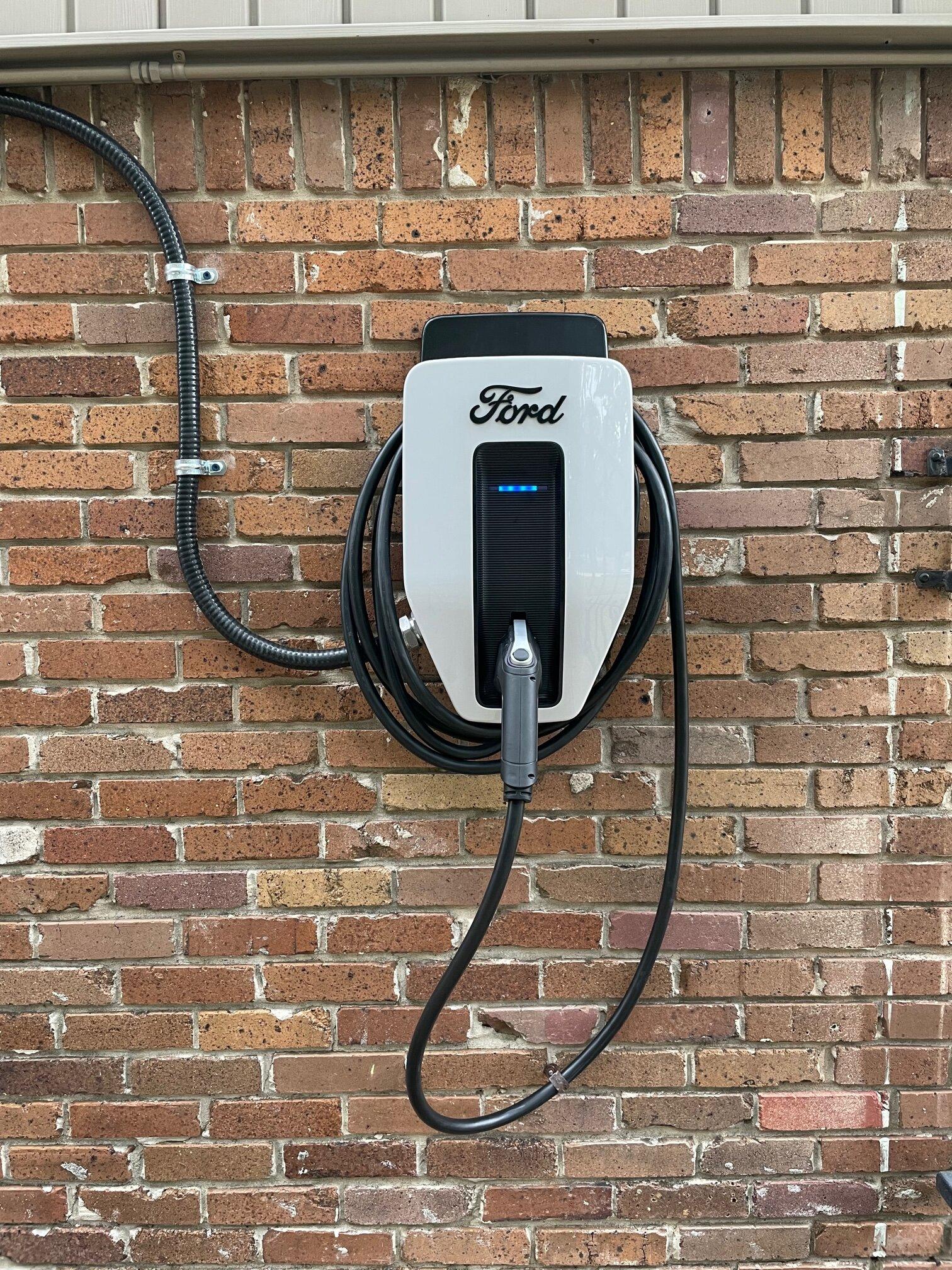

Couple pictures of my self-install:
Ford F-150 Lightning Charge Station Pro Charge Rate 1667090612823
Ford F-150 Lightning Charge Station Pro Charge Rate 1667090663903
Ford F-150 Lightning Charge Station Pro Charge Rate 1667090769137
