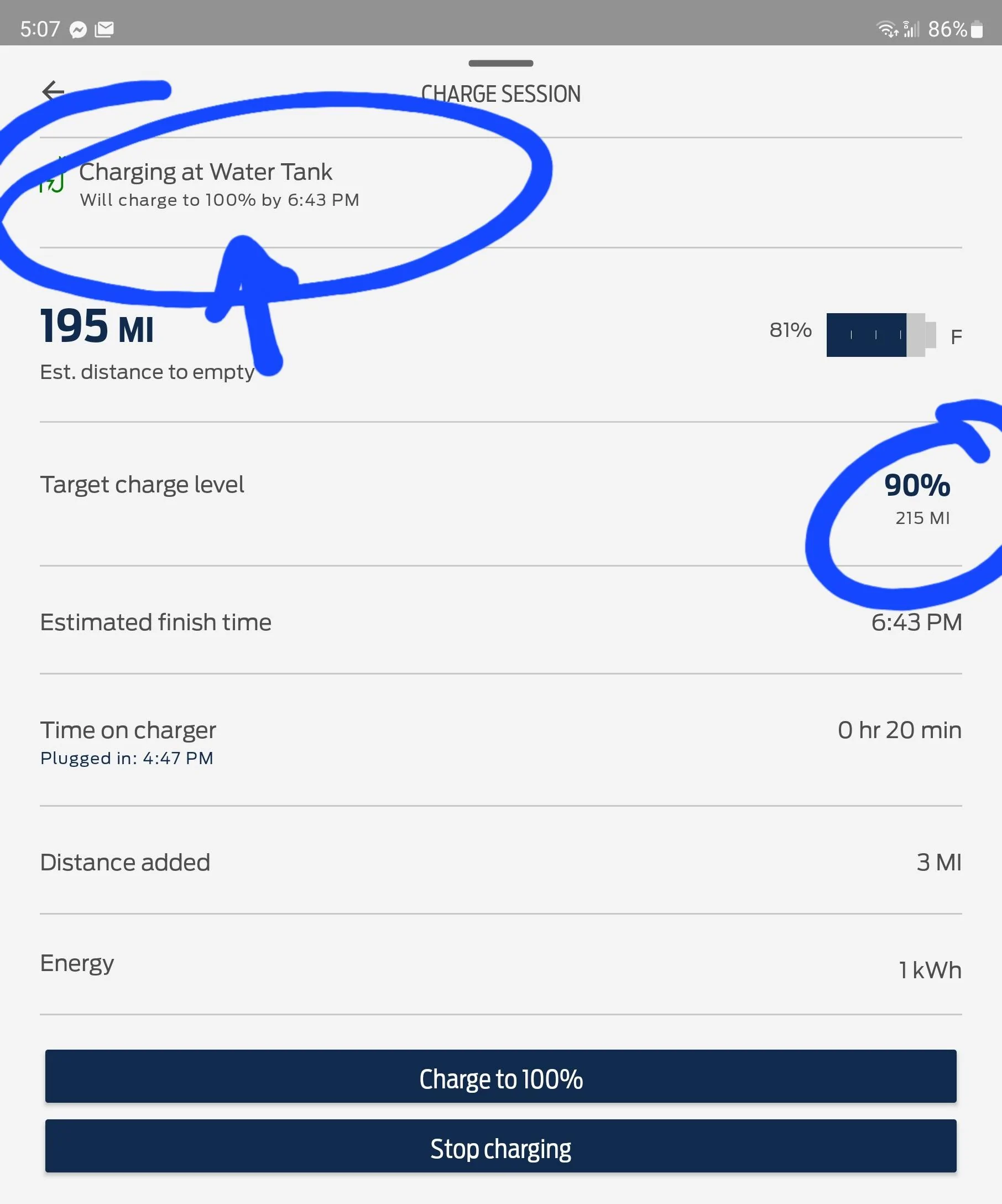

I use the mobile charge on a NEMA 14-50 outlet on a 50 amp breaker. From the moment I got the truck, I had Max Charge set to 90%. Worked great until one time i decide to click "Charge to 100%" on the Ford Pass App. Ever since, it consistently charges to 100% when it show Max Charge set to 90%. I have my preferred location selected and it still does it. Under Charge logs it shows charging at the selected location but ignores the Charge Limit i set.

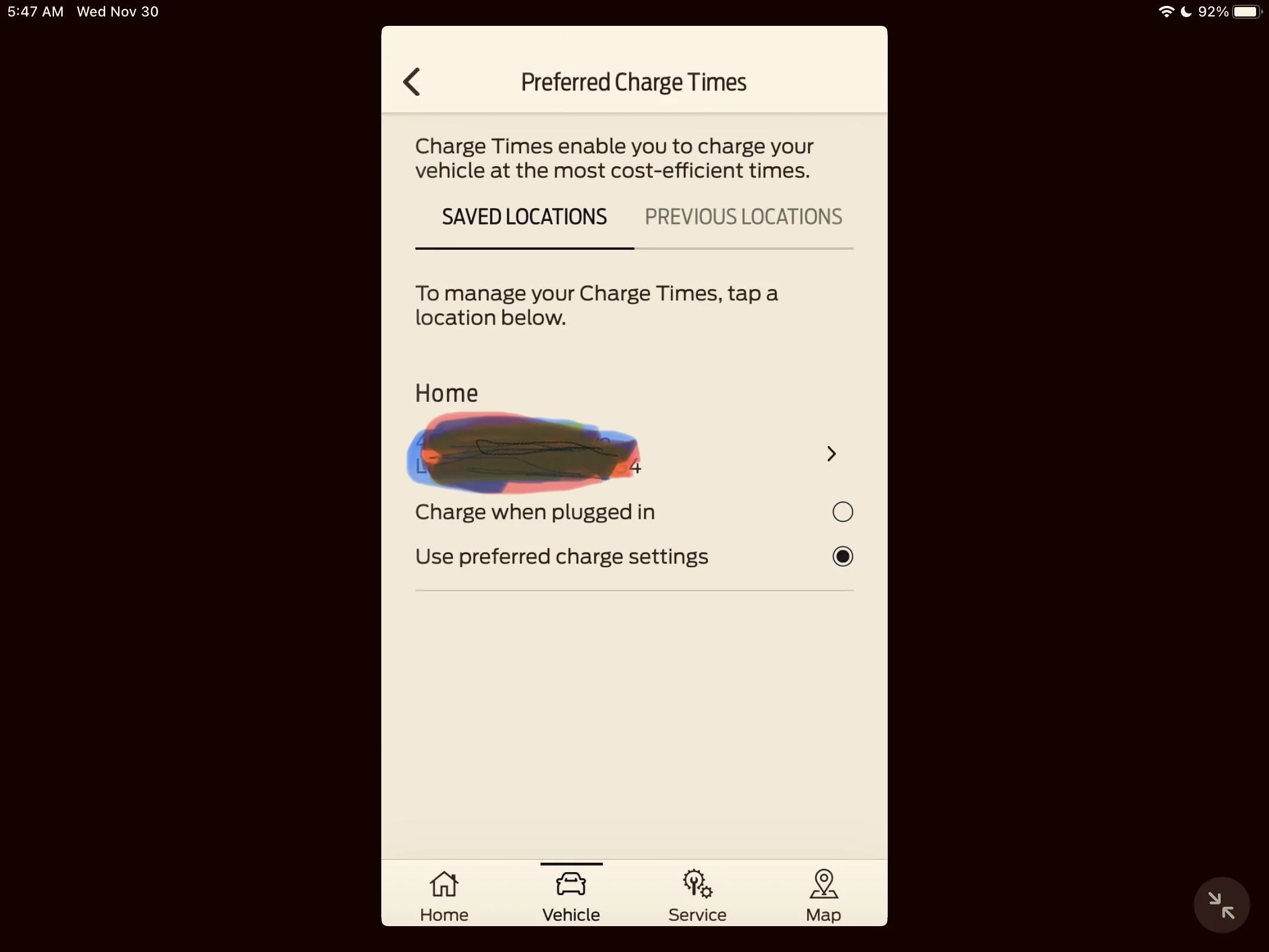

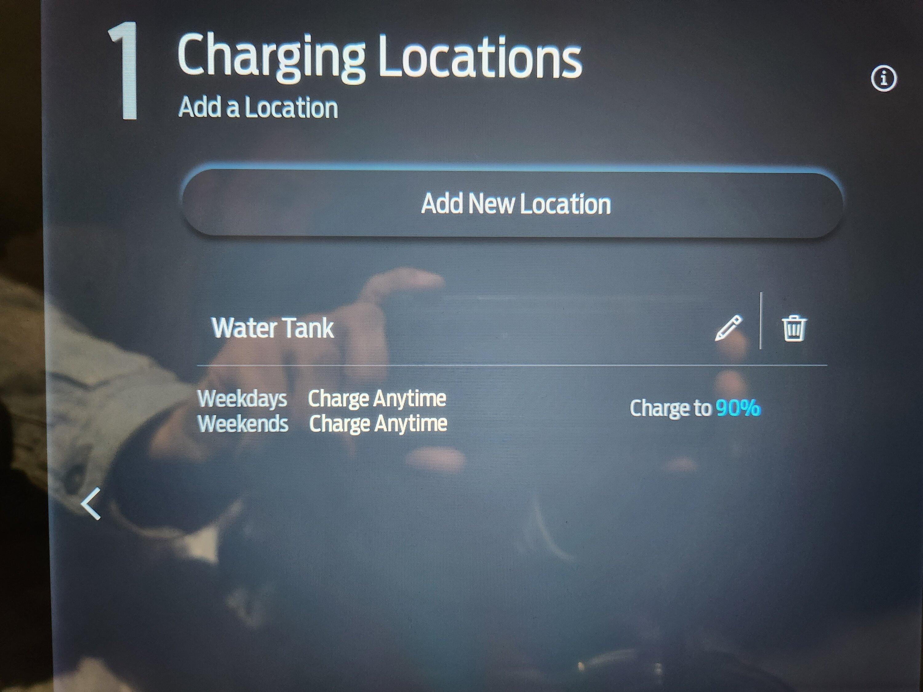

Try editing your home charging scheme, increase to 95%, make sure both weekday and weekend time frames are defined for your needs, save the change, see if it works properly on the next charging session.
If it does stop at 95%, then edit it again to 90% see if that solves the problem.
