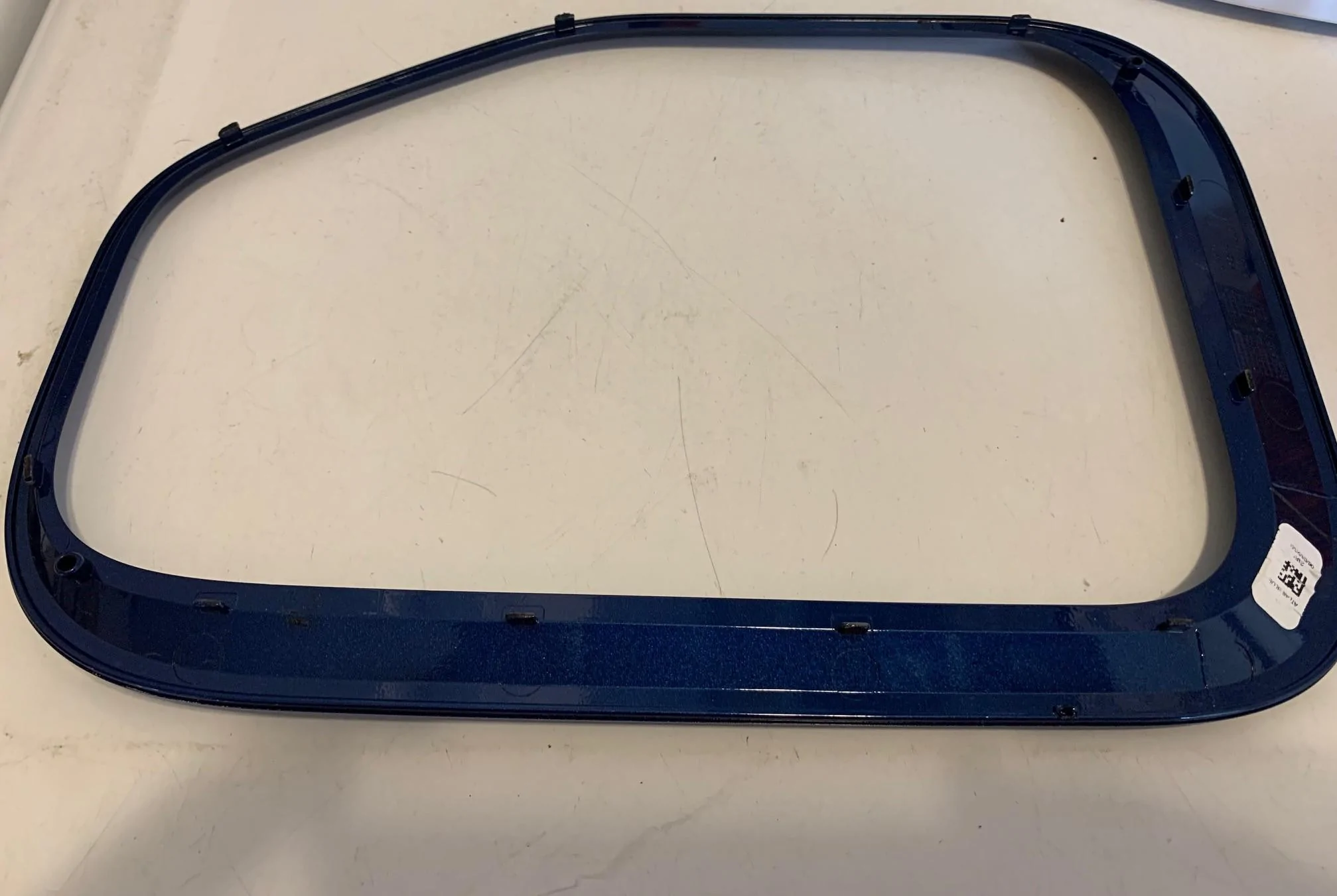

Mine has been loose since day one. I don't see any tab with any type of catch on it.
Ford F-150 Lightning Charging door trim not assembled correctly - how to remove? IMG_5613
Any chance you could send a picture of what yours looks like when it's off?

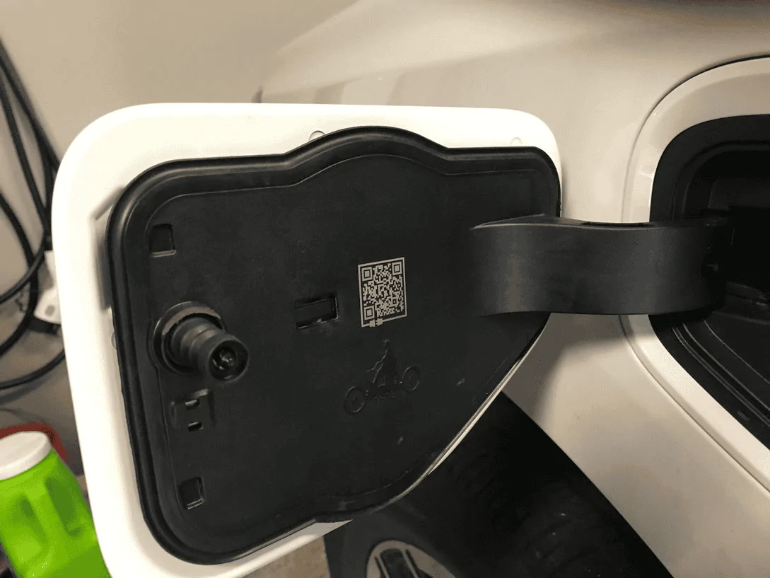

Here is a photo of the charging door. I needed to remove the white outer portion. As mentioned, just pull up on the tab in thee middle of the black portion next to the QR-code and the white portion slides off (to the left in this photo).
