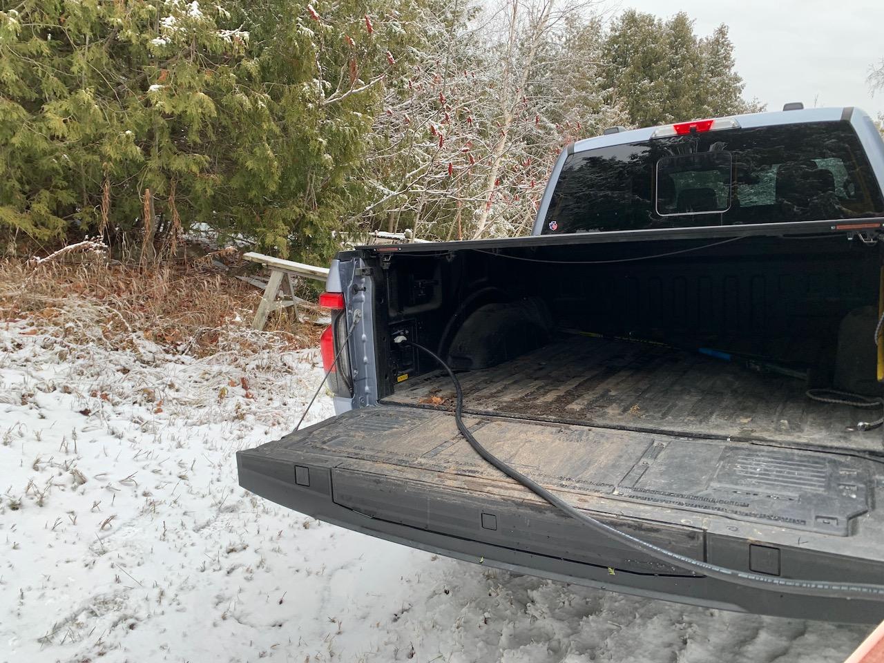

I live in southern Ontario in an off-grid house I built ~20 years ago. I have 5kW of solar panels on the roof feeding into a 48VDC lead acid battery bank. For about 8 months of the year I produce a surplus of electricity which I cannot store (when the batteries are full they're full). Since I am not attached to the grid, and attaching to the grid is impractical and expensive as I'm ~1km from the nearest pole, I wanted an EV so that during the 8 months that I have a surplus I could send the surplus to my vehicle. When the Lightning was announced it was a dream come true. I traded in my 2019 Honda Ridgeline on a 2022 Lightning Lariat ER.

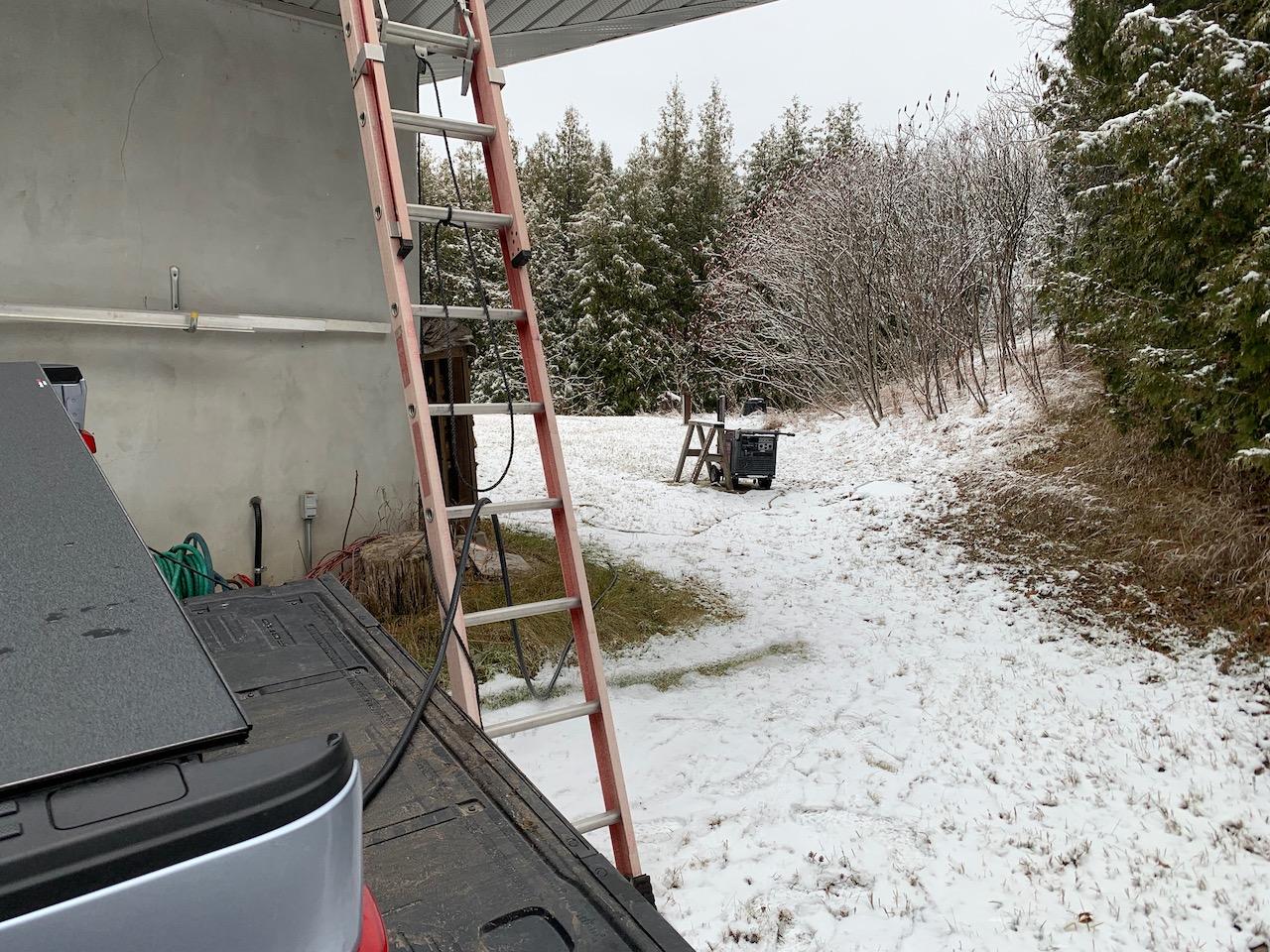

This fall we sorted out the cables, grounds, and inverter settings to connect the truck to the house so that we can use Pro Power On-board to charge the house from the truck instead of the Honda 6500i gas genset that I normally use. Thankfully both the truck and the gas genset use the same 240V twist lock plug type so I can use the same wire for both.

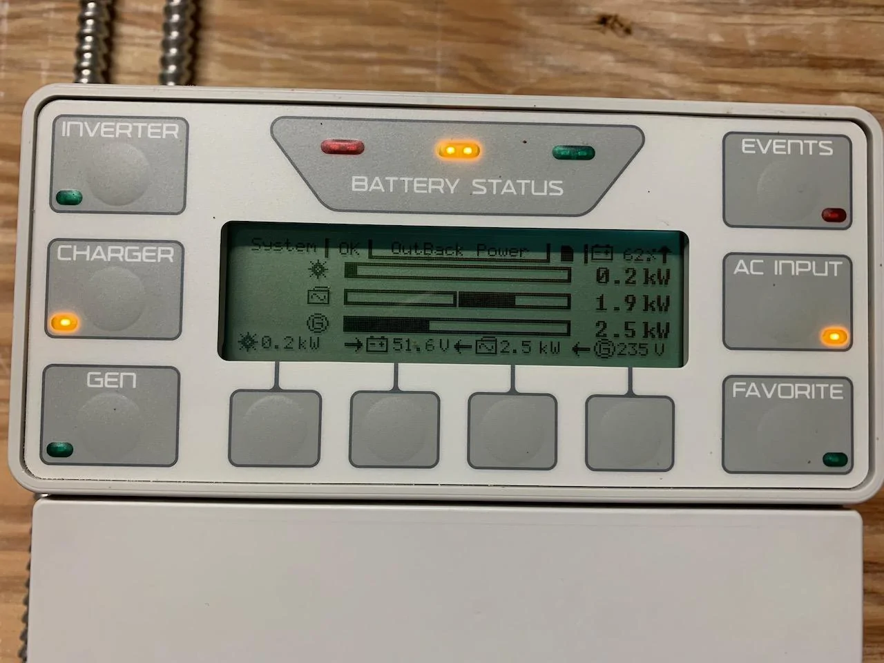

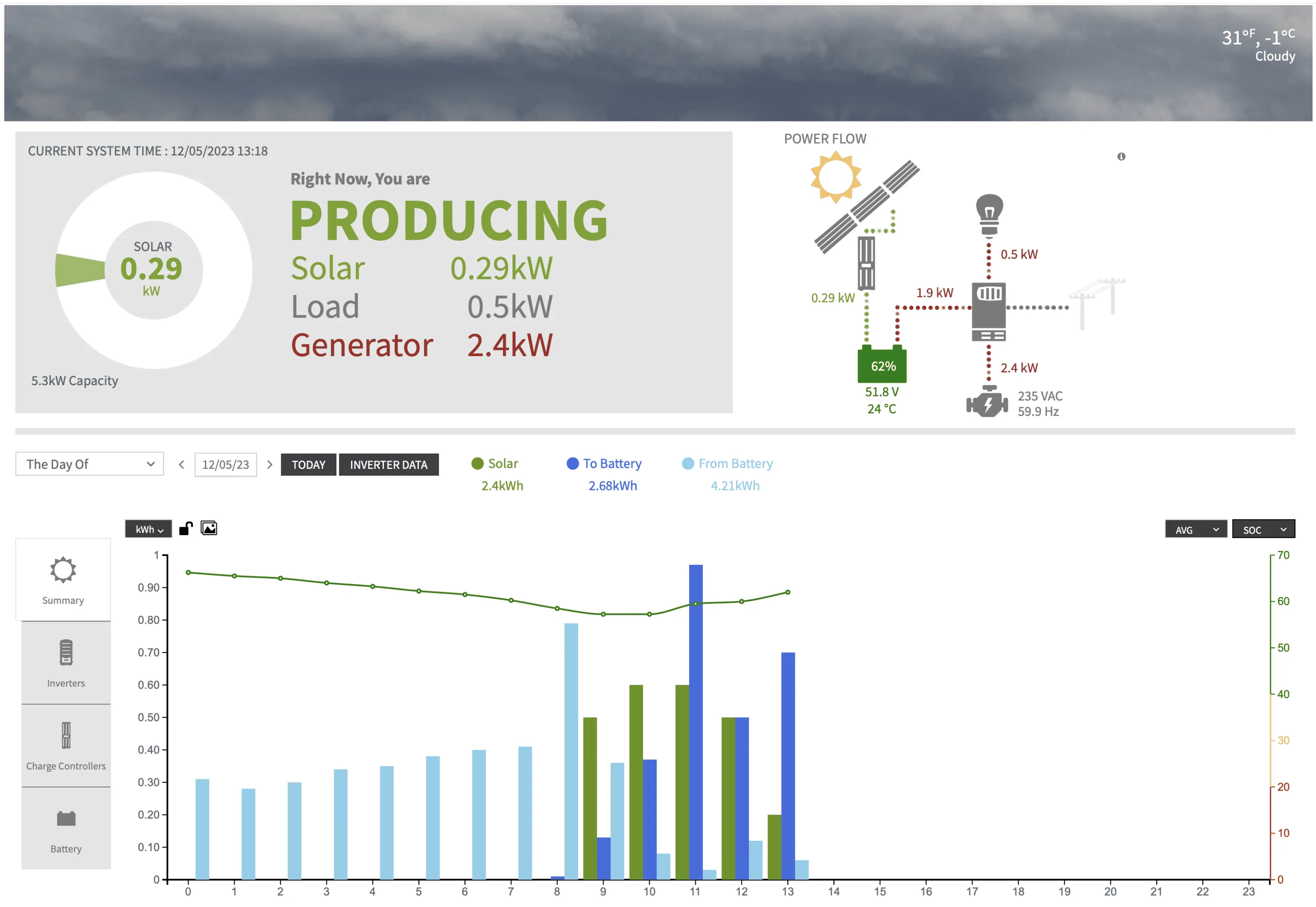

You might notice from the screenshots that the house is only drawing 2.4kw from the truck. This is a limitation of how the Outback inverter connects to the truck and we're talking to Outback about how we can bring that number up. I'm not really concerned though since I don't especially care if I charge the house quickly or slowly. If for some reason I need to pick up the pace I can fall back to my gas genset which can charge at 5kw.
The house battery bank is actually smaller in capacity than the truck battery bank and I have the Pro Power cut off set at 150km (a big cushion for me). My partner has a house in the city where I installed my Ford Pro charger. So on nights when we sleep there I charge the truck off her house and effectively drive the electrons 30km to my house and feed them into my batteries.
