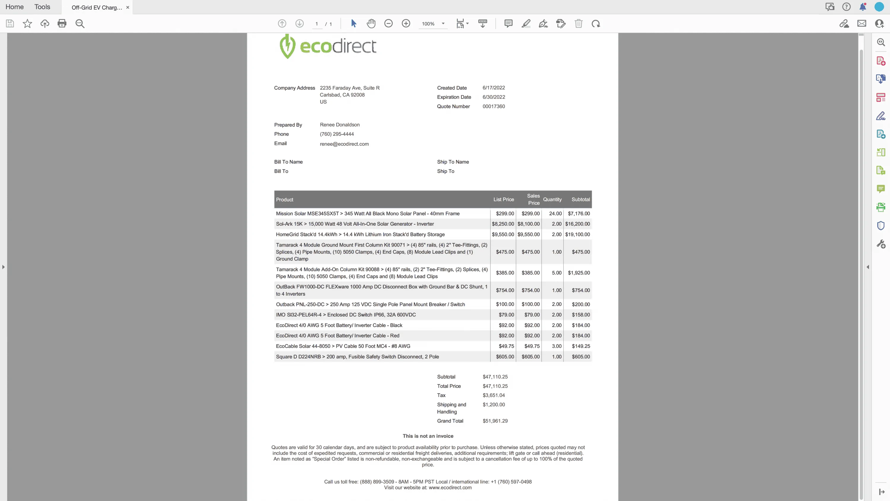

Well, I receive a quote from one vendor for the components for an off grid solar charging system.. Who was it who said too rich for their blood? 50K.. Not in my budget. Attached fyi..
Ford F-150 Lightning Stand alone off grid solar charging, given CA &PG&E Screen Shot 2022-06-21 at 8.37.29 PM
$600 for a Square D disconnect. Wow. Even if it is 200 Amp.

Seems like it should be possible for a lot less. We only need about 1/2 what this guy has done for an off grid charger for his Tesla.
That model disconnect normally sells for $450-500. Probably includes another $50 in fuses. Of course, they have to mark it up some. That’s not out of line.
Schneider’s retail list price is $1200. Of course nobody’s pays list.

Why the 30kW of hybrid inverters and $20k in batteries?
