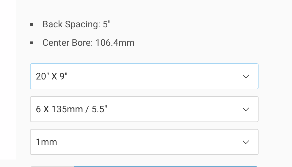

I am ordering some rims for my Lariat 20inch tires.
I believe these will work but hoping someone can verify.
See attached and THANKS!
Ford F-150 Lightning Correct specs for aftermarket wheels? Screen Shot 2022-11-29 at 11.02.40 AM
3,812
6,962
I would personally change the whole wheel instead of just the rim, but that's just me.
Anywhoo, the stock wheel has a +44mm offset. 20x8.5. 6 lug, 135mm bolt circle.
The only information I'm not aware of is the weight rating. With the weight of the Lightning, I don't know if most aftermarket wheels will work, but don't know for sure.
I guess you could use your GVWR as a guide.

You’ll most likely need a front lift for that offset, and please take note that you will be losing at least 20 miles of range, although if you don’t commute it won’t matter.
Mine were 20x9 +20 on Cooper AT3 XLT stock tire specs
Did you need a lift for your +20 offset?
