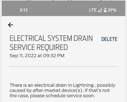

With PPOB being active, the truck is in a running state, therefore the DC/DC inverter to replenish the 12v LVB should operate as needed.
I think the key word here is ‘should’.

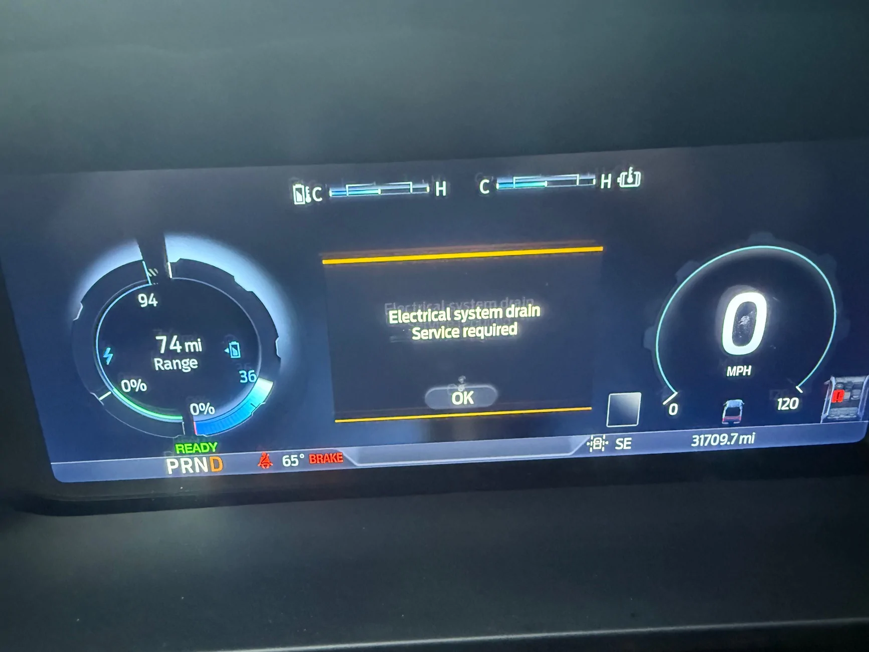

I just spent the last 3hours either driving or setting with my truck running and the moment I pulled back in the garage and shut off the truck I got the dreaded Deep Sleep / you have been disconnected message.
I had periodically over the past several weeks been receiving the - You have a Vampire onboard and if not you should schedule an appointment for service.
( My message interpretation.)
This has become Very disheartening!

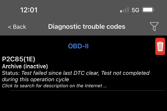

Do you have an OBD2 scanner with the CarScanner app on your smartphone that can look for a trouble code? Hopefully you have a competent dealer that can go farther on this.
