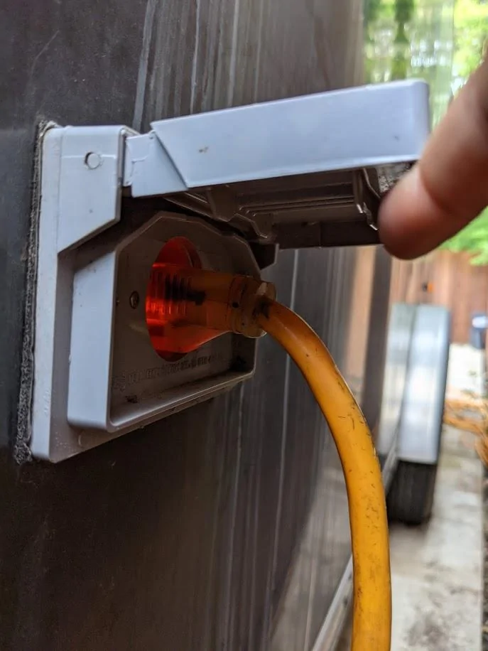

Here is the shore power input to my trailer.
Ford F-150 Lightning Exactly what cord do I need to use the 7.2kw generator?? PXL_20210609_001434182
You are correct, it's a 20 amp plug. In my trailer, I have a dometic 15000 BTU AC, small microwave, Keurig, Edgestar 43Qt fridge and a few small sundry electronics. I power all of that today with my Honda EU7000 and can almost always run the AC and one other appliance concurrently without tripping any breakers. The Honda also powers my motorcycle tire warmers when I am at the track but off of a separate outlet.

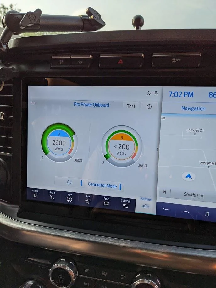

I tested the truck today and with AC on max and microwave, it trips the breaker. OK yes, I can meter my appliances in the trailer to get around the problem, but I would like a setup where I don't have to and can just count on the 7200 watts. Is that not possible? Or do we in essence only have TWO 3600 watt generators??
BTW, here was the draw according to the car when AC and microwave were both going at same time - didn't hit the peak 3600, however it still tripped.

2600W from a 120VAC receptacle is 21.6 A, so that's why it tripped as you're overloading the circuit. You may be able to get 3600W from one leg of the 240VAC receptacle, but I'm not sure how the system would react with an unbalanced load like that.

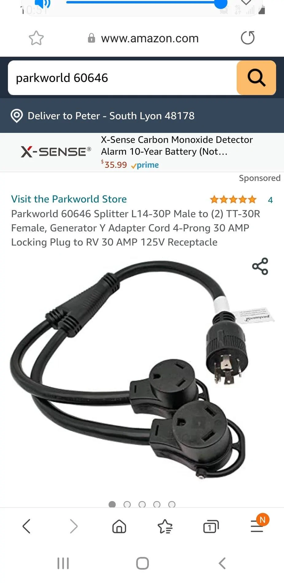

This is the cord I purchased. I just got home from a 3 day music festival in Mi. I powered my camper. It has a 15,000 btu a/c, a small mini fridge, the rv fridge, 3 fans in a tent and sound system for the campsite. My Powerboost ran this continuously from Thursday afternoon to Monday morning on about 5/8 tank of fuel. This is what I bought the truck for and it did not disappoint.

That one appears to no longer be on Amazon. I grabbed a single 30TT dog bone, but then I saws this one In your post. This would be useful when boondocking with others.

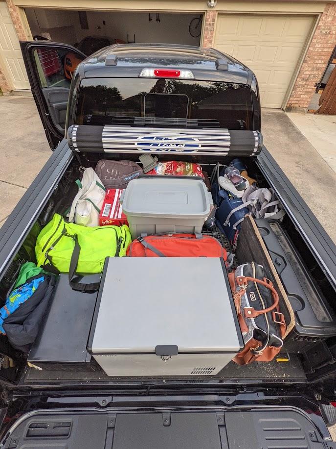

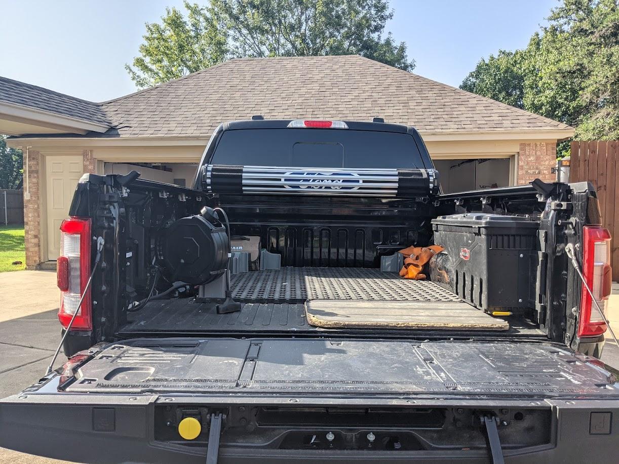

  2. I then use the 120V right below the 240 to power my tire warmers. I use this cord reel mounted to the truck for quick extension and stowaway. The 240 and 120 right below it seem to be on the opposite banks and so I don't have any issues tripping breakers.
    Ford F-150 Lightning Exactly what cord do I need to use the 7.2kw generator?? 20210725_101334-COLLAGE
Ford F-150 Lightning Exactly what cord do I need to use the 7.2kw generator?? PXL_20210725_144123433

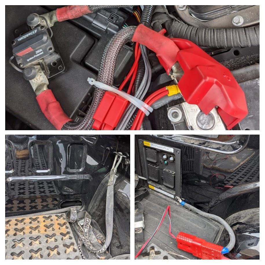

Oh, I also have an Edgestar compressor fridge wired direct to battery under the hood and grounded at the power outlets with anderson connectors.
