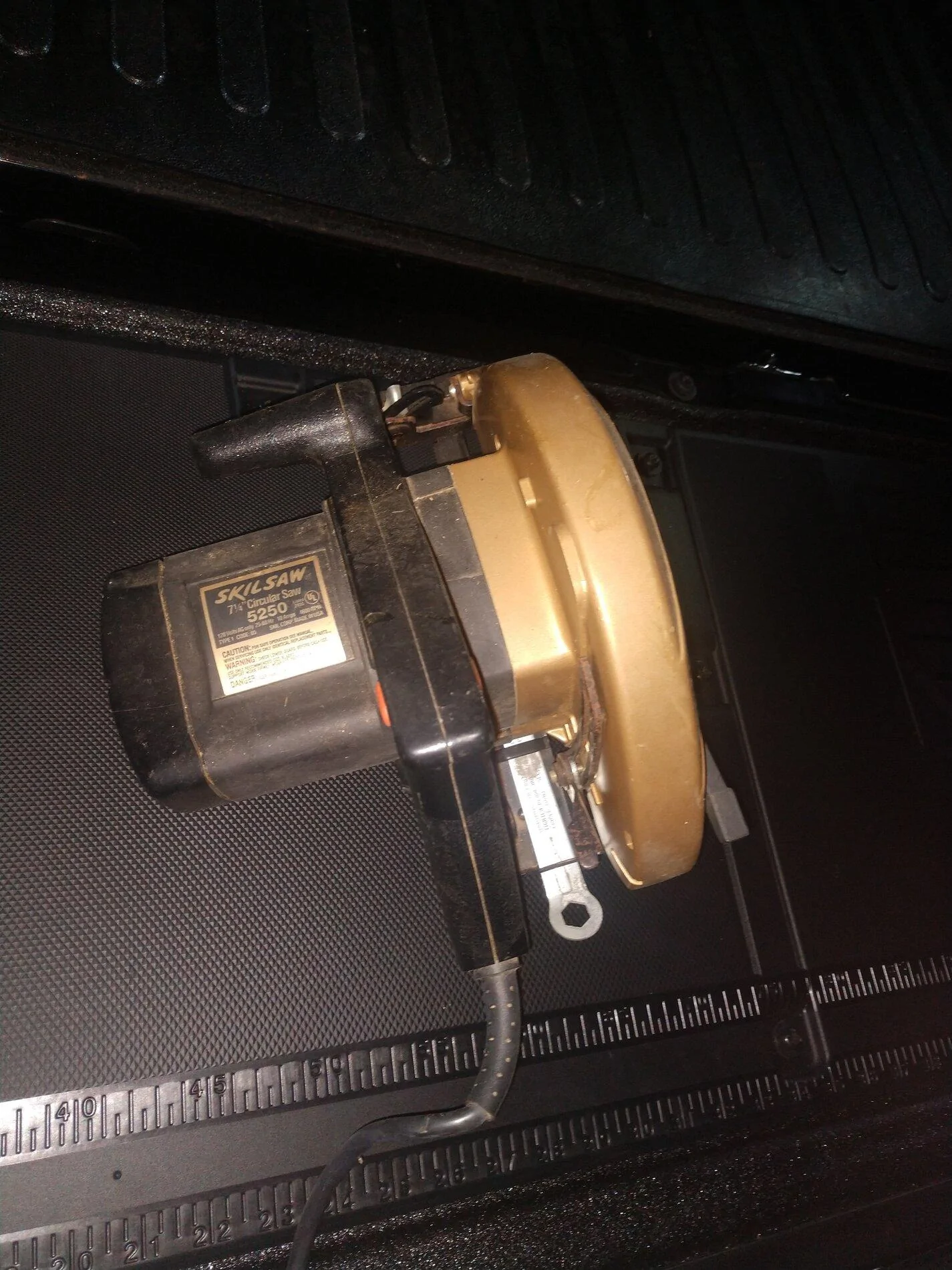

7.2KW generator not able to handle a circular saw
Twilighthan
Twilight
Apr 14, 2021
39
Austin
F150
Did you try changing the settings on the unit? The ramp time, current curve, etc are all programmable. Maybe ramp it by 1 second instead of 2? Mine has been working flawlessly.
Ok. I am an idiot. I didn't know you can program it, but I got it right before I had to leave town, so I only had a few minutes with it. When I get back, I'll look at it. Thank you so much for the followup. Ever grateful!
