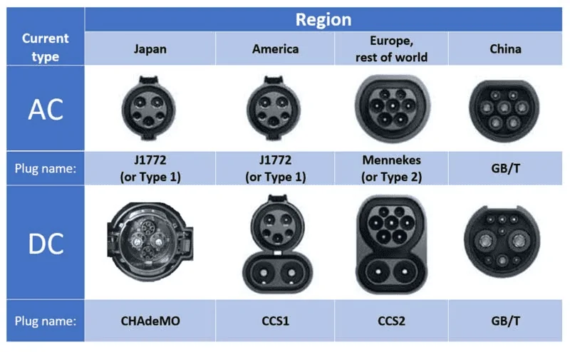

Ford F-150 Lightning F-150 Lightning's Charge Station Pro : Vehicle-to-Grid Charger 1636812862094
CCS1 is simply J1772 with two DC pins added below.
Sklith
Nov 10, 2021
196
163
Georgia
Model 3 Performance, Energica Ego
Taiwan and Korea also use CCS1.

So the Lighting has a CCS Type 1 socket most pictures show the lower DC pins flap cover closed and Ian on the Ford Lightning tour confirmed the 80A charger uses the CCS Type 1 plug. Now the 30A portable charger that comes with the truck is most likely a J1772 and could be the source of confusion for unenlightened dealers.
