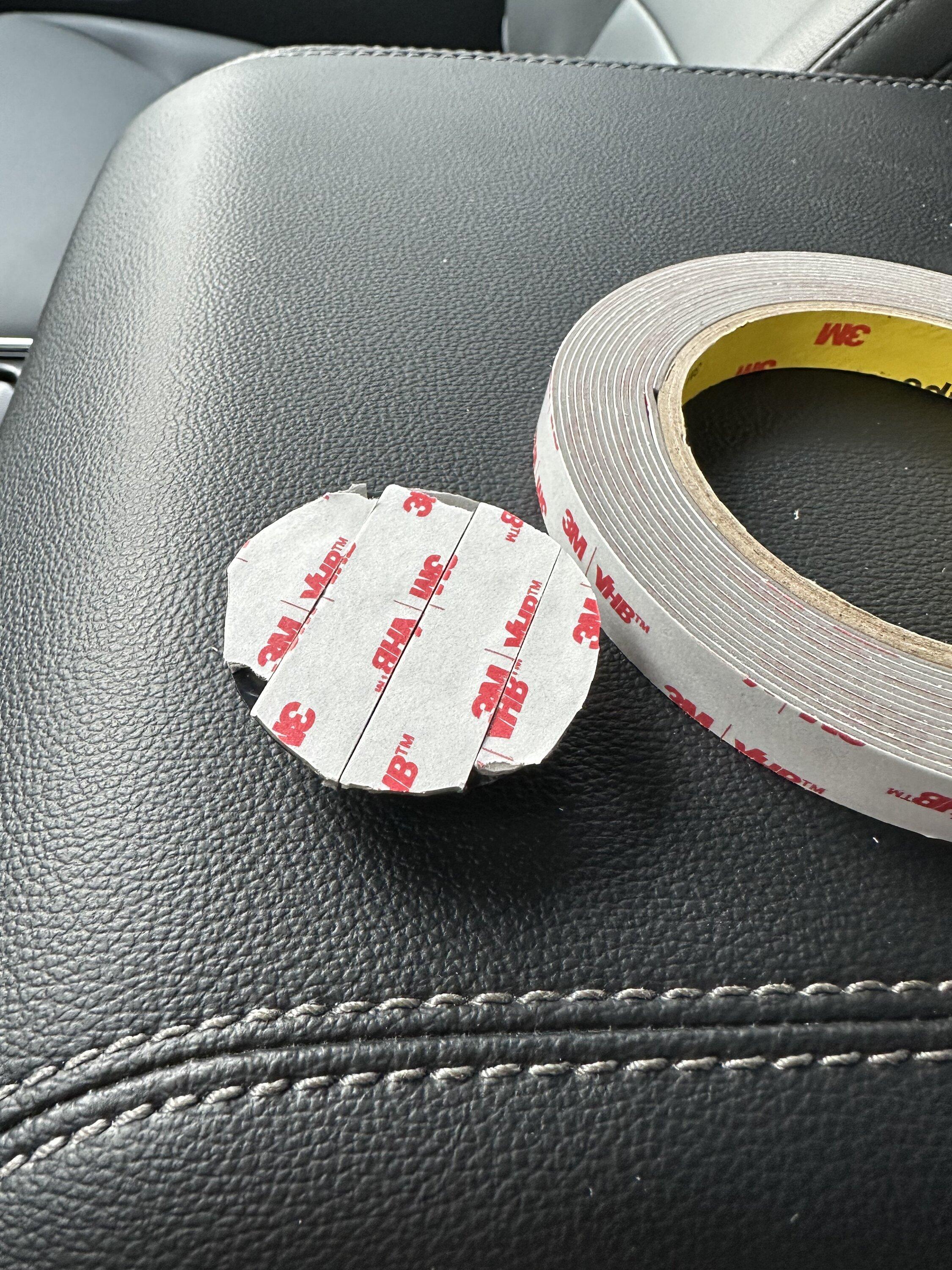

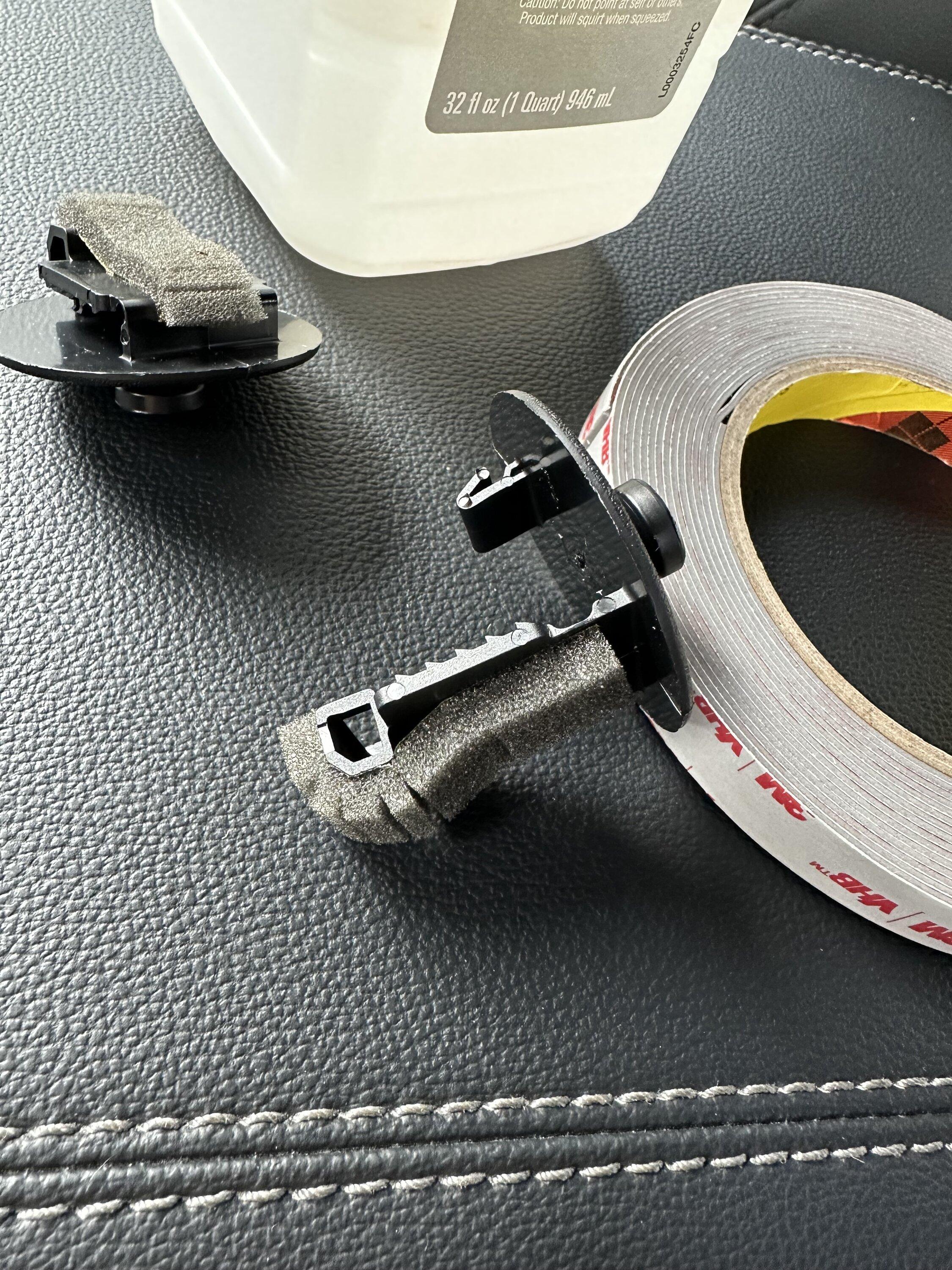

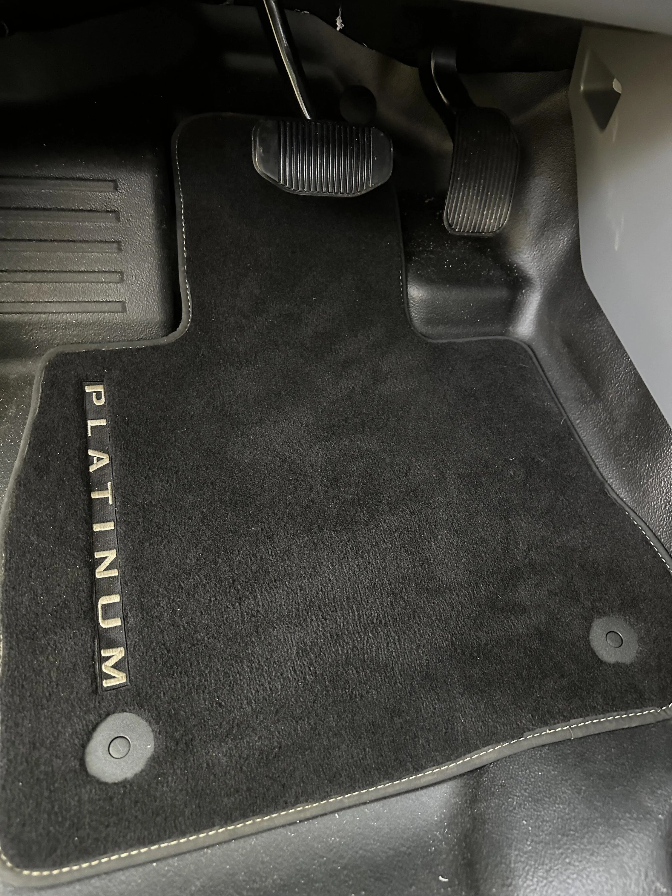

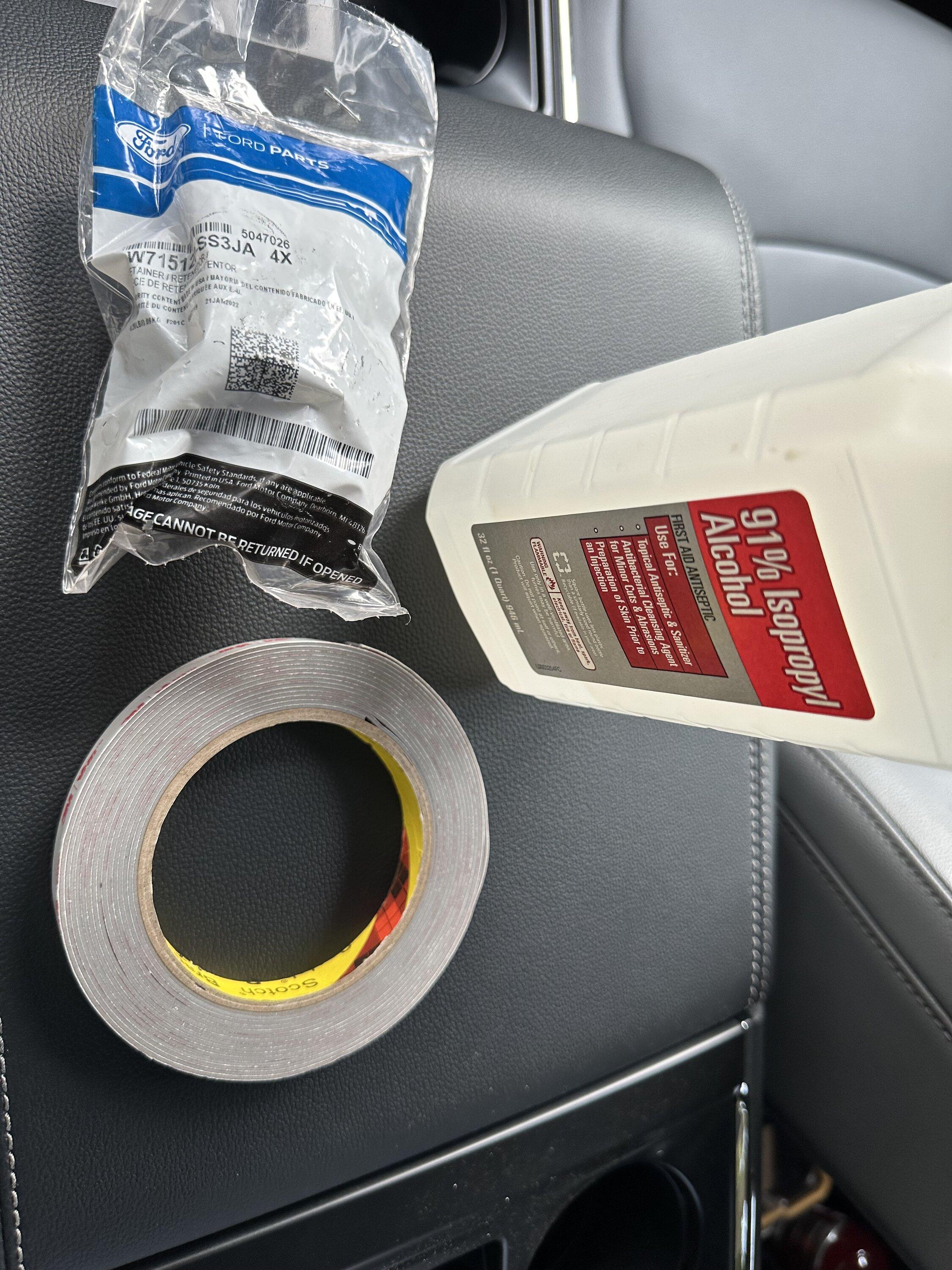

So, my base model Pro came with a vinyl floor and regular Ford floor mats wouldn't fit. The truck is not equipped with the retainer posts that snap into OEM mats. Ford sells the factory retainer clip, the part number is W715120-SSA. However, the installation requires that you cut 2 slots in the floor liner to feed the clip portion through. I wasn't enthusiastic about cutting holes in the vinyl, and came up with a Plan B.

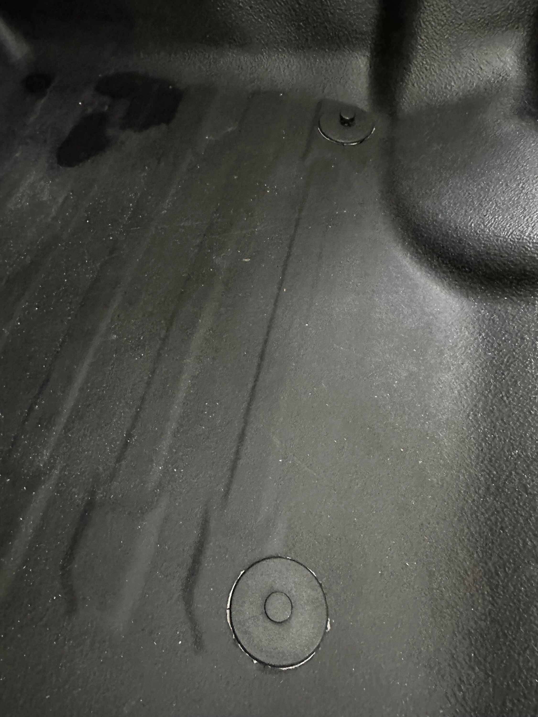

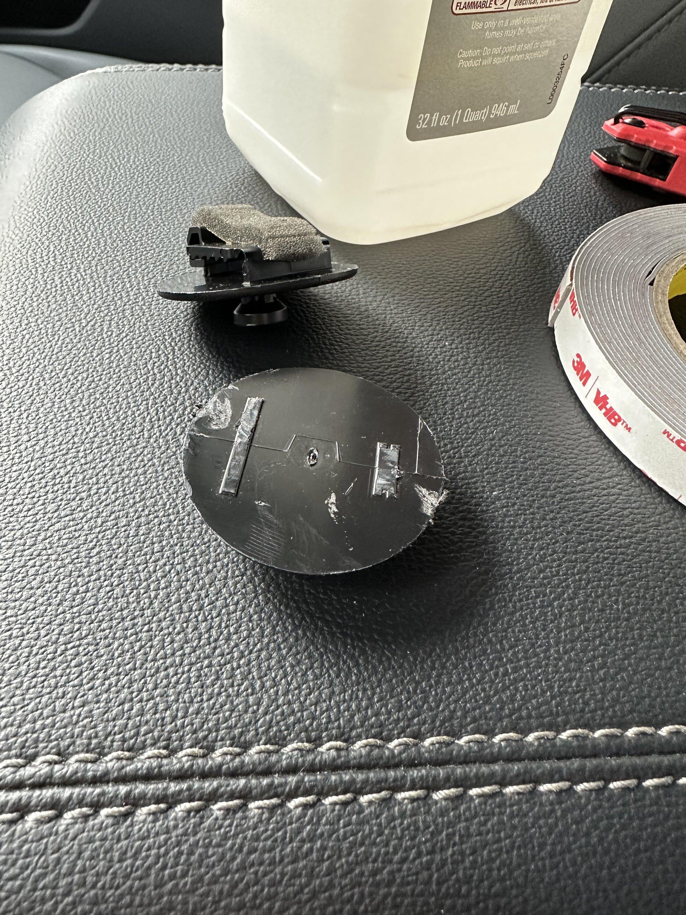

Instead I trimmed the clips off the mat retainers with an oscillating saw, and used some 3M VHB (very heavy bond) mounting tape specifically designed for vinyl adhesion to stick the posts down. It turns out that surface prep is essential, time will tell how the adhesive holds up.
