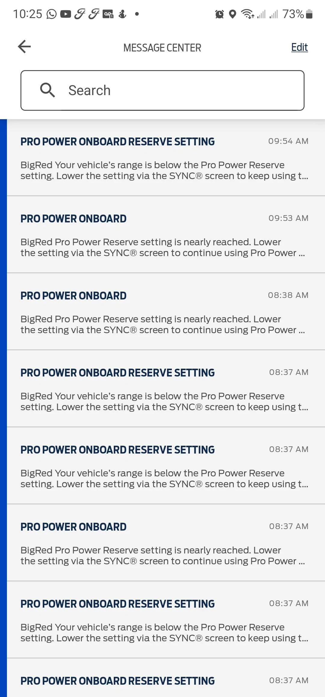

It seems when your battery gets low fordsync will spam you about power on board even though I don't have it turned on. Anyway to address this?

I get that on the big screen when I shutdown with less than something like 50% HVB remaining. I get asked if I want to change the settings or something to allow ProPower to still be available even though my battery is low. I just close the message and don't change anything.
Haven't seen the ones in FordPass yet...that's interesting...wonder why I'm not getting those as well?

I am being spammed even at 100% by the FordPass app.

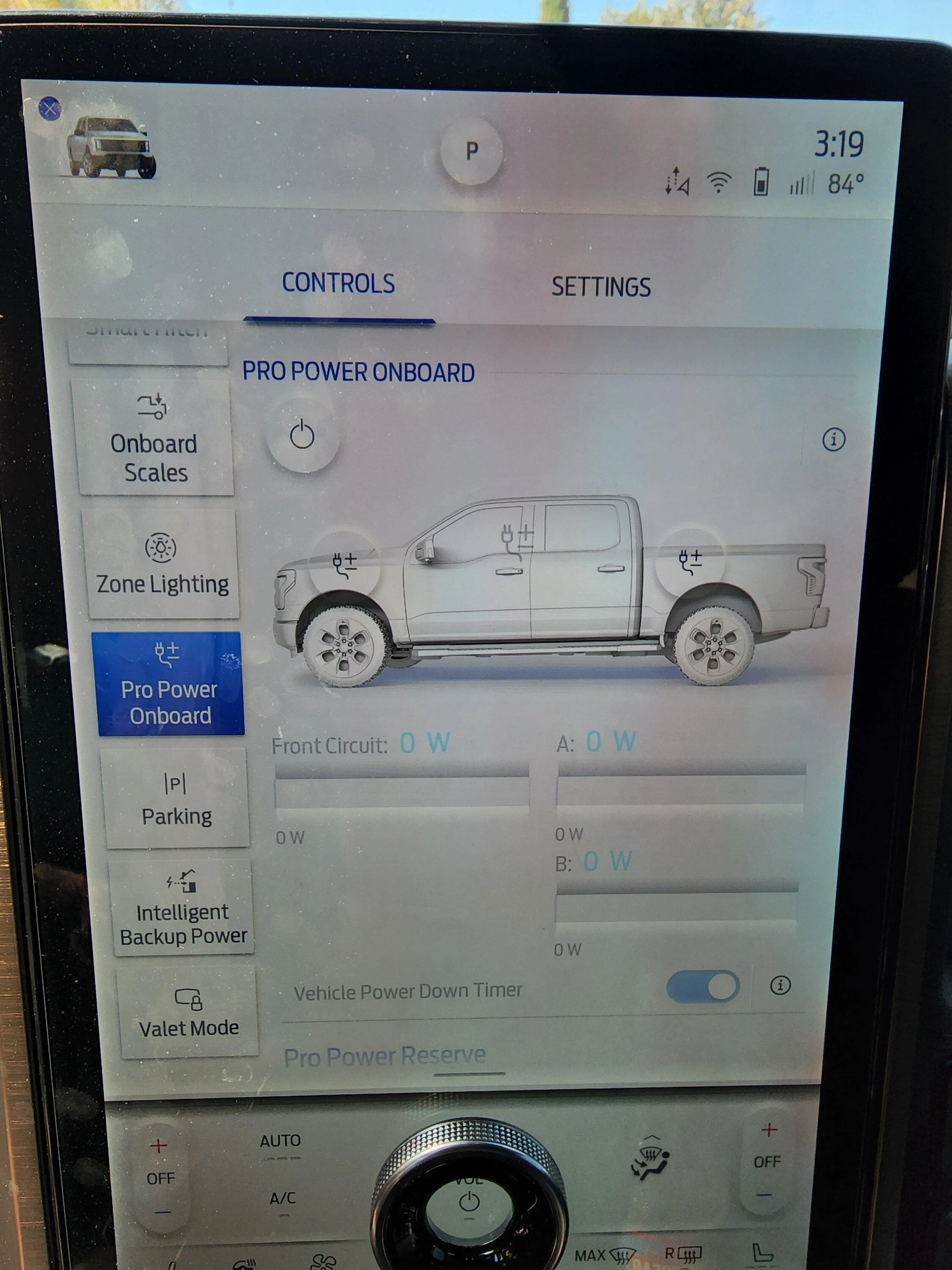

I was able to find the solution. The catch is you can enable Pro Power Onboard, even if all the sockets themselves are disabled. Just turn off the master switch to resolve the issue.

The problem persists. Something keeps turning on Pro Power Onboard in the cabin. I think it might be triggered by charging phones via USB. If I turn it off manually it will turn on again eventually.
I noticed the same thing. Pro Power turns itself on. I haven't used USB charging so I don't think that's it.
