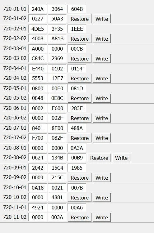

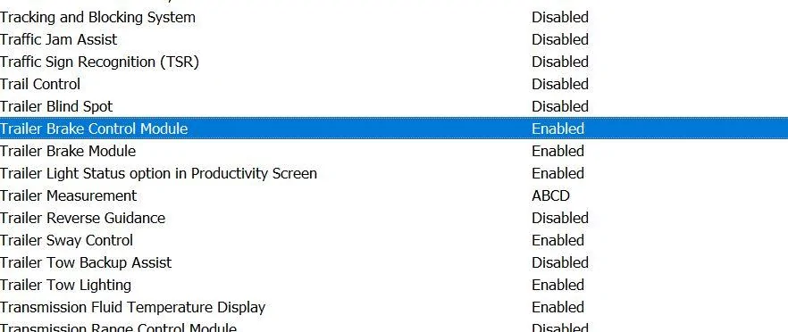

I guess that would help lol.. Im going to assume its in the TRM programming but I couldnt find values for it.

Check out adding IPC module line 720-05-02 along with your previous change above. I think the old ‘20 required two lines, one enabled the tbc and one enabled the “gain function”.
I am unsure of what “transmission state” is, so I would keep that the same as you have now (i.e. select the value that will enable TB and keep your TS as 1 or 2 or whatever it is now).
edit: also in the APIM module is the line below, that may give more TB options on the center screen. I’ll look at mine tomorrow and see what’s there.
7D0-09-03
