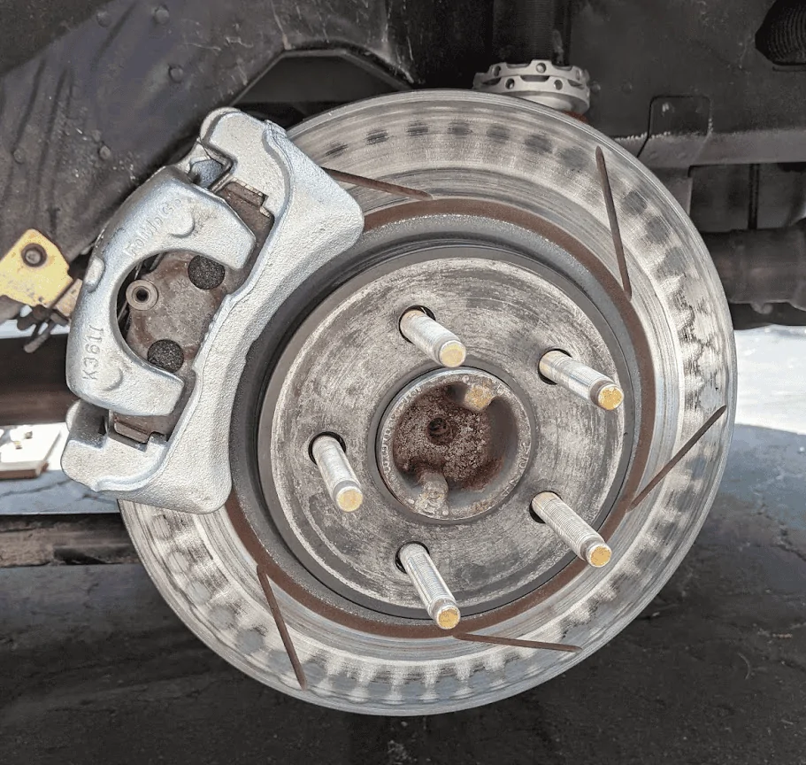

Not sure what to make of that exactly. I'm no expert.
Does look like pad is breaking up up a bit at the slot there compared to mine though?
Like somethings not quite right.
Yeh If it were me I'd like to get pic of all 4 pads and Root faces then see what mechanic says to confirm any suspicions.
If I were you I'd get a pic of each pad from ground looking up and a pic of both sides of rotor. If a caliper is sticking sometimes you can see the one rotor face is worn down more than others or grooved a bit more.
But likechrisp993 with the badass pony avatar above said you should feel something like vibration or pull etc. Should ask him in how few weekends he can burn down a set of Hawk pads.

Topshelf, not enough light on your first pics, try flash (may overwhelm photo though), or have someone shine a flashlight right in the dark part where the pad is, while you take pic.
The last pic in your follow up post of the front outside pad definitely is more than 4mm. So either he's talking about inside pad (but both sides should wear the same, as the calipers are "floating"), or he's talking about the other front wheel.
BTW, not sure what he was implying but 8mm on rear is fine. Most pads new are between 8 and 12mm.
So all you really need to understand is what is the real story on your front (both sides). Your Ford Service guy owes you a better explanation and let you see the problem. Absolutely no way should be down to 4mm at 6k miles. Unless some drives your truck with both feet (i.e. left foot on brake pedal the whole time).
Plus it's not easy to warp a truck rotor. You would have to massively overheat it with continuous braking load for a long time. Unless it was a factory defect.
