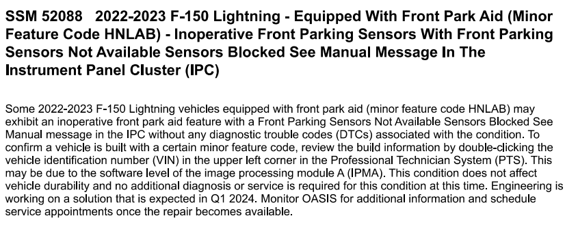

Heads up. Problem fixed on my end. Ford Store San Leandro here in Cali applied the following:
https://www.f150lightningforum.com/...tning-equipped-with-front-park-aid-pdf.81249/
in addition several other patches. The blocked sensor issue is gone. The truck has not had any OTA updates in over a year. Not sure why. They had to keep the truck over night as the sw updates could not be interrupted (manual updates).

I've had this problem since I purchased on 6 April. I found SSM 52161, which I believe is an update of SSM 52088 (if not, does anyone know the difference).
When I took it to my dealer and asked that they follow the SSM, they told me first that the problem didn't happen (they just didn't notice when they pulled it into the shop), and then told me that the SSM didn't apply and the Ford told them they needed to do a complete front-end tear down to further evaluate. Oh, and they won't cover a rental while it's in the shop at least a week for the tear down.
Suffice it to say, I brought the truck home and am hoping to get the OTA updates sooner rather than later in the hope that will resolve the issue.
