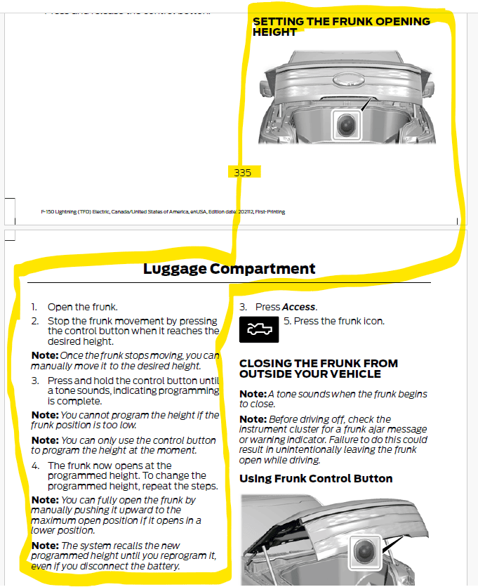

Try recalibrating the opening height

Pop the frunk and then manually push it all the way open. Then press and hold the close button, keep holding until it beeps.
This is a feature so you can prevent the frunk from opening to high and hitting something. For example if you have a low ceiling garage.
