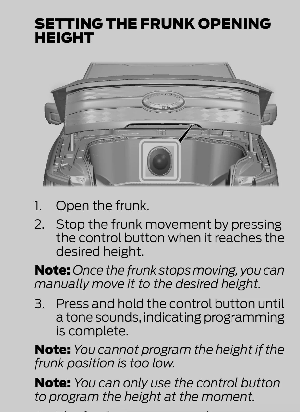

Page 349 in the manual.
Ford F-150 Lightning Frunk open limit? IMG_0216

p336 in 2022 manual
"1. Open the frunk.
2. Stop the frunk movement by pressing
the control button when it reaches the
desired height.
Note: Once the frunk stops moving, you can
manually move it to the desired height.
3. Press and hold the control button until
a tone sounds, indicating programming
is complete.
Note: You cannot program the height if the
frunk position is too low.
Note: You can only use the control button
to program the height at the moment.
4. The frunk now opens at the
programmed height. To change the
programmed height, repeat the steps.
Note: You can fully open the frunk by
manually pushing it upward to the
maximum open position if it opens in a
lower position.
Note: The system recalls the new
programmed height until you reprogram it,
even if you disconnect the battery."
