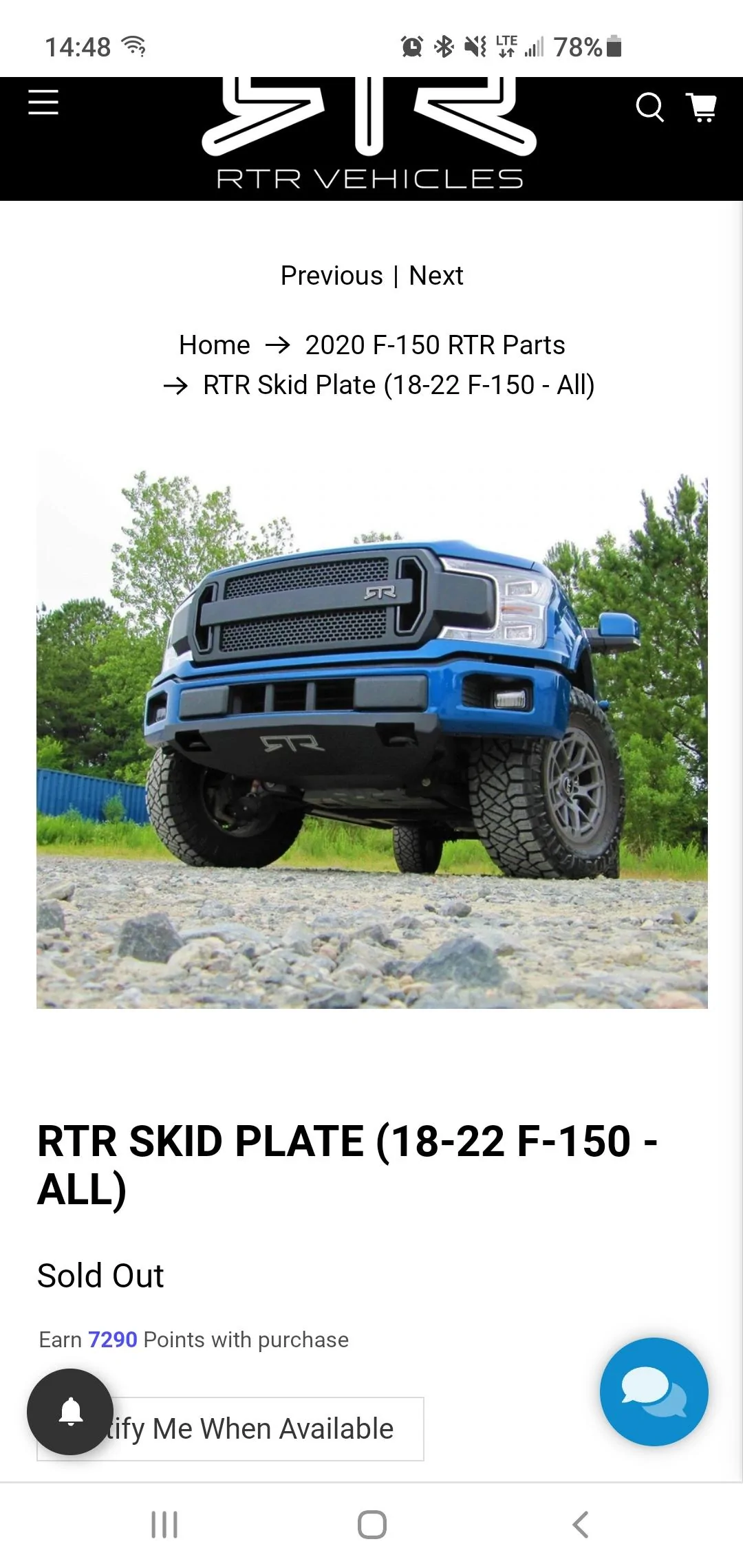

which rtr skid plate did you order and where from. Been looking at them for when I remove the air dam this spring...
Derek83
Derek
Dec 18, 2020
74
Ontario
2011 Mustang GT, 2021 F150 SCREW Lariat
Ordered the Black skid plate that they keep running out of. I was emailing them directly, ultimately i ordered through American Trucks for two reasons. When in stock, first of February it will ship vs waiting for RTR to open up purchase option. Secondly it was a better deal for me to order with AT to get the part delivered across the Border. There are few photos of the plate on 21s+ so ill grab some photos once i install and post it in here.

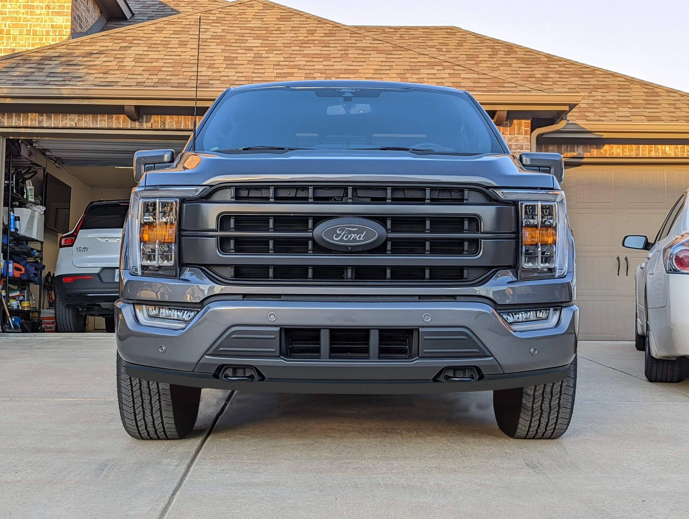

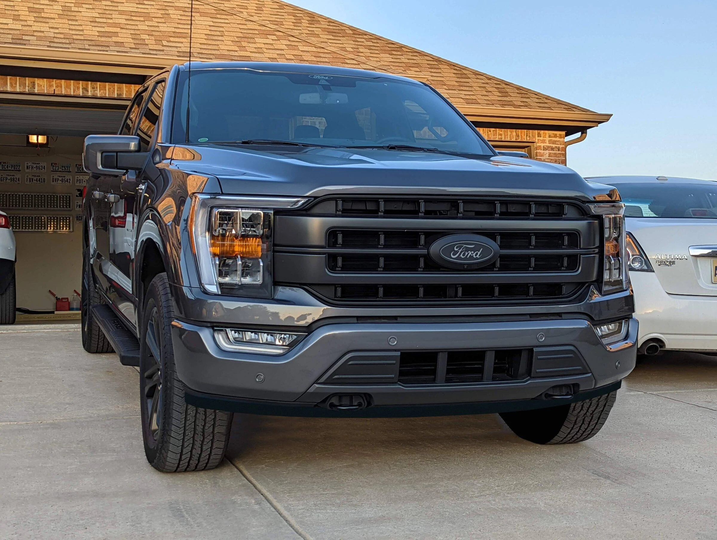

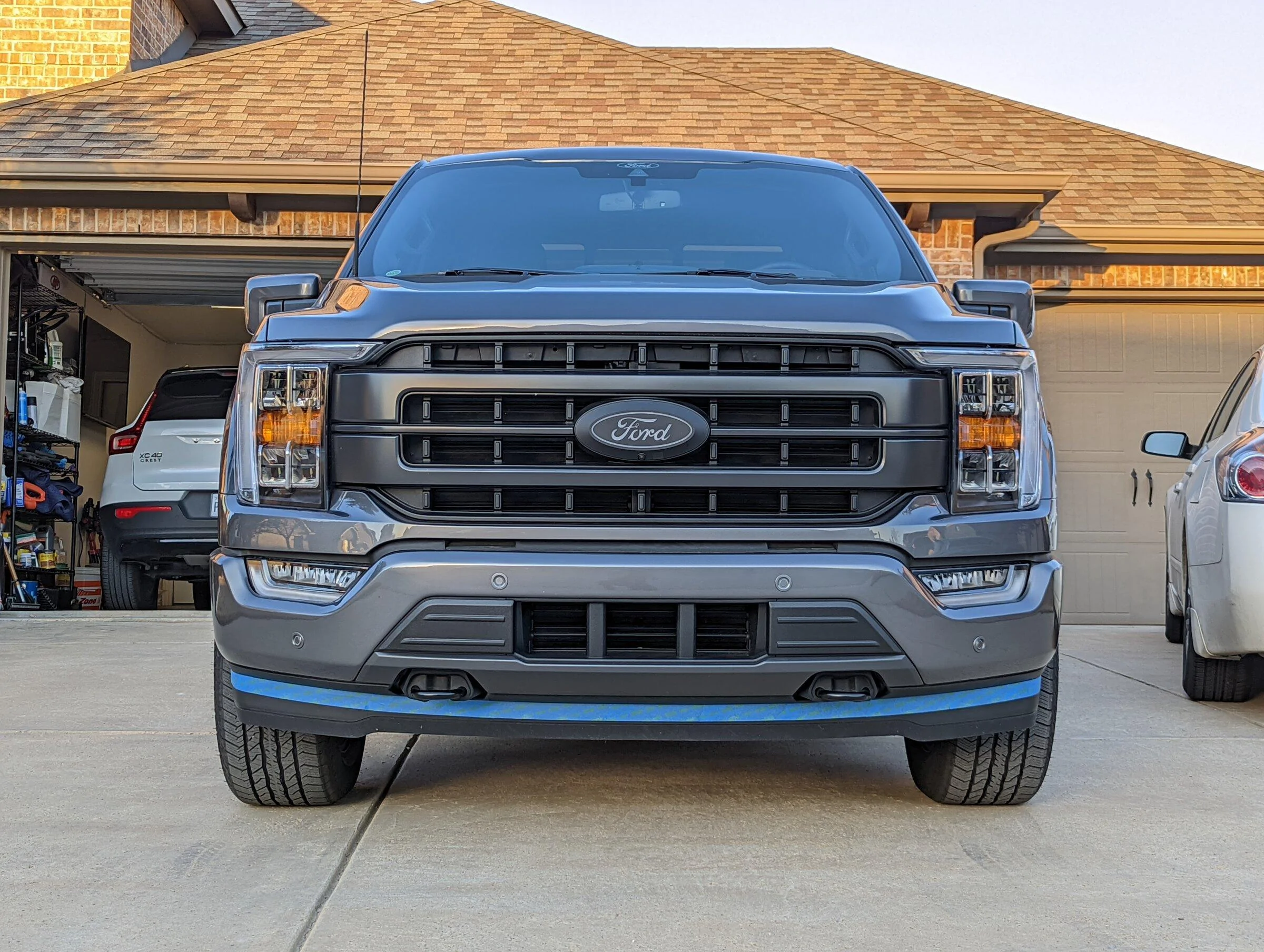

We meet again. New truck, new air dam...
I'm going to take a slightly different approach this time. Learned from trimming other airdams, I'm going to retain about a 1.5" lip underneath using tape as a guide.
Now I HAVENT TRIMMED IT YET, but I've marked it off and photoshopped what it will look like here:
Before:
Ford F-150 Lightning Removed Active Air Dam From my F-150 - DIY Writeup PXL_20220211_220756088
The guide:
Ford F-150 Lightning Removed Active Air Dam From my F-150 - DIY Writeup PXL_20220211_234534614
Ford F-150 Lightning Removed Active Air Dam From my F-150 - DIY Writeup PXL_20220211_234541212
Ford F-150 Lightning Removed Active Air Dam From my F-150 - DIY Writeup PXL_20220211_234549309
Photoshopped using the guide:
Ford F-150 Lightning Removed Active Air Dam From my F-150 - DIY Writeup F
Ford F-150 Lightning Removed Active Air Dam From my F-150 - DIY Writeup B
Ford F-150 Lightning Removed Active Air Dam From my F-150 - DIY Writeup D
The idea here is to retain some strength to the lower part as well as provide some side lip to keep if I put a bash plate over the center.

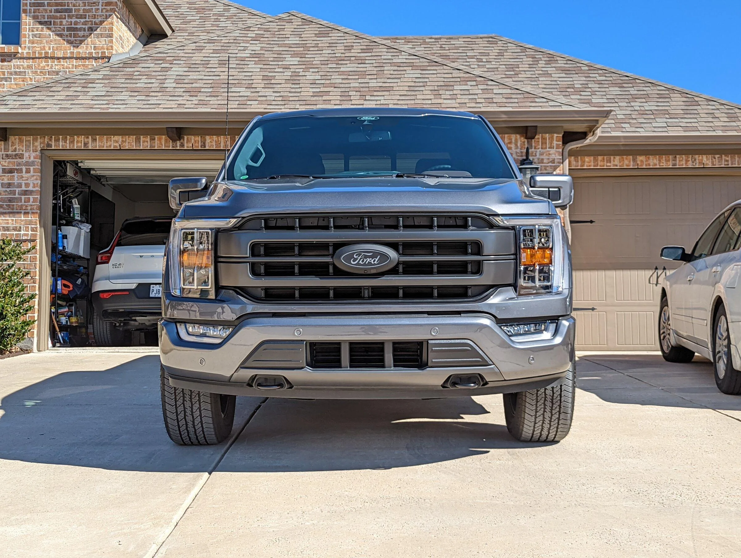

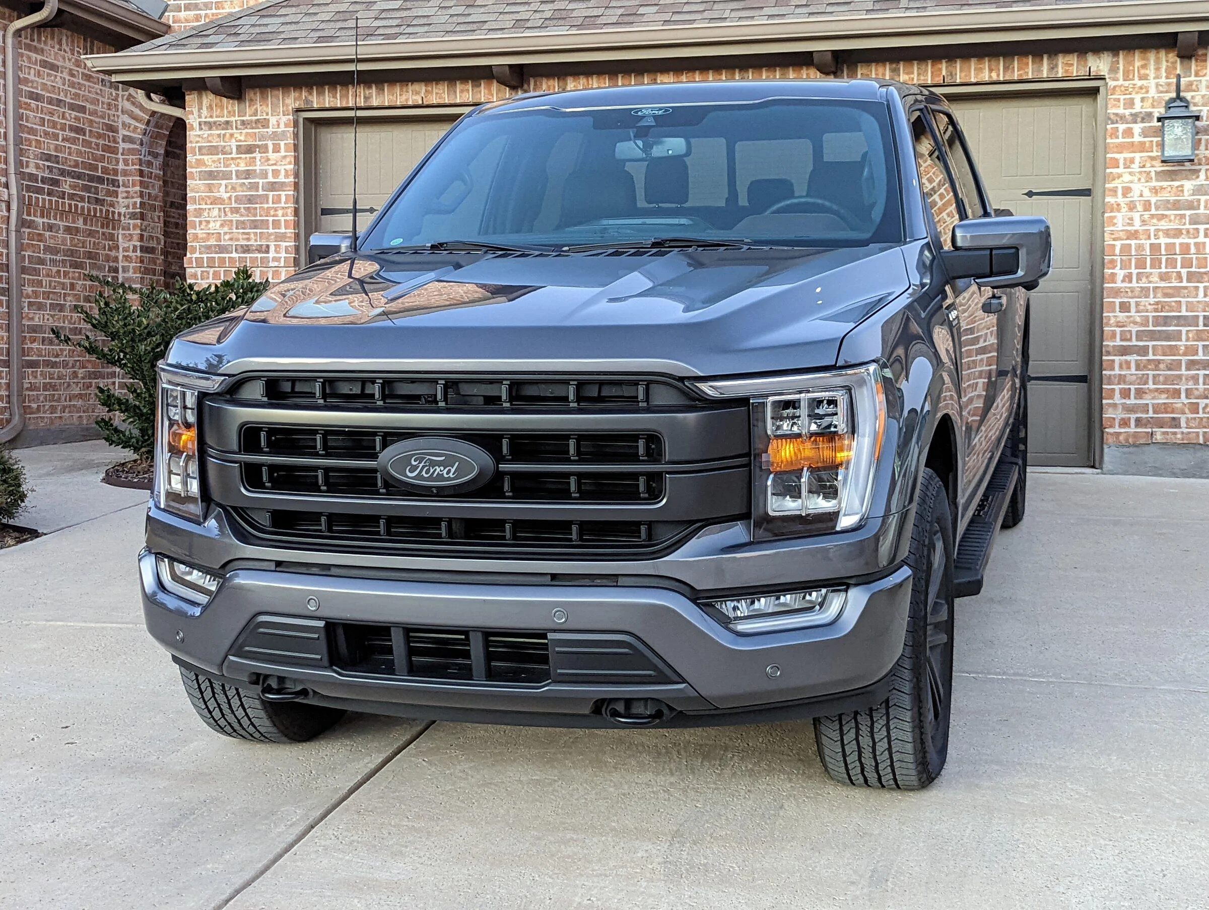

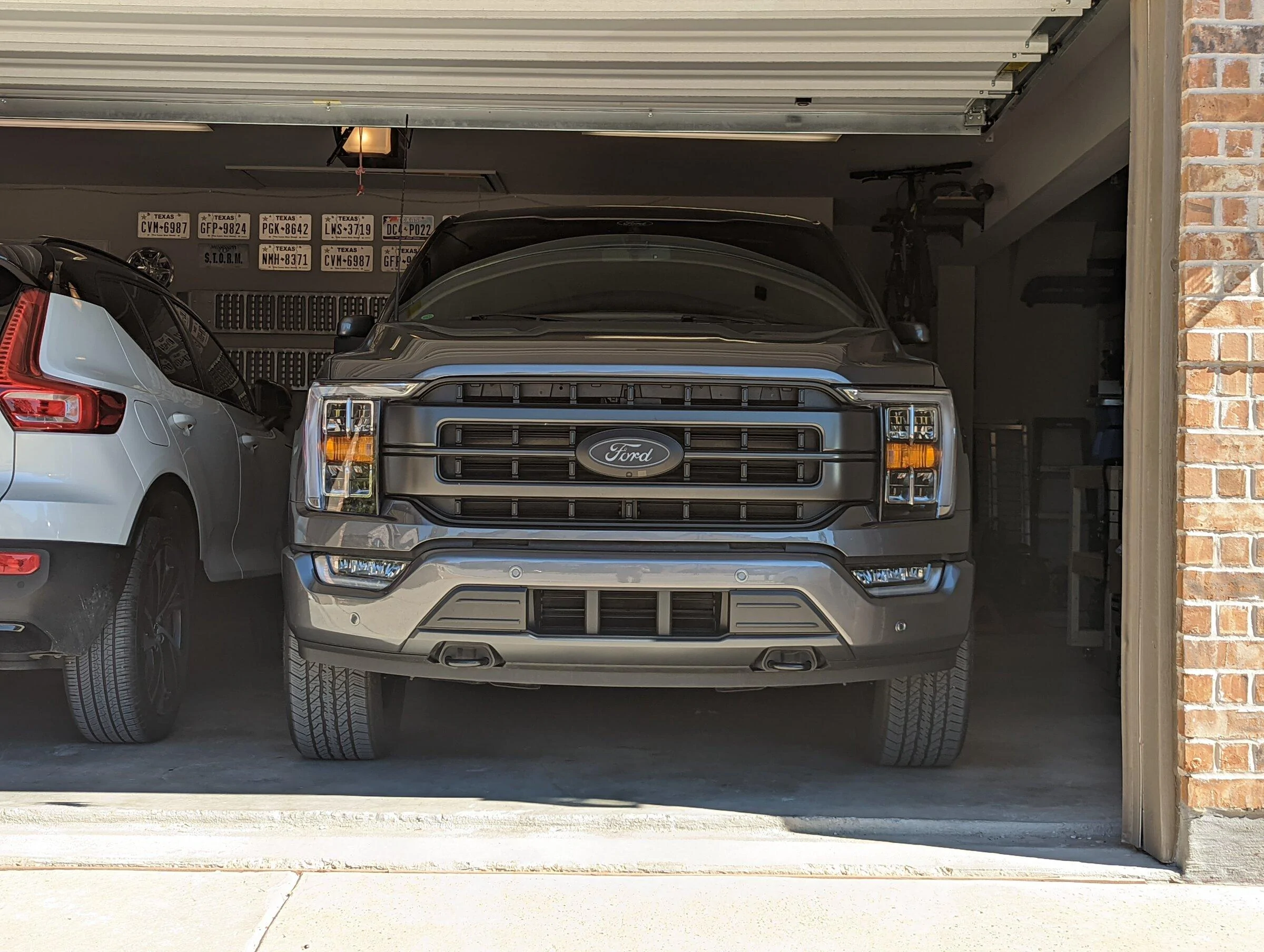

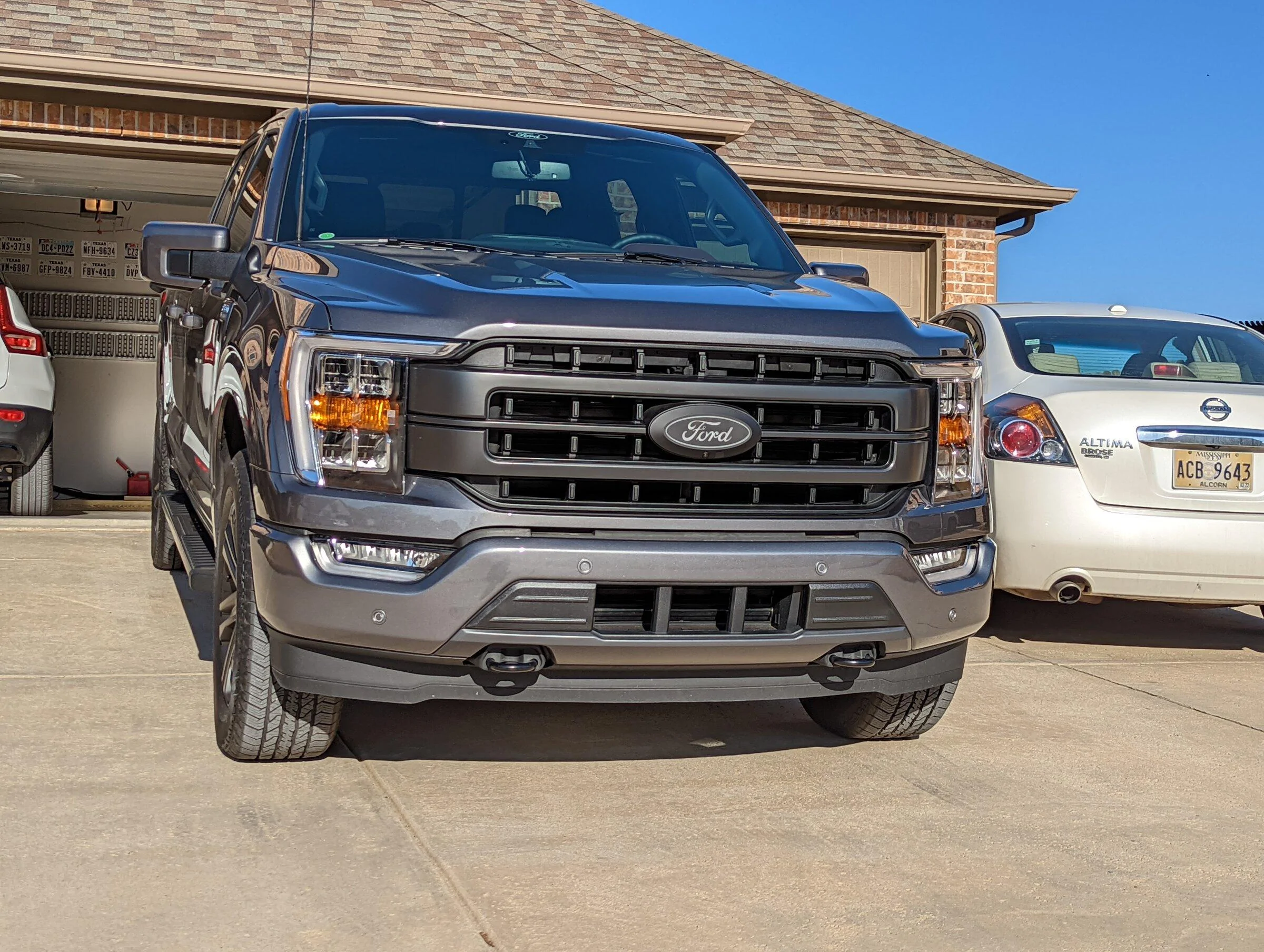

So. Marked with tape. Cut below the line with a jigsaw using a wood finish blade, then I sanded up to the tape line using a random orbital sander and 80 grit. Then finished off the edges with 220 grit and hand rounded the corners with a 220 block.
I'll try to get some better pics tomorrow. But overall I like this better. It leaves strength in the plastic under the tow hooks and has just the slightest deflection left to assist with road noise underneath.

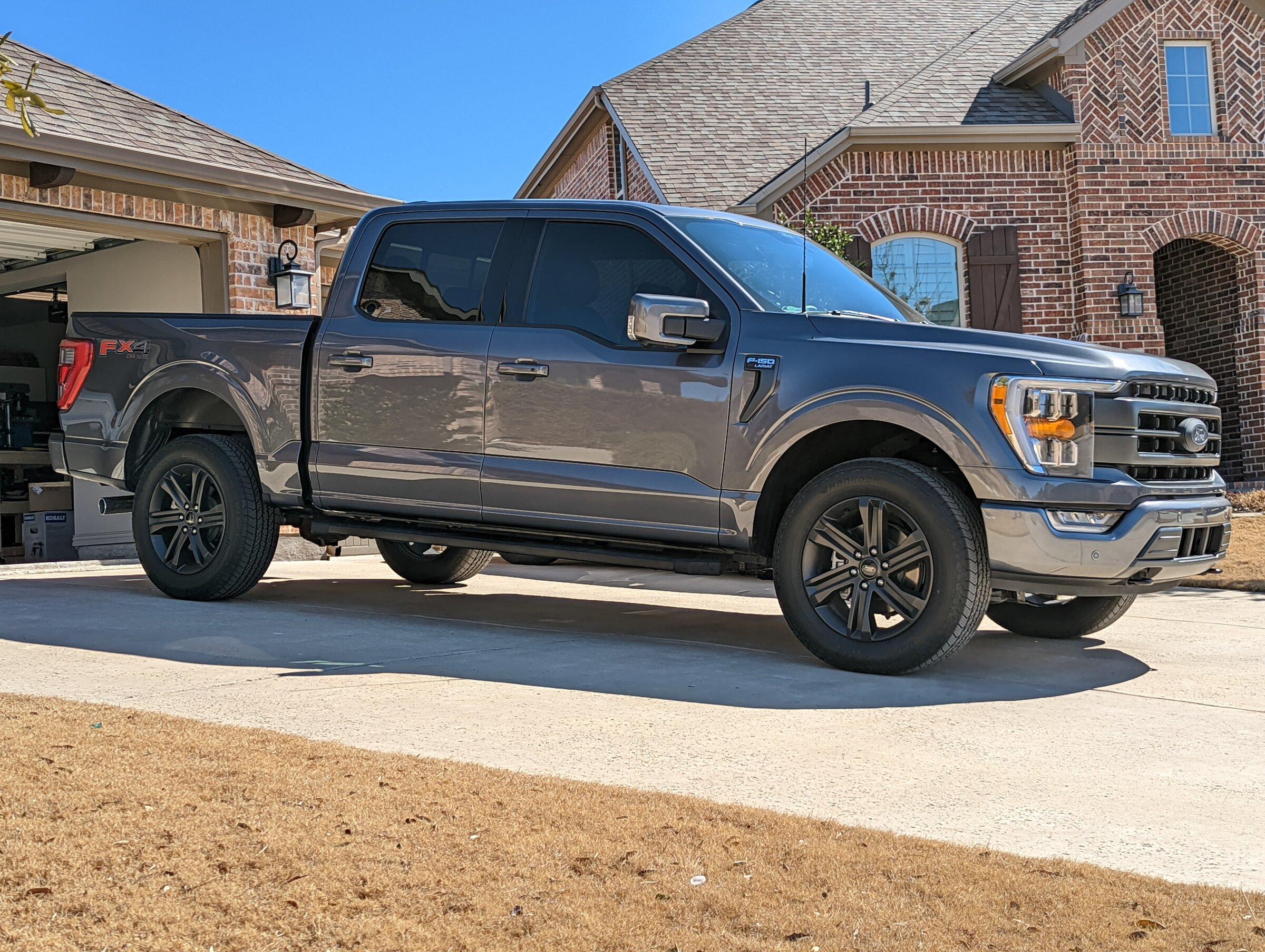

Just went on a little evening road trip and spent about 80 miles on the highway averaging about 73mph and about 21mpg (everything is still breaking in with only 500mi on the truck) -- but the important thing. No new wind noise that I nor my wife could discern -- and no buffeting. So other than what I will assume is a slight decrease in fuel economy at highway speed, it's pretty much perfect. I think the scotch tape guide leaves just the perfect amount of deflection.
And no -- no check engine lights. This is now the second truck I've done this to. I believe it does trigger a silent fault with one of the computers -- but nothing that limits/disables any functionality or triggers any lights. Nothing a code-scanner would return, you would need Forscan or better to see it.

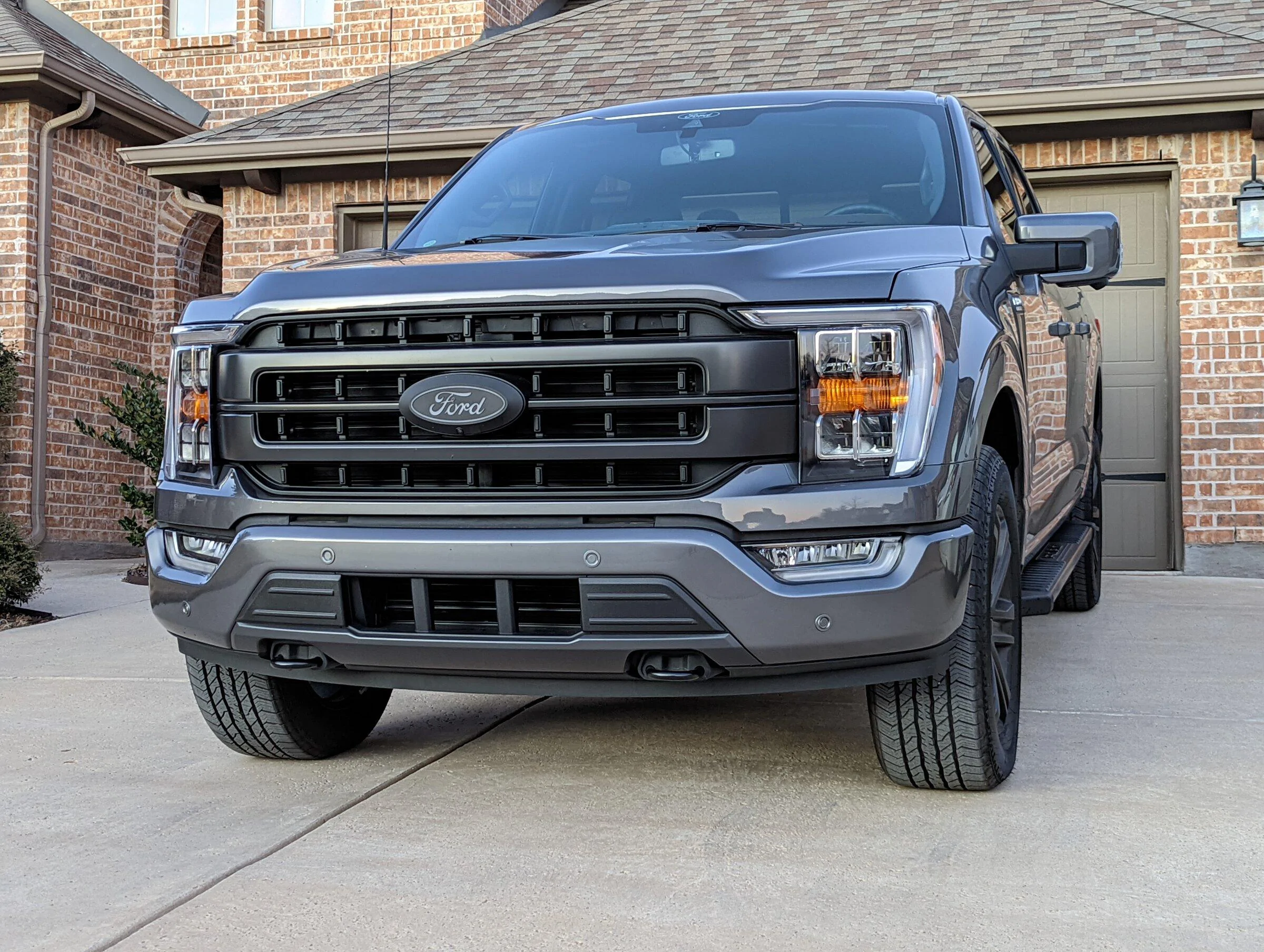

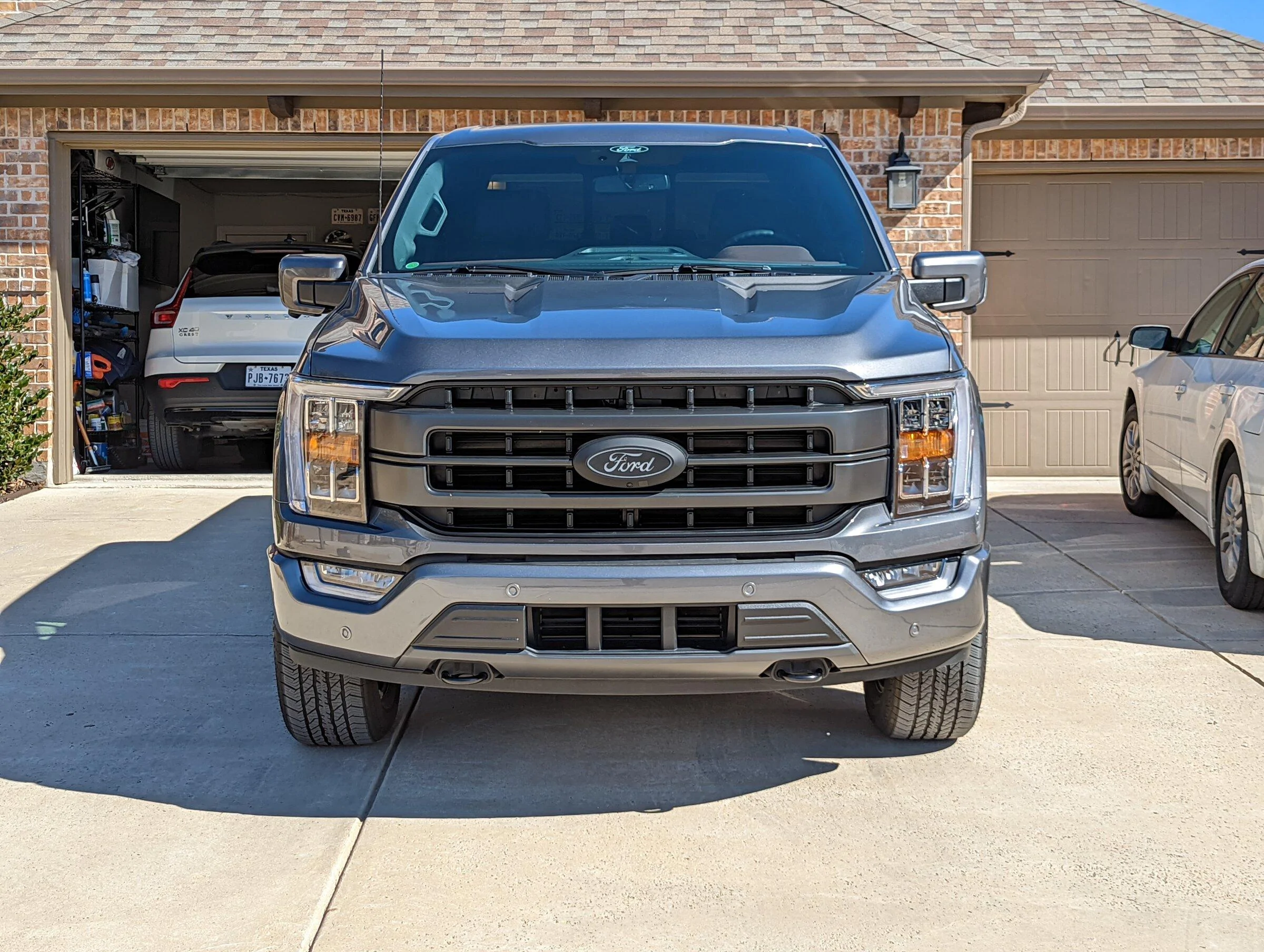

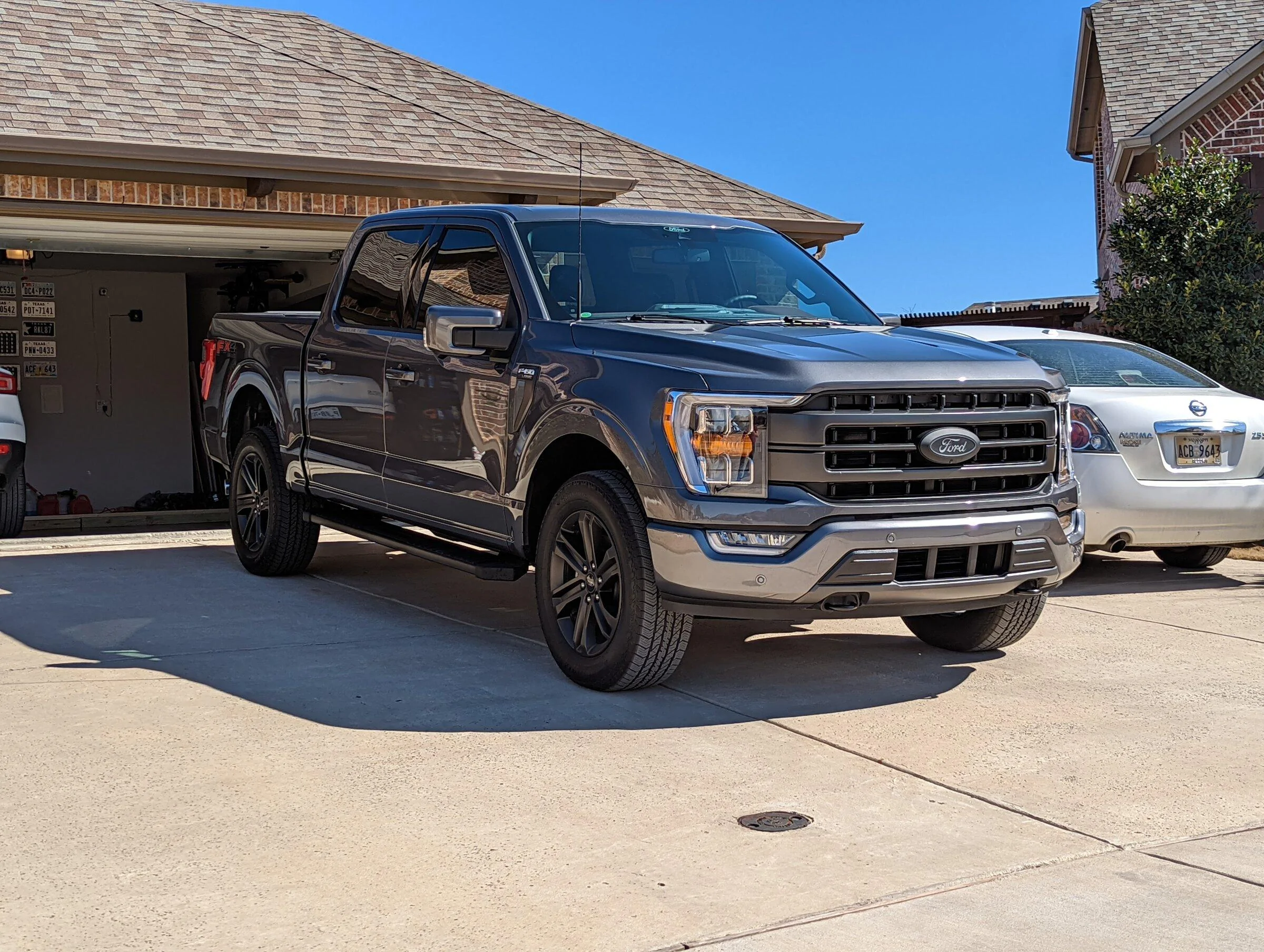

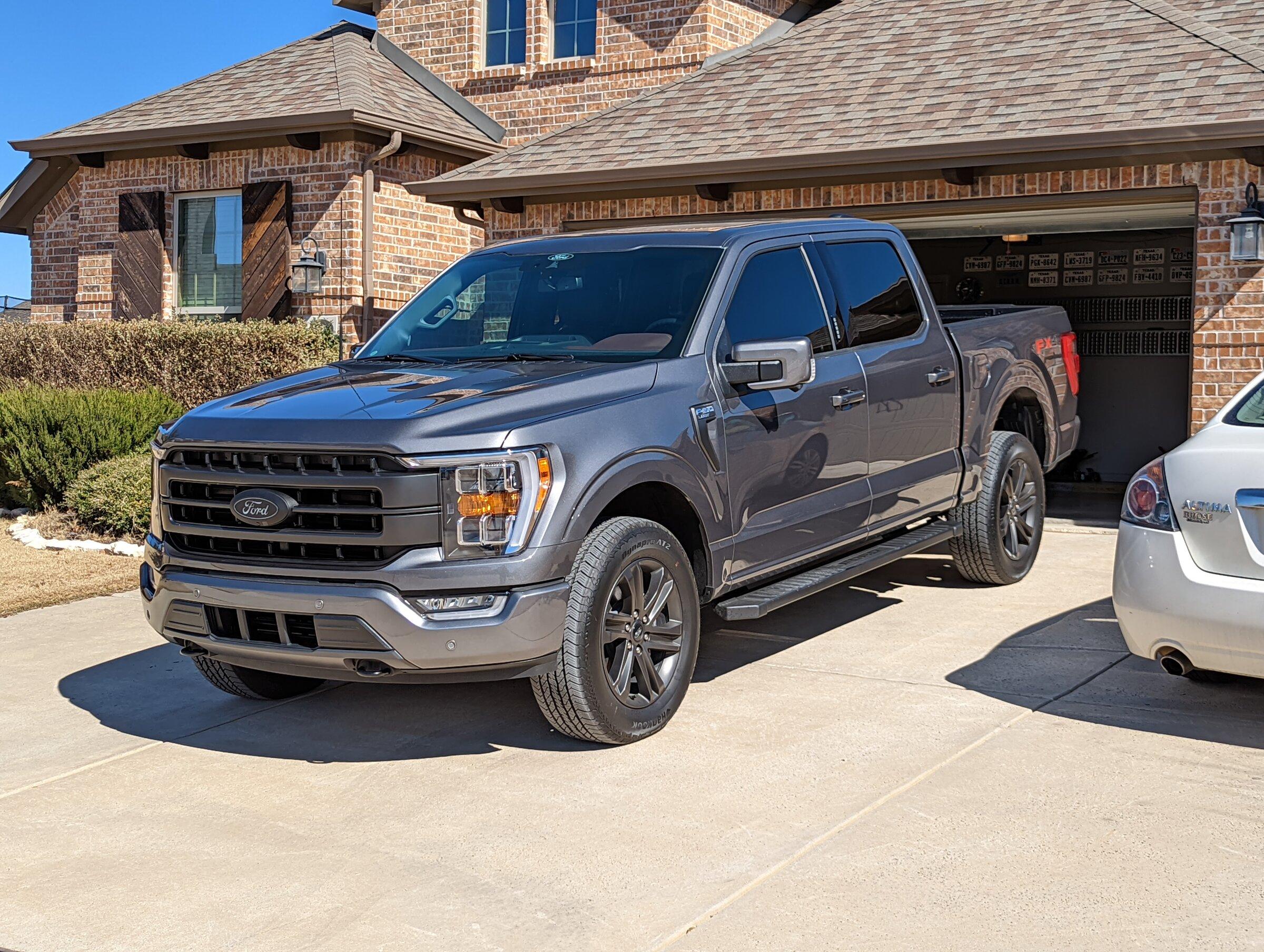

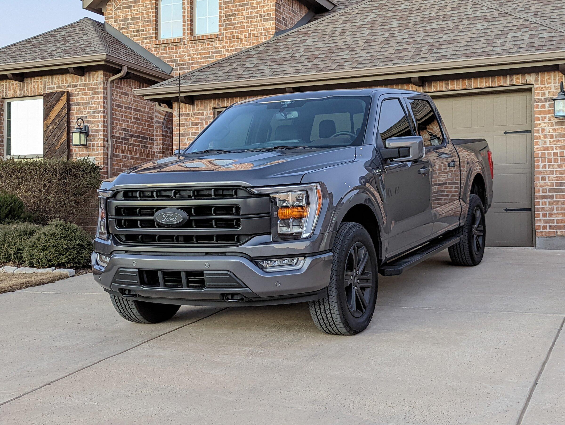

Few more... Better lighting.
