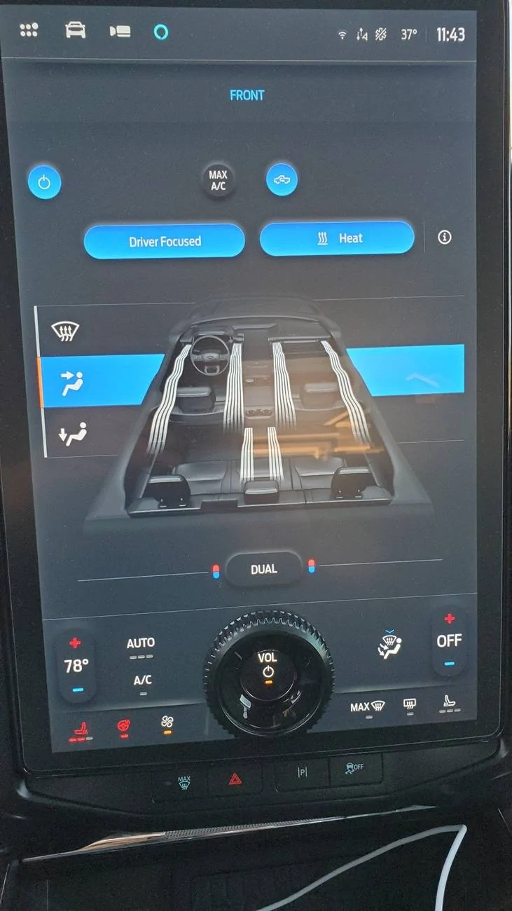

I could get the recirculation to stay on as described above, but it only lasted until shutdown.
On the next startup the system returned to normal {manual settings unchanged, except the recirculation switched off} 22 Lariat-ER
BTW -edit- The Secretary of my Treasury wasn't happy with that mode of operation, her tootsies were chilly, so back to auto for us.
For reference, here are the settings I am using:
Ford F-150 Lightning How to force recirculation mode to stay on 20241204_114326
That's how mine was set up, except front passenger present so driver focused auto disabled.

Check out the last post on this thread of the same issue on the ICE forums. I am guessing that we also have a humidity sensor in our trucks that overrides this setting.
https://www.f150gen14.com/forum/thr...tay-on-keeps-turning-randomly-off.1731/page-2
The location of the temperature sensor also explains why I need to turn the A/C up to 78 degrees when the sun is shining to keep the inside of my truck at an acceptable temperature.
