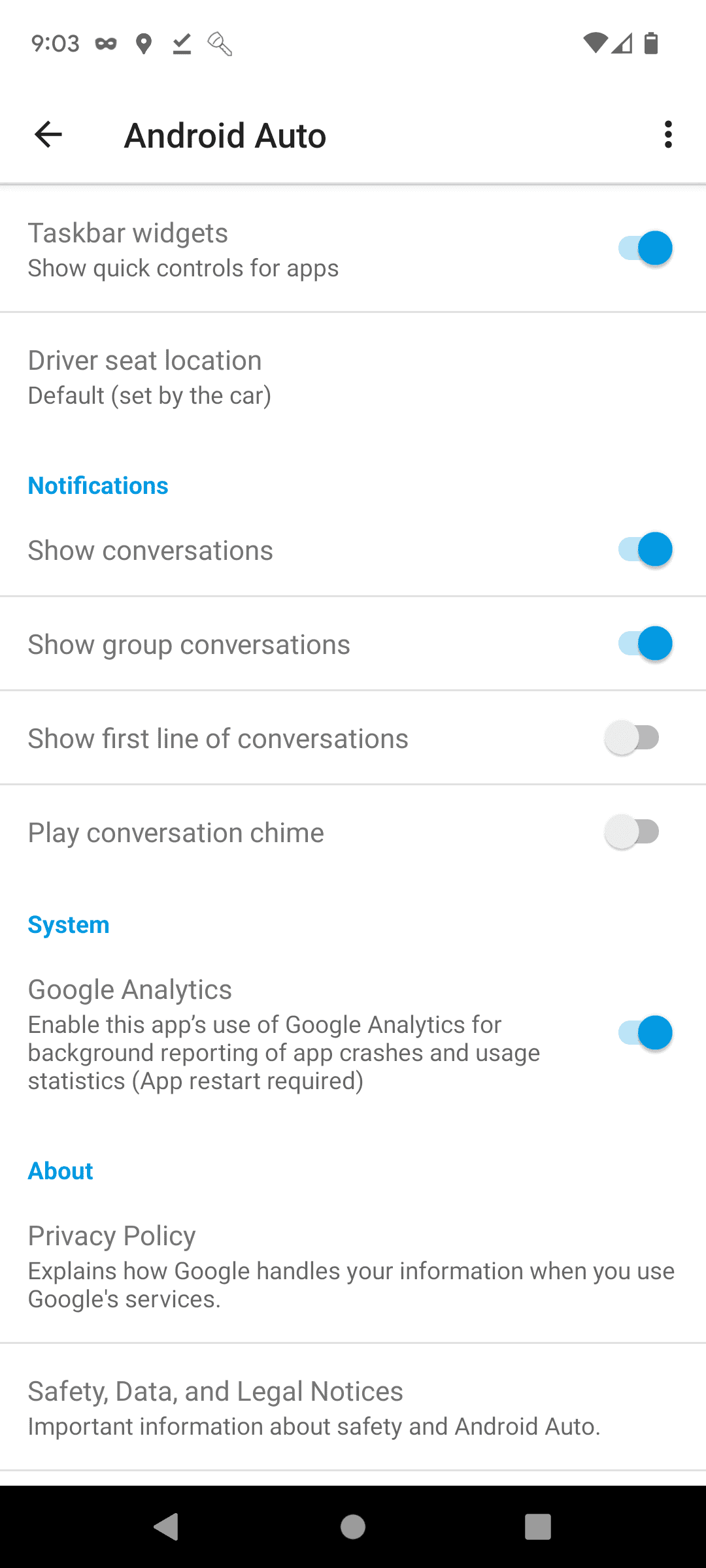

On your phone, open settings, search for Android auto and open, scroll down to notifications, turn off Play conversation chime?

That's one of the first things I did. Didn't help. Still BLINGs.

BTW I also switched it off in android auto to no avail.

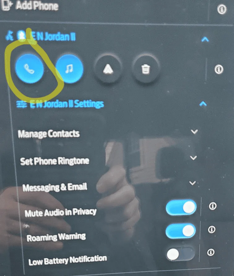

We need to to get into the basic bluetooth based phone controls instead of the android auto or car play controls.
From the truck settings menu select Phones to get to this display, normally my Android Auto function is active [BLUE], so I selected the handset icon, which gave me the following settings and access to sub menus where the control switches are located.

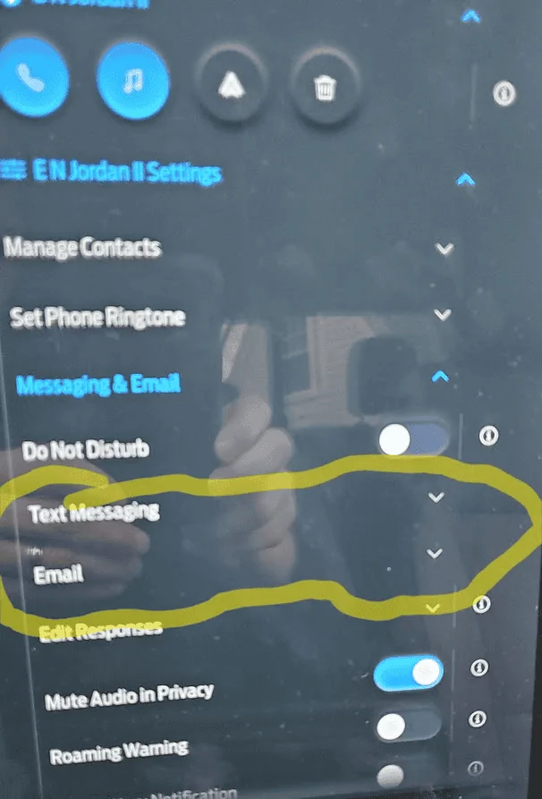

Get into the Messaging and Email drop list.
See the Text Messaging & Email options, additional controls

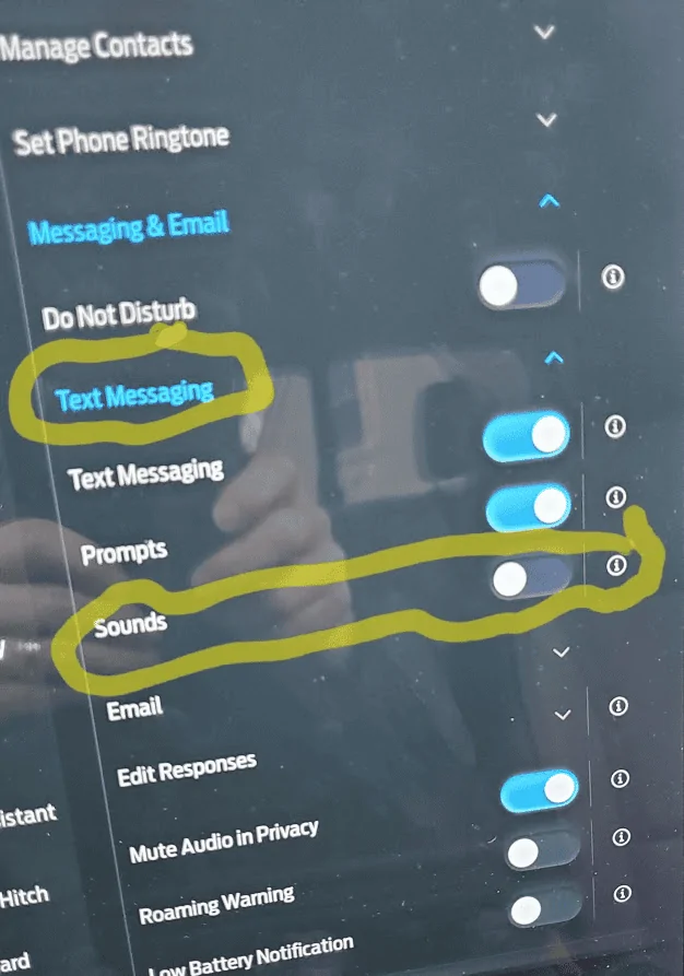

Text Messaging controls allow you to turn sound off or change the type of melody, switching it off hides those additional adjustments.

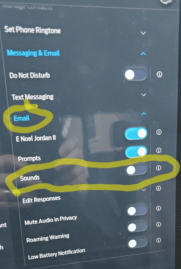

Email controls allow you to turn sound off or change the type of melody, switching it off hides those additional adjustments.
