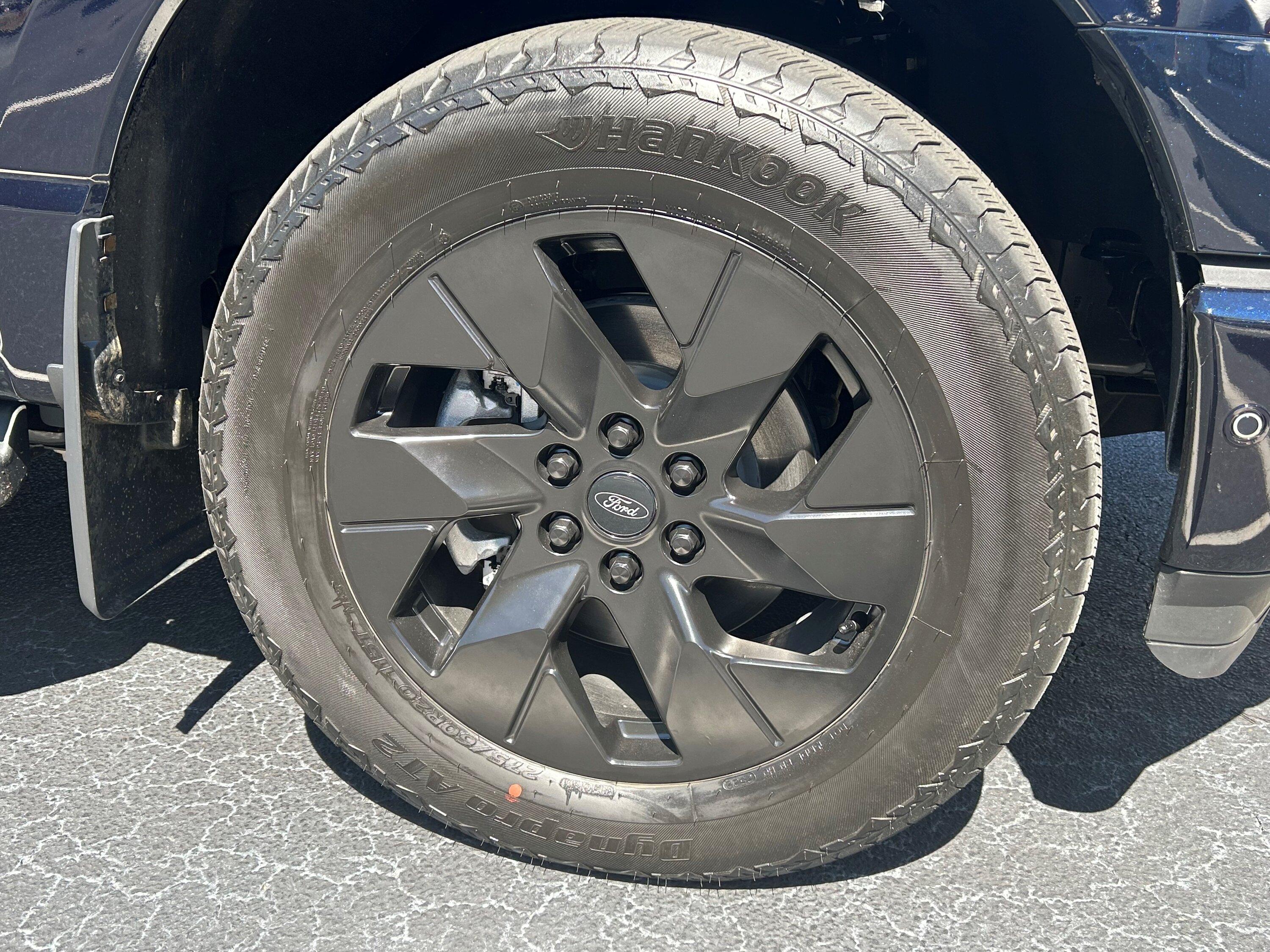

Have before/after pics of the plasti-dipped wheels?

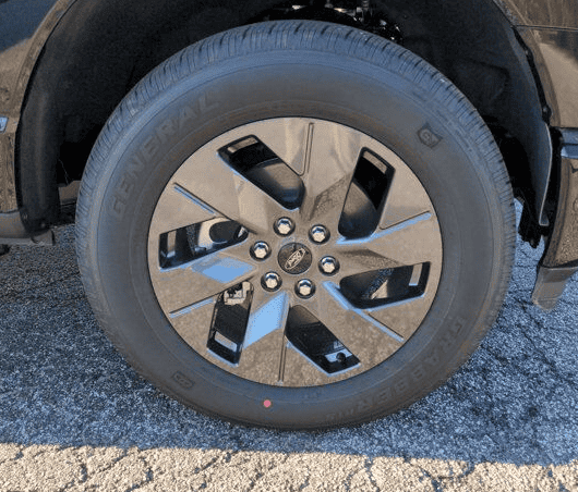

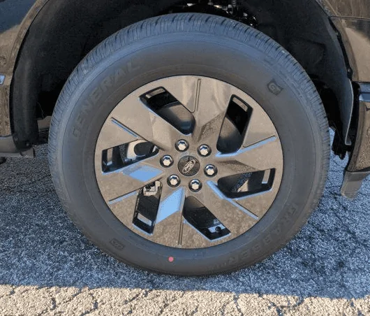

Had to dig for preview pic, ended up stealing one off the internet, but here you go:
Before:
Ford F-150 Lightning How to Remove 2023 F-150 Lightning Front Grille in 4 Easy Steps rim before.PNG
During:
Ford F-150 Lightning How to Remove 2023 F-150 Lightning Front Grille in 4 Easy Steps rim duri
After:
Ford F-150 Lightning How to Remove 2023 F-150 Lightning Front Grille in 4 Easy Steps rim after

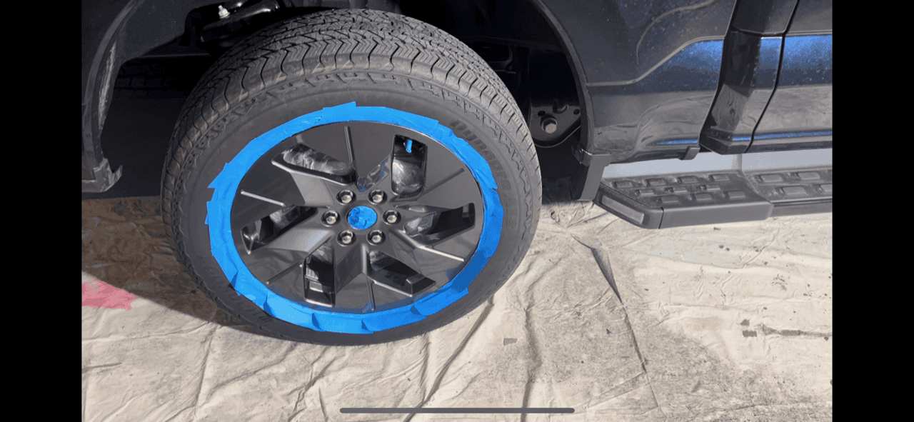

As you can see, I painted while wheels were still on the truck. Taped with blue painters tape. I put some plastic bags (used large leaf bags) behind the rim to protect brakes and other components from overspray. Also parked on a drop cloth. Prep took as long as actual painting.
Plasti dip had a YouTube video on how to perform this operation, but I didn't want to invest in all the other stuff they were selling, or more accurately, didn't feel like waiting for it to be delivered. I did invest in a $5 spray can trigger similar to this one:
Ford F-150 Lightning How to Remove 2023 F-150 Lightning Front Grille in 4 Easy Steps Capture.PNG
I might have to peel plastidip off of lug nuts during my first tire rotation, we will see.
