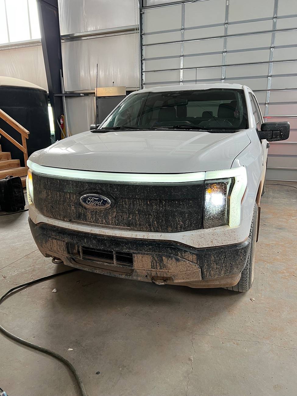

I am finally getting around to adding the lightbar to my '23 Pro ExtendedRange, I got the lightbar from Stillwell Ford online for $185 new.
I have the lightbar installed on my truck, fairly quick and easy install, but now when I try and update the firmware using forscan I only see the AS BUILT entries and I do NOT see the Module Firmware Update entries for LDCMA and LDCMB. I don't believe I would need to edit the 'As Built' entries.

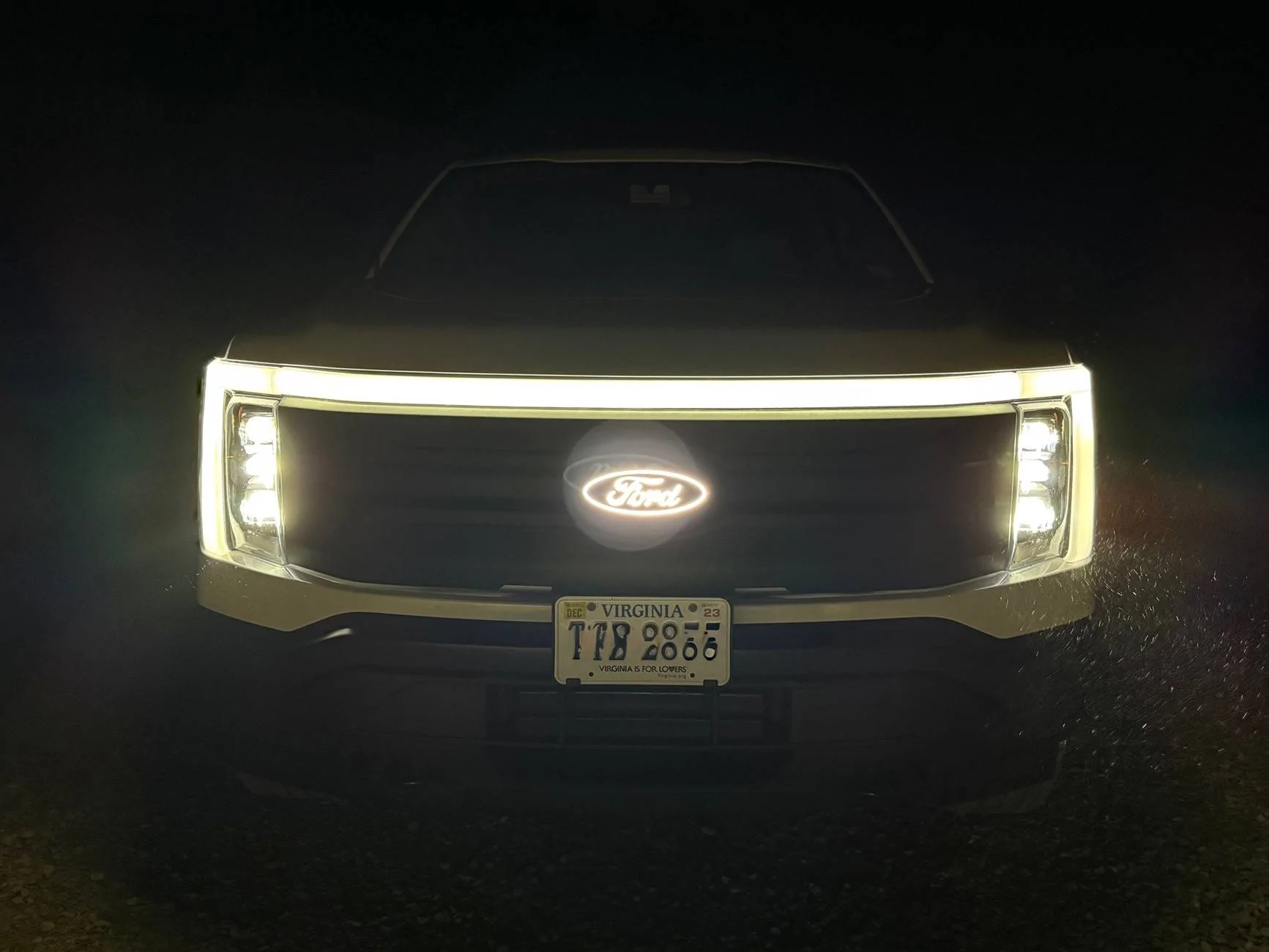

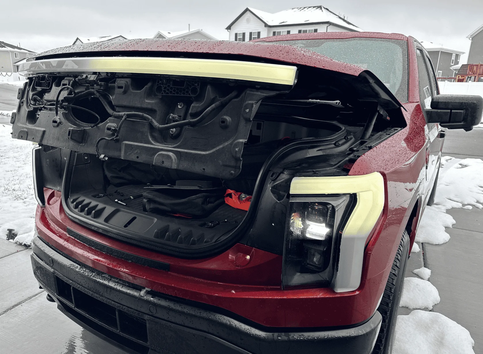

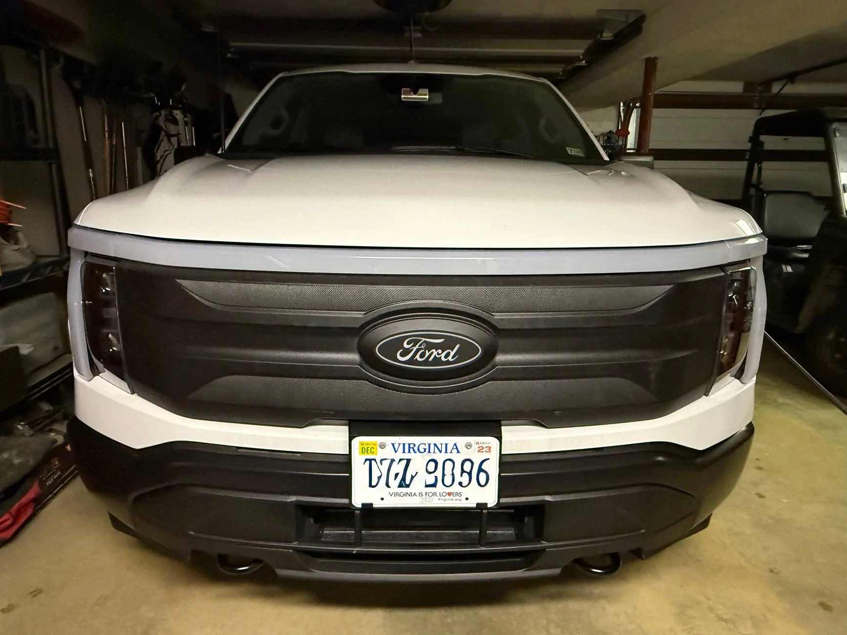

Successful install on a Pro ER with no tech or tow or any other packages. Thanks for the great write up and video. Love the look of the ER grill with the light bar!

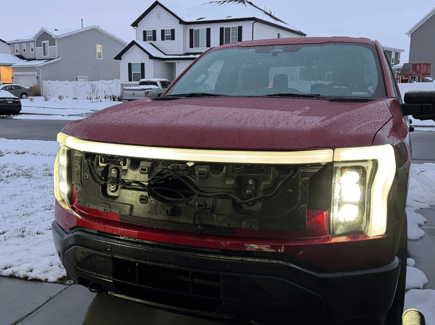

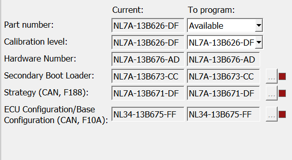

I'm In trouble here any advice is welcome. I followed the steps of this thread up to programming and the LDCM A update failed. And has failed probably 6 times. DTCs are cleared and truck is unplugged. I now have no DTC function at LDCM A, so I can't reset it or anything. Can anybody explain what happened here, what I could do different, how to find "AS BUILT" files (if that would even work)? As far as I can tell I have no communication to the drivers side headlight and it will not turn on.

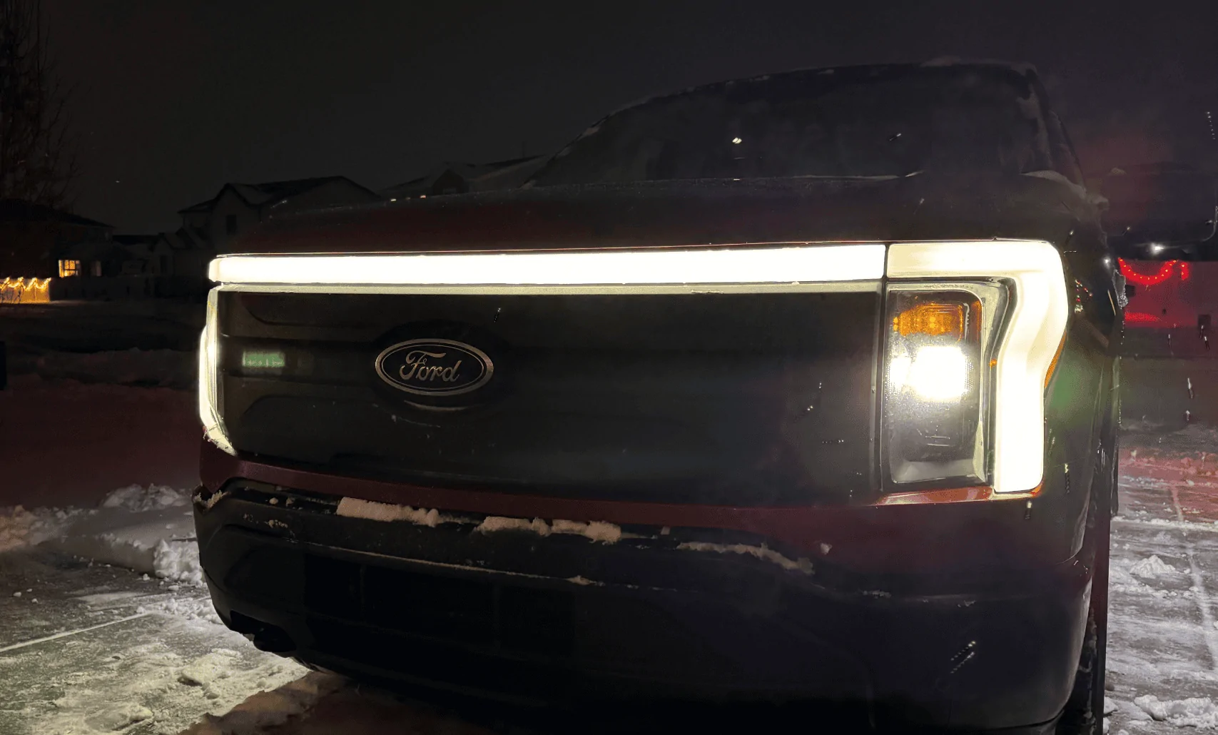

Did my 23 Pro ER today. Had the install done in about 30 mins. Had some dumb complications that were my fault getting the beta forscan downloaded but once I got it downloaded i was able to do the firmware update on the first try. No DTC clearing needed.

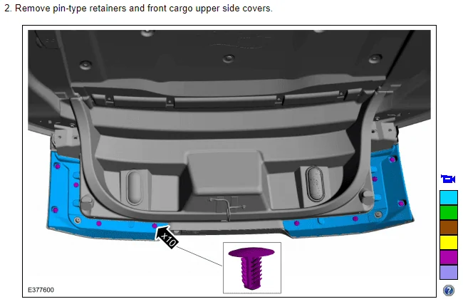

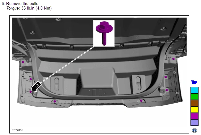

Removing the grille is fairly easy. Pop the frunk, and remove 10 plastic push pins, 5 from each side of the grille.

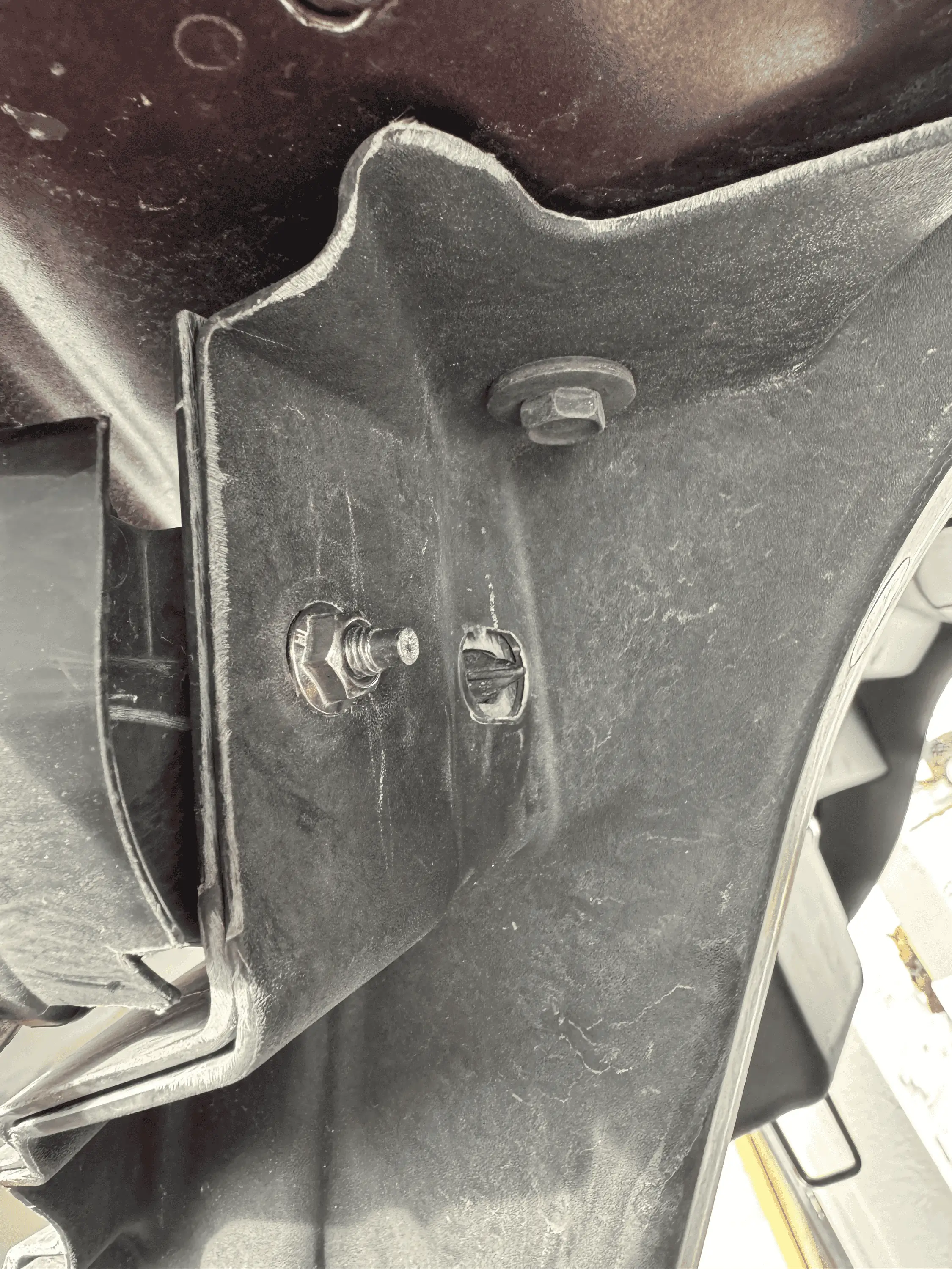

Next, remove 8 bolts from the grille, 4 on each side

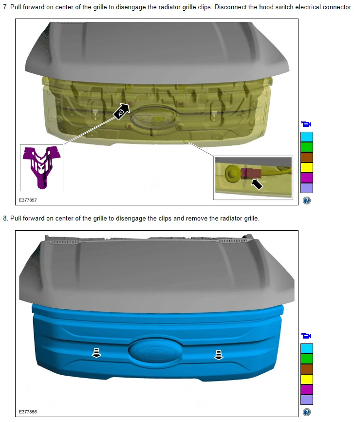

Now pull forward on the grille to disengage the retention clips.

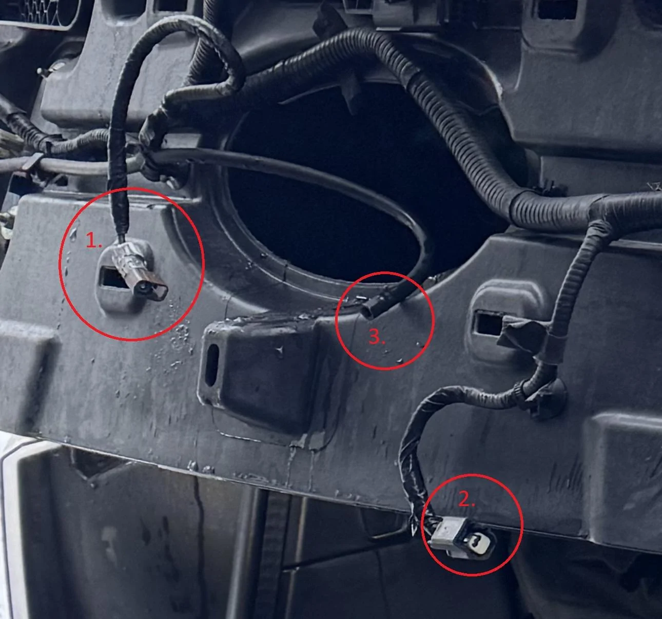

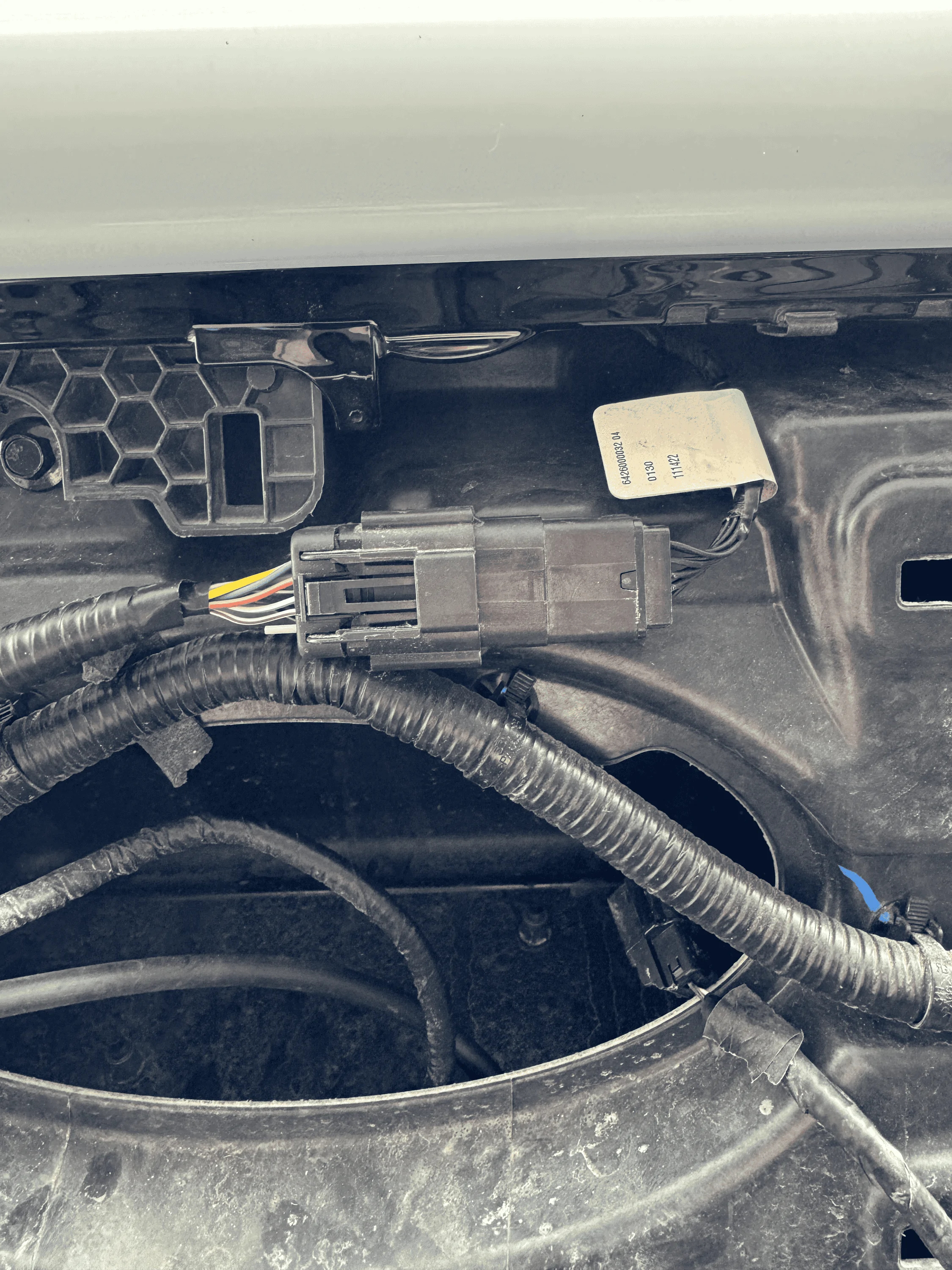

Be careful here. The grille will have some wiring connected to the forward camera (1) and frunk release button (2). You also might have a hose connected to the front camera washer (3). These should all be fairly easy to remove but I did break the locking clip on my camera connector so go slow and take your time. Once you get everything disconnected you can set the grille aside.

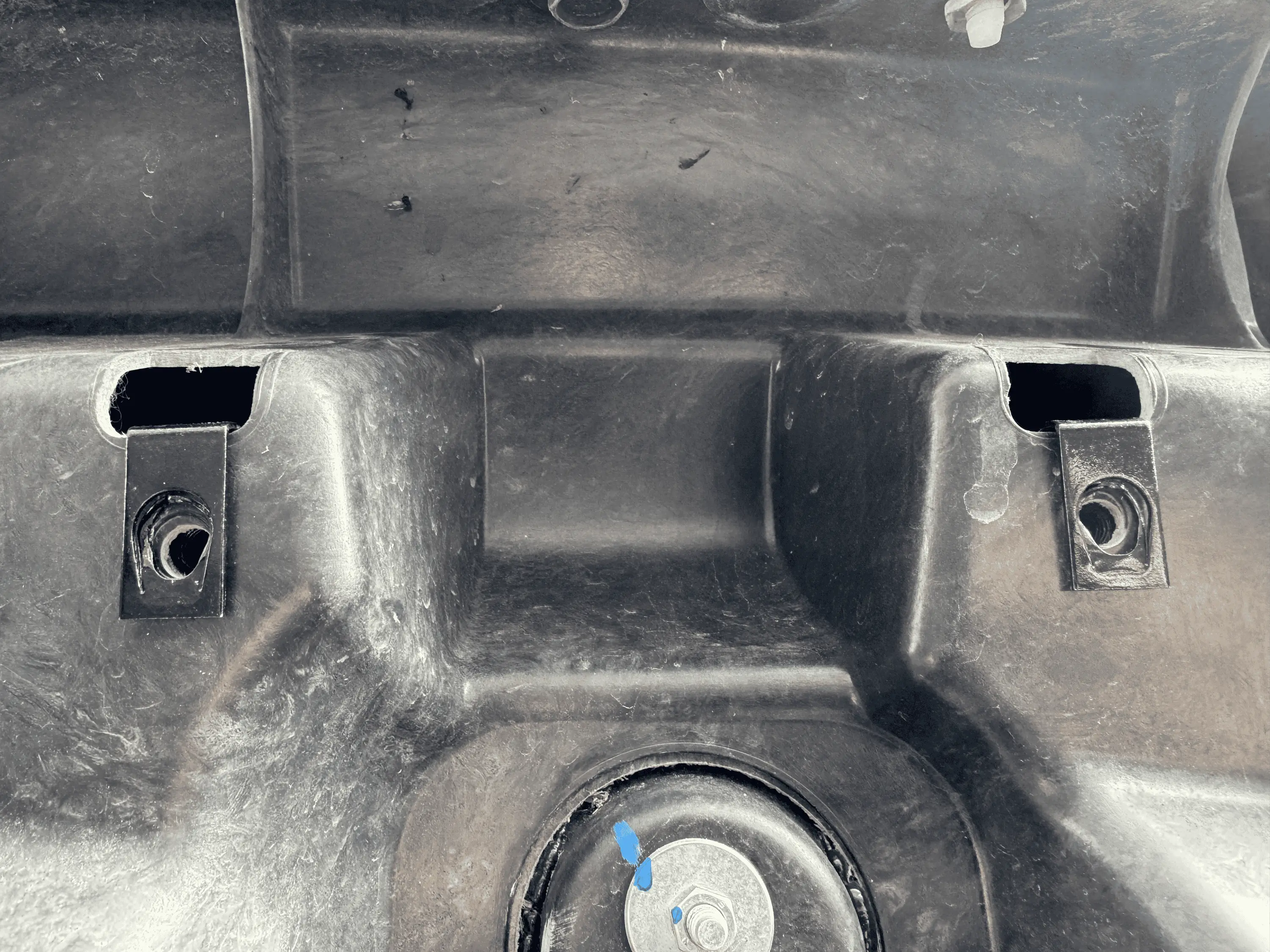

Now, lets mount our new light bar. Grab your 5 M6 spring nuts and insert them into the slots on the grille reinforcement. The spring nuts should be oriented like the picture below, with the nut behind the grille reinforcement. These just slide in to these 5 positions:
We can now bolt up our new light bar! There are two studs mounted in the light bar that slot into the grille reinforcement be careful not to ding your paint and to align these into their home while mounting the light bar.
Thread your 5 M6 bolts into the spring nuts, but don't tighten everything, keep things loose so you can make sure the light bar is straight and aligned. I used the ~8mm push pin in the center mounting location.
Then secure the studs on the light bar to the grille reinforcement. Slowly tighten things down as you make sure the light bar is sitting nice and aligned with the hood.
Now use your trim tools to get rid of the empty light bar connector, push the connector from the light bar into the grille reinforcement and connect your light bar to the truck!

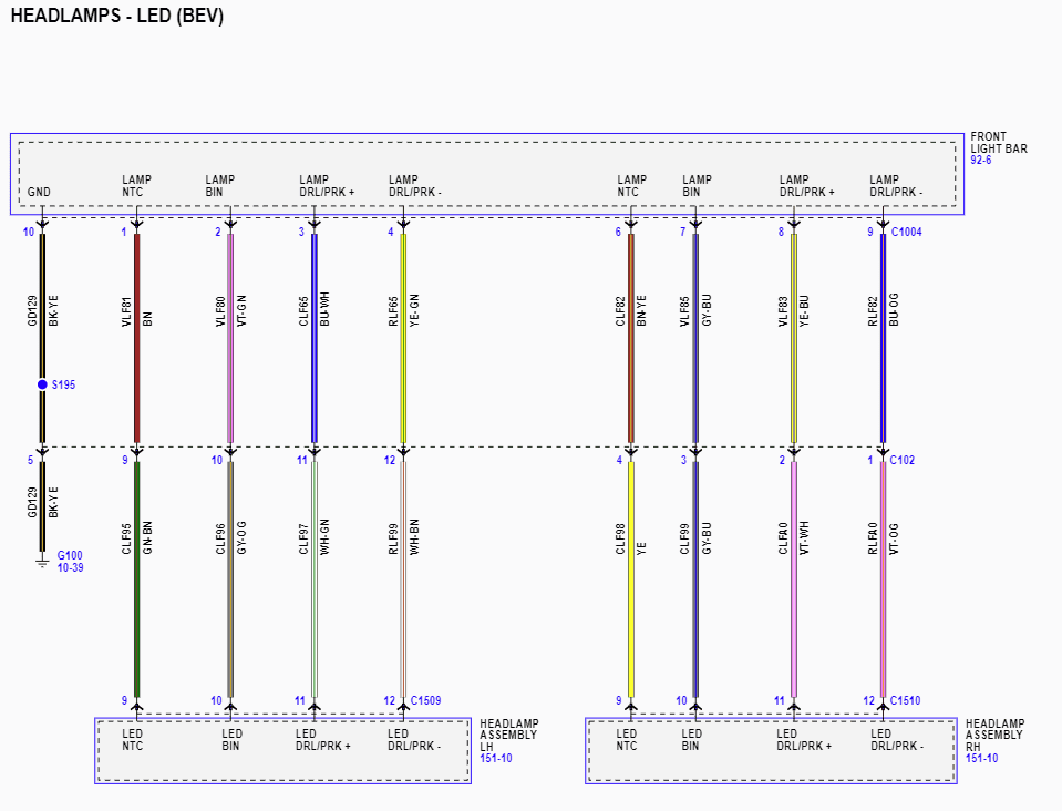

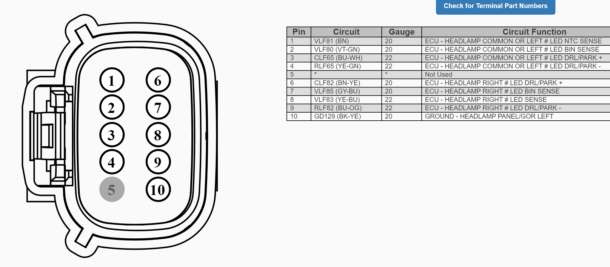

The light bar is directly connected to the back of each headlight. Each headlight has a module behind it called the LDCM. These step the voltage up to 36v to run the DRLs in the headlights as well as the light bar. By default if your truck isn't equipped with a light bar it just won't output the 36 volts needed to run the light bar.
If you want to double check the wiring to make sure you're prewired before you buy a light bar, put a multimeter between pin 10 and pin 6 on the connector and you should have some small voltage (mine was at 2 volts.) Pin 10 should have continuity to ground.

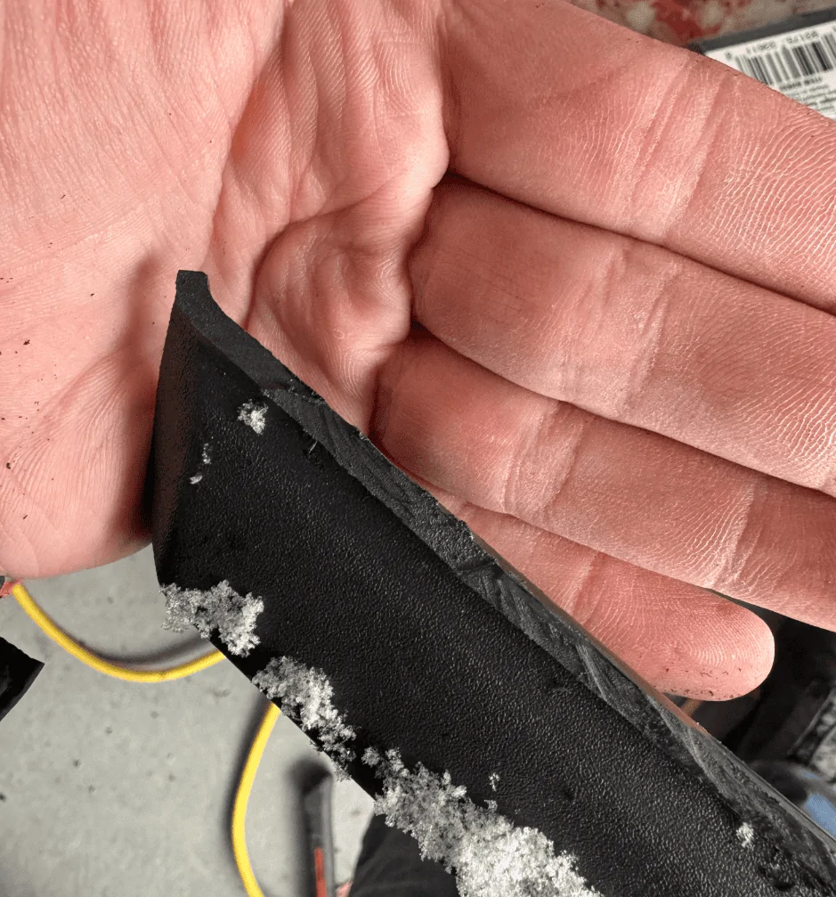

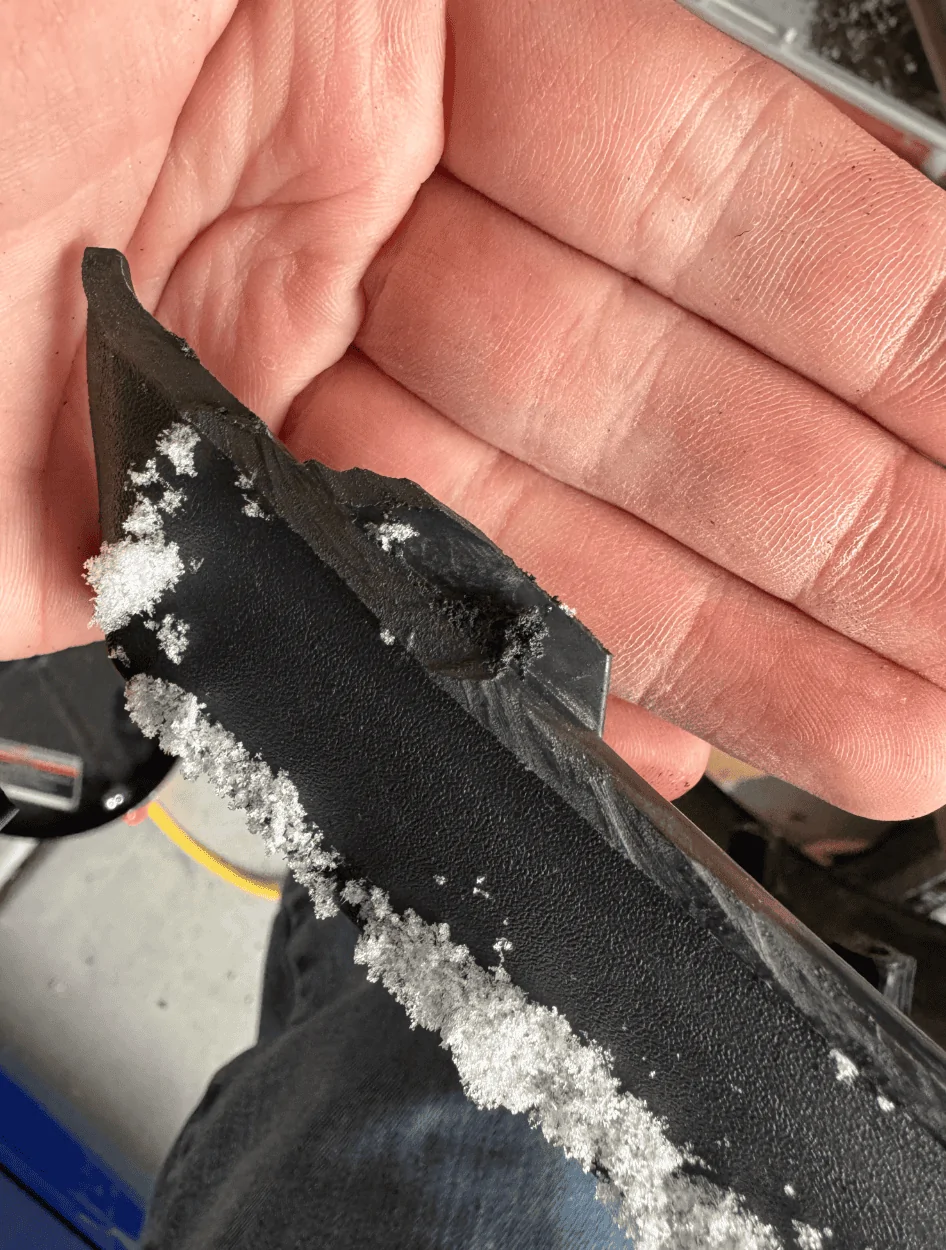

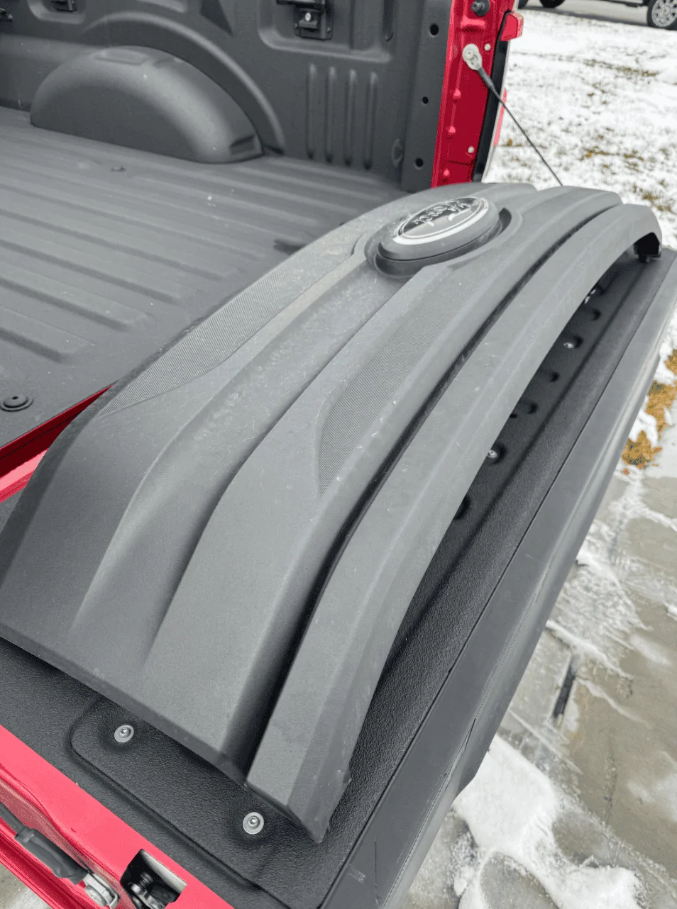

This is arguably the most tedious and annoying part (its not that bad) or you can spend the $1000+ to buy an OEM XLT/Lariat/Platinum grille lol. My dremel kept dying so if you have the choice between a corded dremel and a cordless, go for the corded. Start from the front side and begin making a cut just under the fake/blank light bar. I tried not to get too close to the edge of the grille. Once you have a solid cut going I found it easier to cut from the back side. You'll have 4 retainer mounts to contend with and if you can see what you're doing around the area it becomes much easier.
Once you've got it separated, at each end of the grille make sure you completely remove any remnants of the mounting tabs. I left a little bit at each end and when I went to test fit the grille, those tabs hit the light bar. A quick zip with the dremel took care of them.
Knock off any plastic slag from the dremel work and start mounting the grille back up. It should snug up just like it was when you first took it off. You should only be left with a dummy plug, and two coarse threaded screws from the grille.

Worked on a 23 pro without any tech packages. Didn't have to clear anything. Thanks.

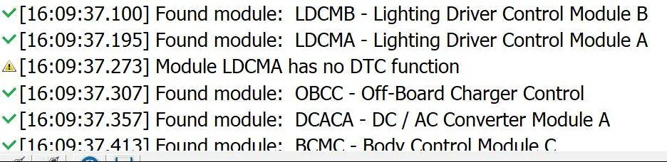

Hoping someone can help. Loaded everything and according to Forscan it was successfully. Now I have an "open circuit" fault on LDCMA and LDCMB is working fine. Only half of my light bar is lighting up. The driver's side is just flashing. Hope someone has any ideas. TIA.
I had the same issue, but it was because the used light bar I bought on eBay was missing a pin in the connector. Fortunately, I was able to return it for a refund. The next light bar I ordered worked perfectly.
it may not help you, but checking the connector is a quick and easy thing to confirm.
