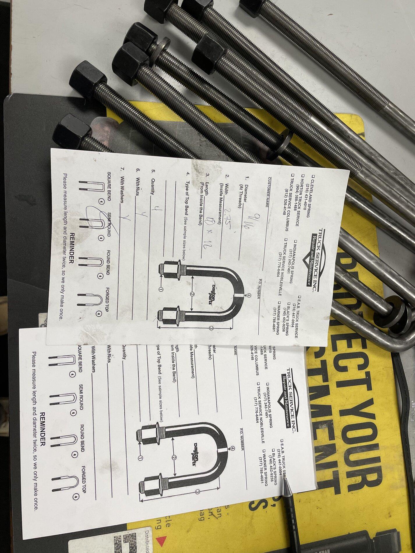

Since I am from out of town I decided to try my luck right before closing time of the Indy Springs at West Indianapolis. They literally saved my day by taking me right before they close and custom made my new u-bolts. The custom U-Bolts were amazing and in NO WAY i can find them anywhere on the market right now for 2021 F-150 this quick. They saved me another trip to indy from my small town and also made my bad day a lot better. I would totally recommend this business. They saved my day. I have attached specs for U-bolt for 2021 F-150 as below for those who got the same truck. You should get them from here.
TLDR: Indy Springs custom made my U-bolts for 2021 F-150, which has its U-bolt redesigned and none of the previous generation U-bolt would work unless you have max-tow.
The U-bolts (as read from the sheet) specs are: 9/16 thread - 10'' (factory) or 12''(for me, that has a 3'' replacement rear block), inner spacing is 2.75'' (at least it fits for me). The shape is semi-round.
The specs are measured by the staff at the spring shop and I do not claim that they are 100% exact. But it works for me so I just wanted to share it since I cannot find any of those info online.
THanks.
