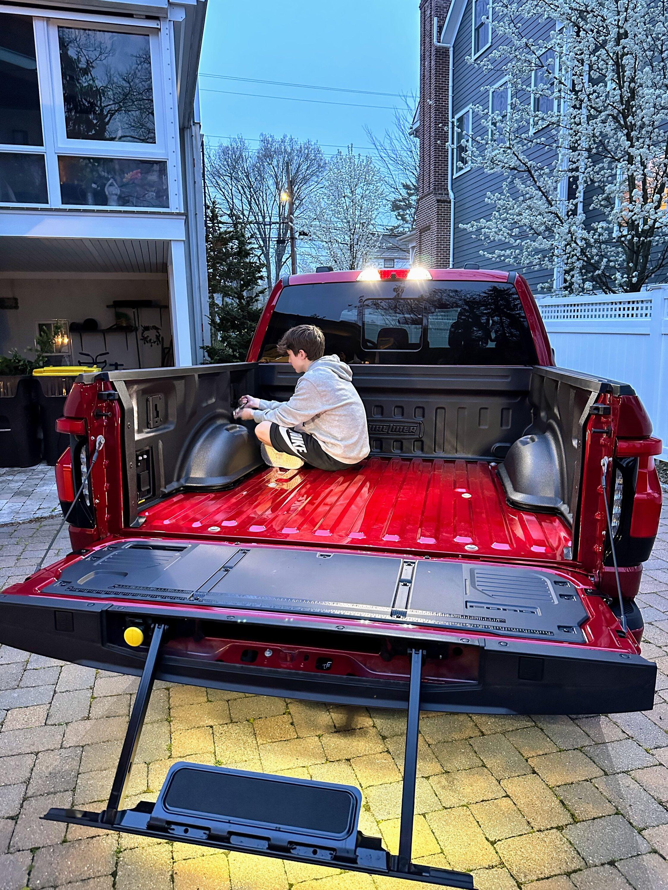

Installation Impressions
  • Between boxlink and the standard anchors, you've got 32 machine T30 Torx machine bolts to remove and reinstall. We did them by hand with ratchets and wow, that approach took a long time, but we didn't strip anything.
  • Once that hardware was removed, the side pieces snapped in quite snugly. It took a little finagling to get the sides under the plastic bed rails, but the resulting fitment was quite excellent.
  • The fitment got even better as we reinstalled the hardware (again, the 32 bolts). It was at this point that it really started looking legit great. We did this part out of order with the video and instructions which suggest that you do this last, but we found it easier to make sure that the hardware bolt holes lined up without the heavy rubber bed floor liner in place.
  • That rubber bed floor liner mat is heavy and quite convincing. It's also a very snug fit. It hilariously ripped a whole finger off of my nitrile gloves... twice. Watch your finger tips between the heavy mat and those channels.
Ford F-150 Lightning Installed Dualliner Bedliner IMG_1327
