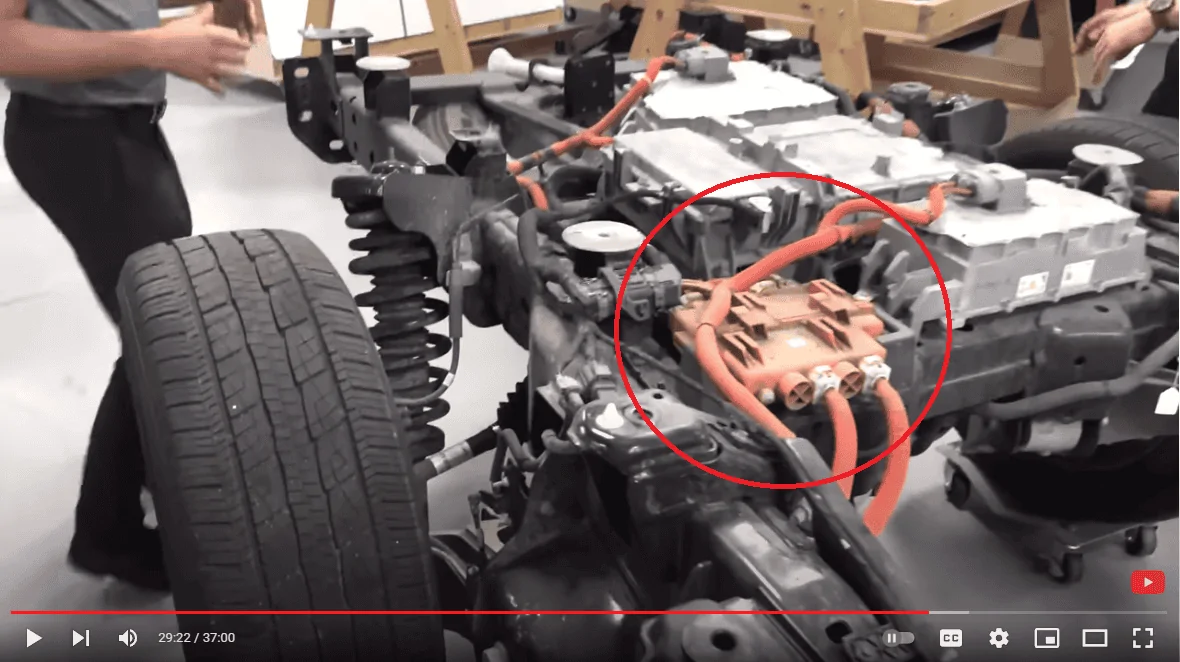

$1500??? Is the orange color because it's doped with gold, wtf? I get that it's likely low O2 high strand count copper (correct me if I'm wrong here) HV rated, despite most cables I've seen being 600V anyway, that leaves the connectors, maybe $250 in wire, $1250 for connectors? Am I missing something?
Edit: I was seriously considering doing this until I saw this ridiculousness.
The MSRP for a single headlamp assembly is $1,507.63. By comparison, $1.500 for a wiring harness seems cheep. But the need to replace the HV wiring harness largely convinced me to abandon this idea.
Full disclosure: Some Ford dealers will sell you a headlamp assembly for a bit under $1000. What a bargain!
I almost understand the cost of the headlamp, especially considering they include the matrix type lighting. Weird they added it since the primary market disallowed at the time of introduction iirc. I assumed that the 'harness' was just to the inverter, in which case the price is still ludicrous. But if it were to attach at other points then I could see it, I guess...
It's one of several parts of the HV DC wiring harness. I don't think the inverters are the only parts it connects to, but I don't know what else it attaches to.
It is the entire rear DC Harness, with distribution box and all components that touch the DC bus, including the rear drive unit. That's why it's so expensive. This wouldn't be an issue at all if Ford didn't Tier 1 restrict all the connectors with their suppliers. They do this so they can pick and choose which connectors to offer as repair parts, and charge 10-20-and even sometimes 30times the amount it should cost if the supplier sold it on the open market.
Is this rear harness entirely limited to the area under the bed? The idea of replacing a wiring harness gives me visions of what Tesla wanted to do with my Model S to replace one slightly gnawed wire between the HVAC controller and an A/C valve, which would have entailed almost complete disassembly of everything but the body panels, large structural members, and suspension (removals included the 12V battery, propulsion battery, all seats, center console, everything in the dash area, which is a LOT of work, the frunk, etc.) and cost several thousand in labor. I passed on that repair.
If I can replace the rear HV harness with one from a salvage yard once I remove the bed without a lot of hassle disassembling the cabin and dealing with trim that I inevitably make a mess out of, maybe I should put this back on my to-do list, but it'll still have to wait until I'm done with spring work planting in the vegetable garden working on the lawn.
Mostly yes, with the bed removed it can be 100% accessed and swapped easily/quickly. The only part that runs under the cab is the connector that plugs into the front of the battery and runs back to the HV Junction Box.
