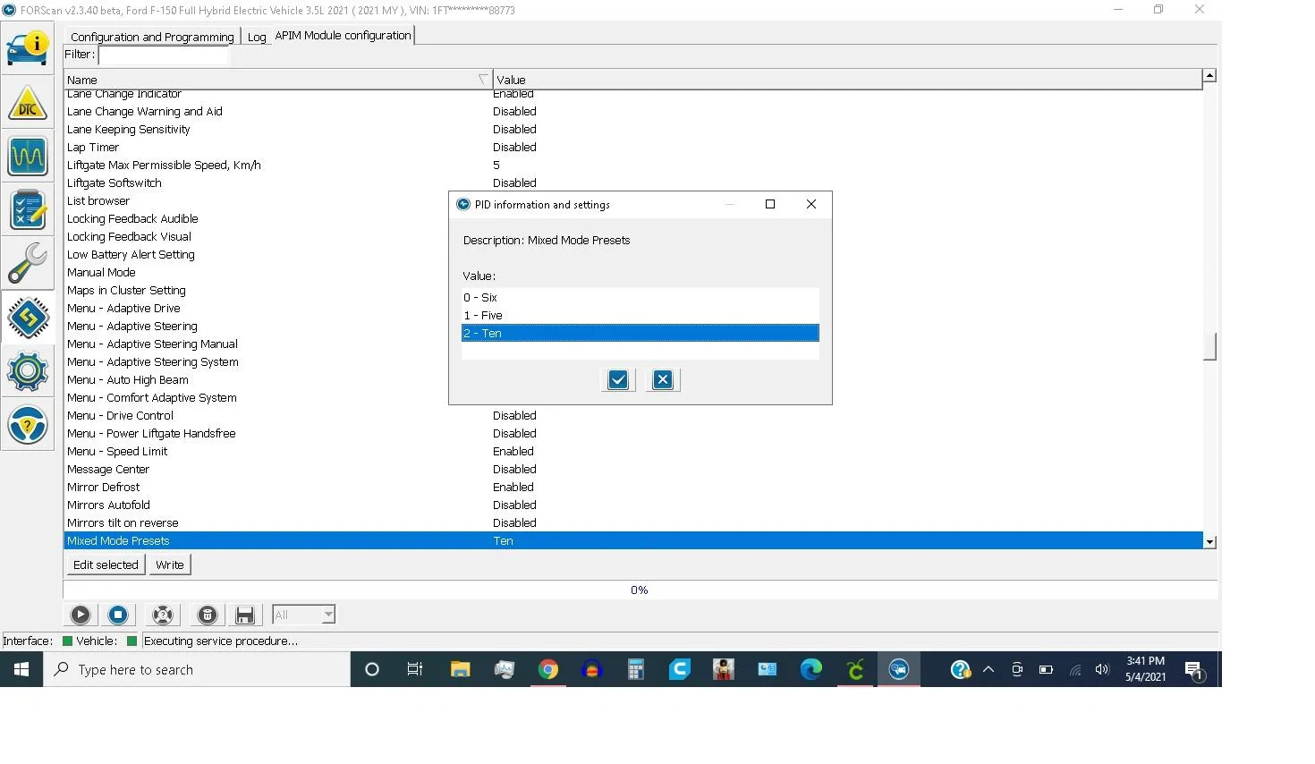

Sorry for the long delay on posting how to enable the extra screens. Work has been beyond hectic for me lately. Here is the setting you want to change to get all the cards on Sync4. Change this value from "5" to "10", and that's it! This is located in the APIM module configuration, not the as built. Hope this helps!

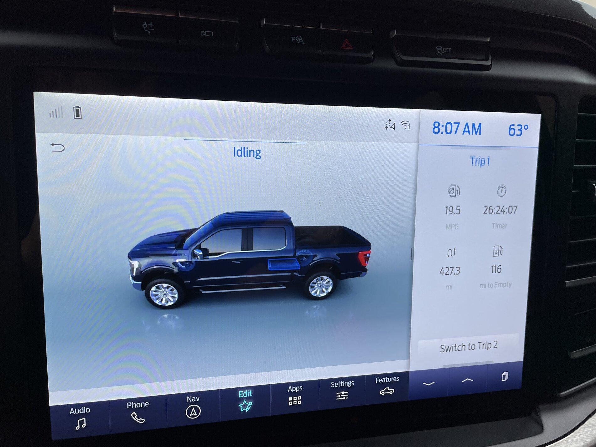

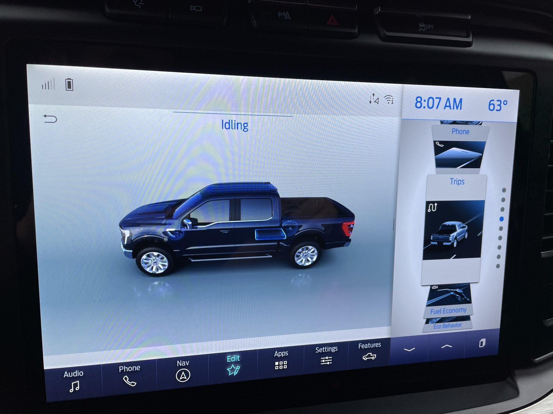

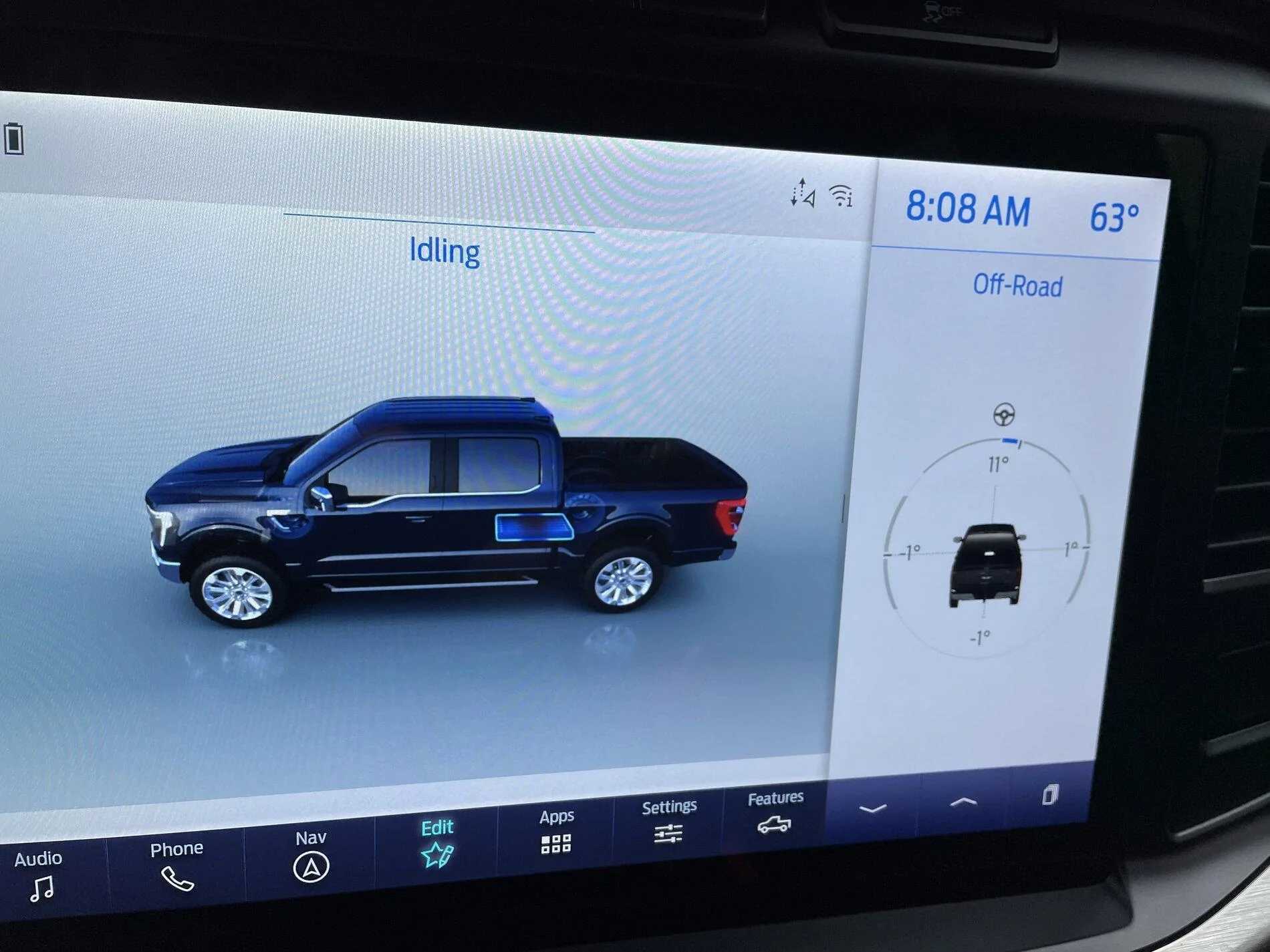

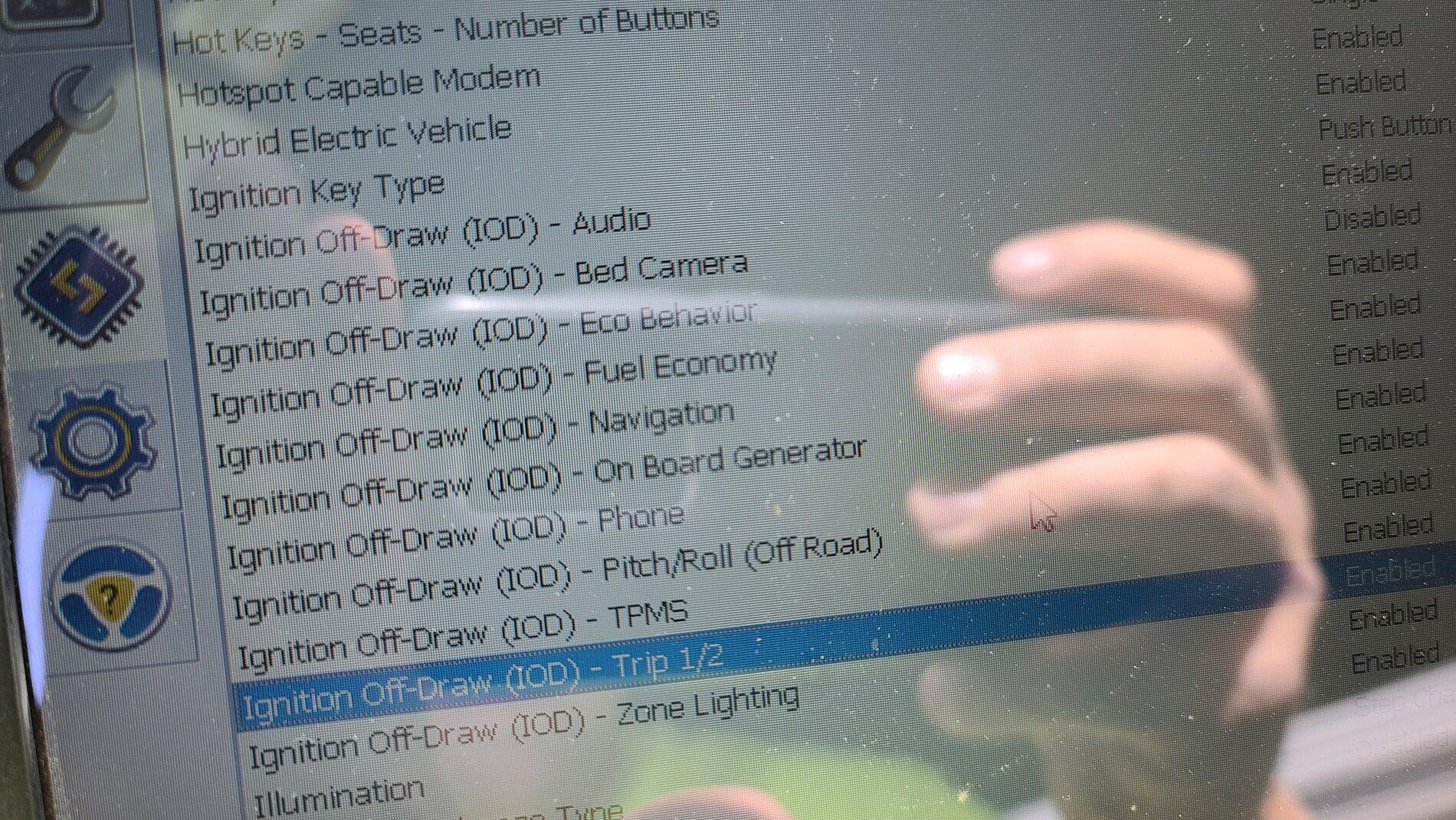

Forscan image below comes from John_C. Enabling Ignition off-Draw (IOD) features will show the extra "Cards" on the second screen. The images of the Sync4 are from my truck after enabling Fuel Economy, Pitch/Roll (off road) and Trip 1/2

This worked great for me. Took a few restarts. Thanks. I did enable the Bed Camera in IOD but it did not show up.
