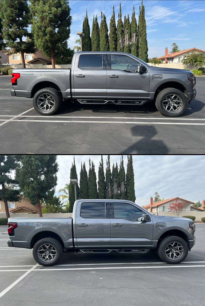

Truck looks awesome! Which wheels/tires are those and what lift or level did you use?

Thanks! I have a 2.6" level using Eibach shocks, keeping the stock springs. That got rid of the floaty feeling in front. Tires are 305/55R20 Falken Wildpeaks (SL rated) on 20x9 Vorsteiner Venomrex V601s (+12 offset). I just switched to these, I previously had 295/60R20 Nitto Recon Grapplers on 20x9 Fuel Rebels (+20 offset) but I wanted to switch to a SL rated tire. I'm really happy with this setup right now.

Thanks! I plan on getting the Eibach springs too. Looks great

Does the level kit raise the front or lower the rear? I just got a 2024 and feel like the rear is so much higher, will this settle down? Or do you need a level kit to fix the issue?

A lift kit will raise the front, but that raised rear end is designed to support a loaded bed.
