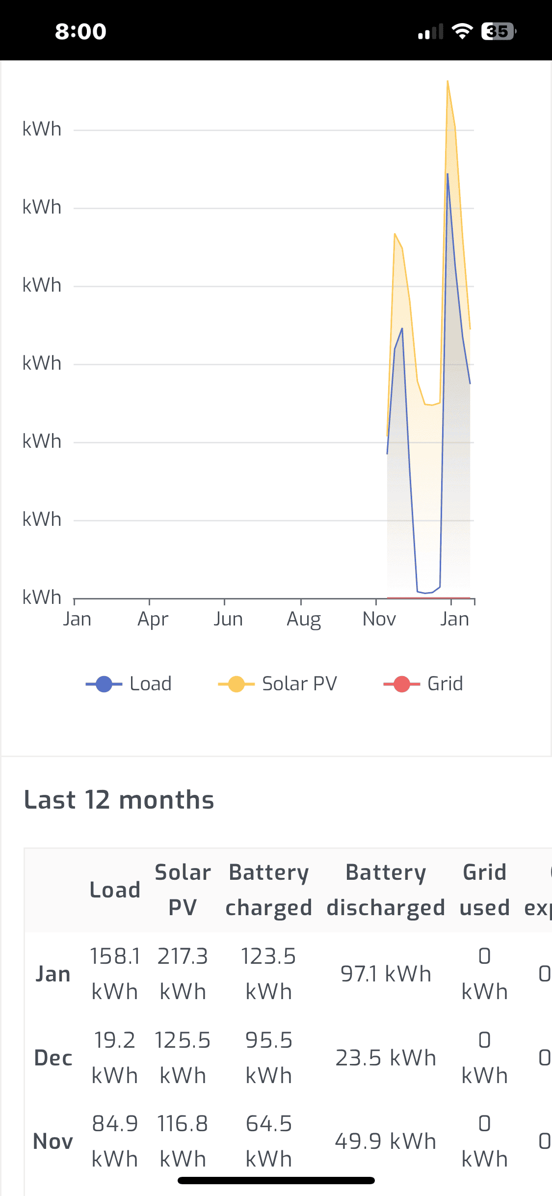

As one might expect, days are getting longer, and we broke another PV input record. I wasn't sure in the winter we'd get to 15kW, which portends to good output this summer.

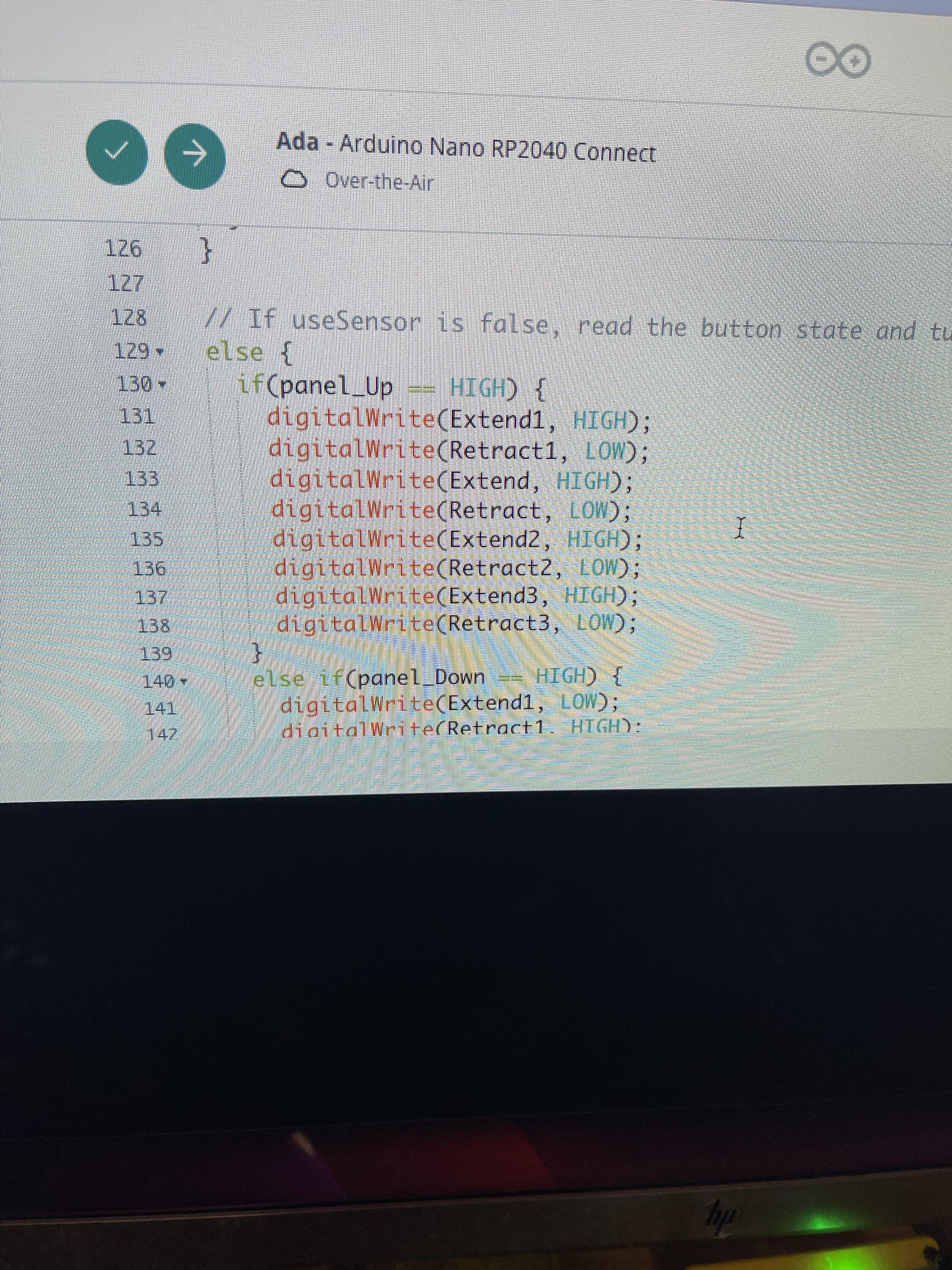

Working on the PA Hall sensor actuators
Ford F-150 Lightning Lightning off-grid charging Solar Array Build w/Agrivoltaics Screenshot 2024-01-18 at 12.18.00 PM

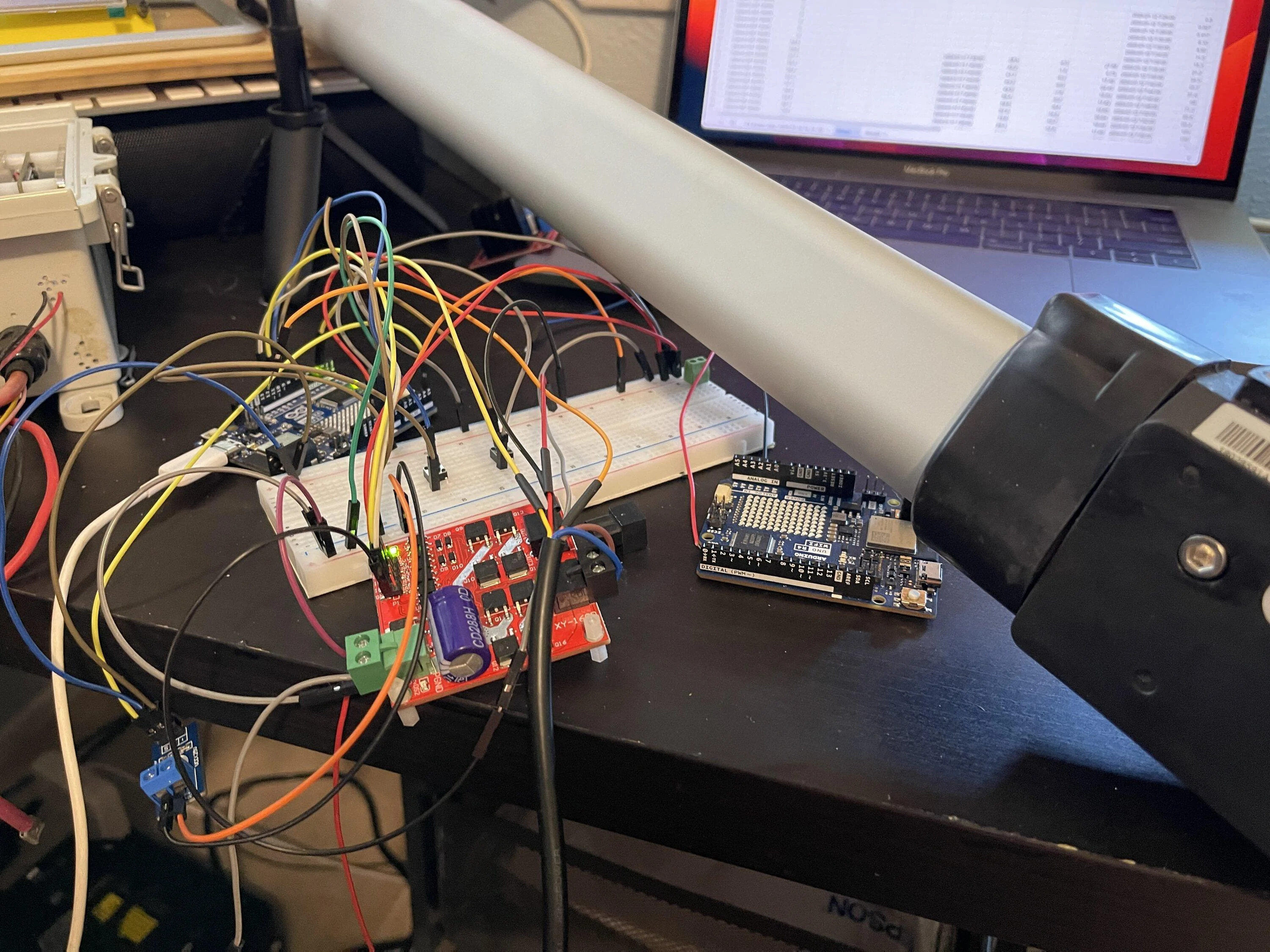

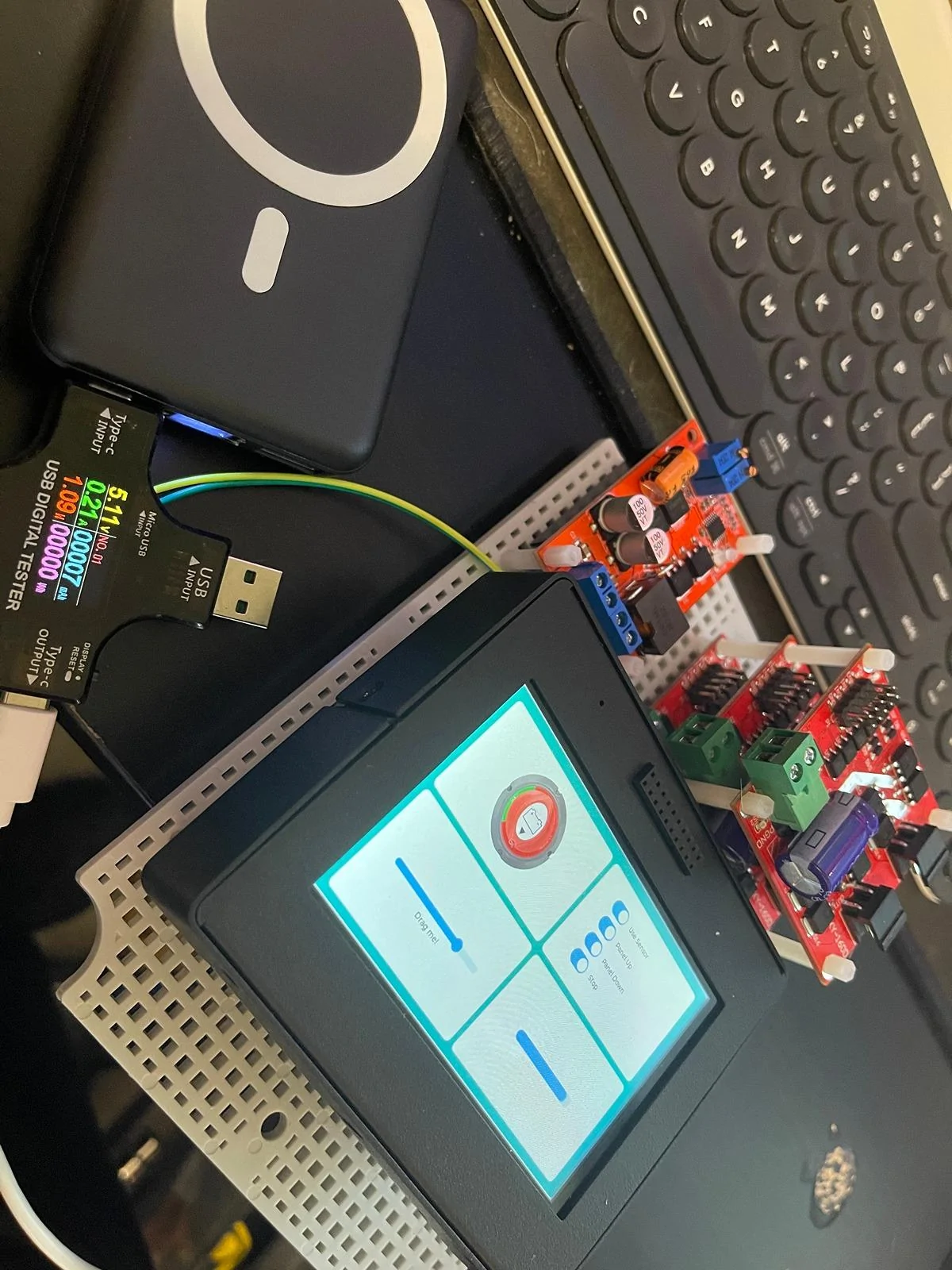

Have one moving as I would like with the motor drivers I've been using, and added a voltage monitor. Next working on syncing 3-5 of them. Wasn't sure I'd be able to use my dual h-bridge controller, but it looks like two of them might work.
I had to read this a couple of times 😂. You produced 15kWh, I was like what kind of panels do you have producing 15kW and got massive panel envy. All of your info is awesome BTW. I'll try to get my system posted soon, but way more basic that what you're doing..
Thanks, one of the things I'm doing is just checking to see if this is a viable way to do this.
I'm using the house as a control, which doesn't have tracking. While the tracking does provide more output, I'm not sure I'm going to get to the 25% additional I'd like to. We'll be deepening the angle of the panels from 15 degrees to as close as we can get to 25 degrees this weekend by moving to the 24" Progressive Automations actuators from the ecoworthy 18".
The charging system is 3600 watt, and the house 5400, or it's 66% of the house. So far, we haven't even produced 66% of the house output yet. If that is the panels being used, or the inherent increased loss of a dc inverter system vs. the house micro-inverters it will remain to be seen, but it may never be a perfect test environment due to the shadowing the powerlines above produce. I lose, I think 1-1.5kw a day due to this. There probably isn't a good way to configure the panels (series to parallel) to fix much, if any of that.

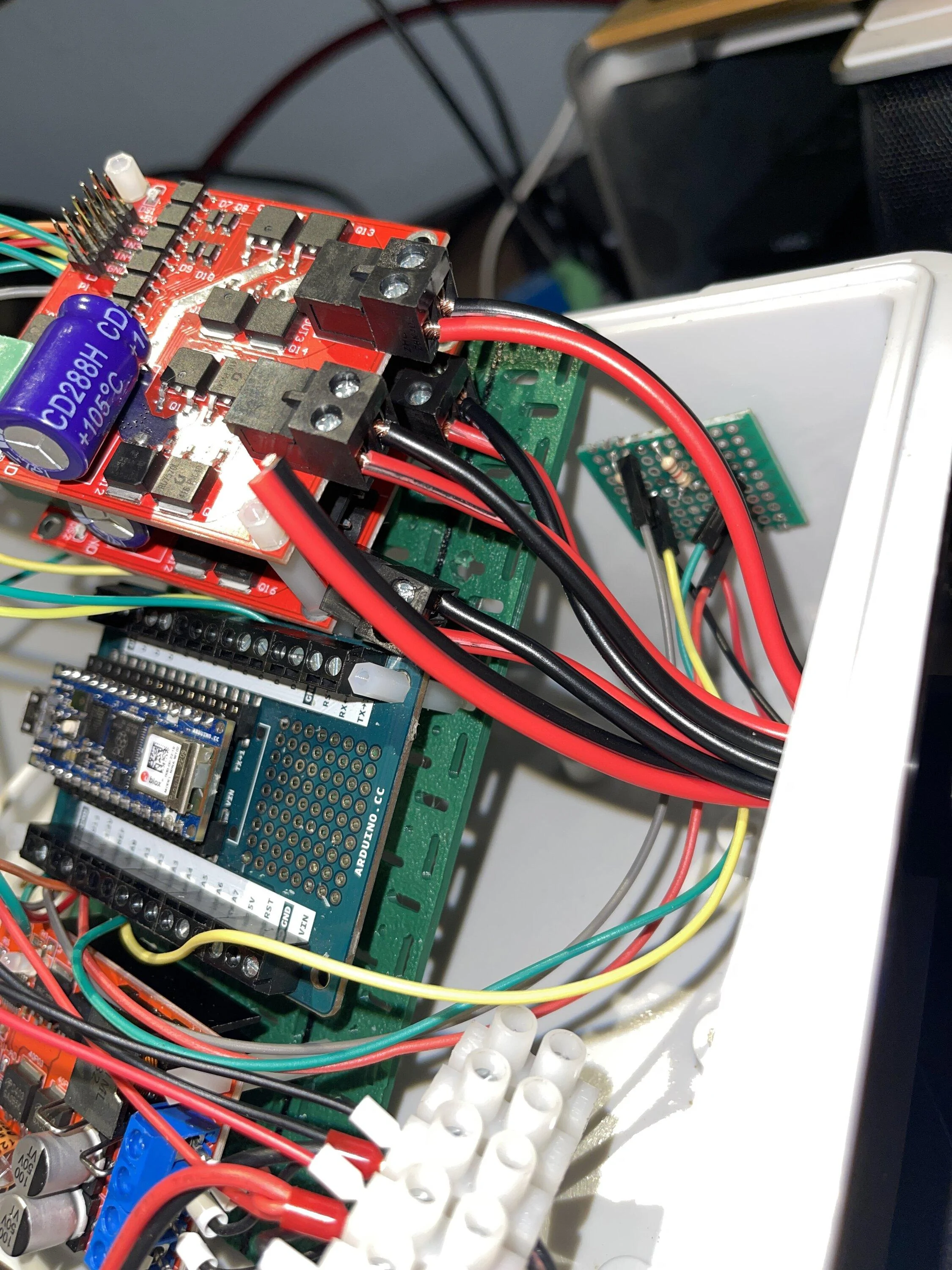

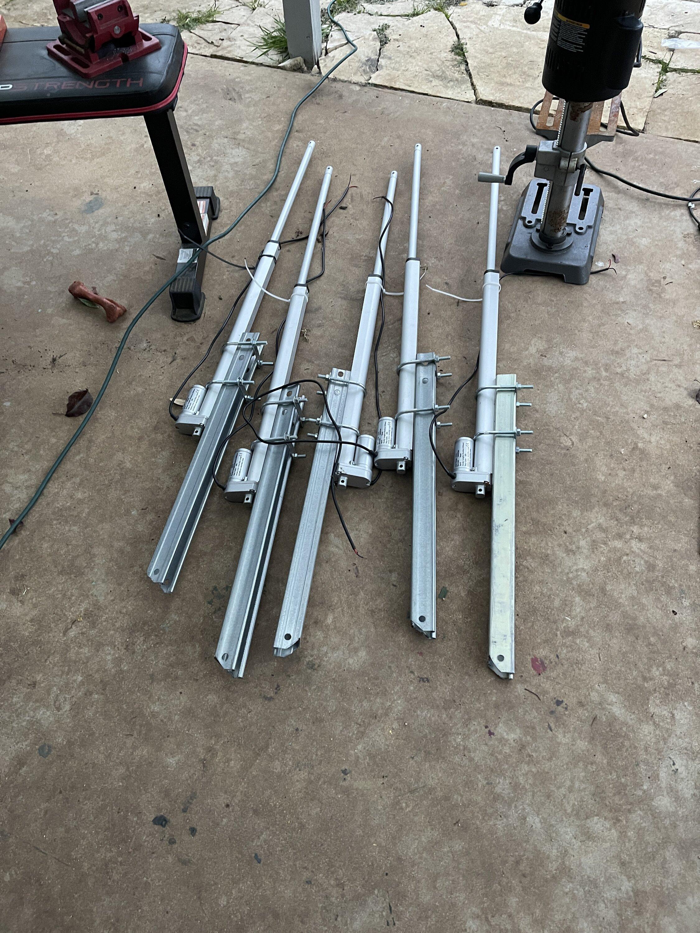

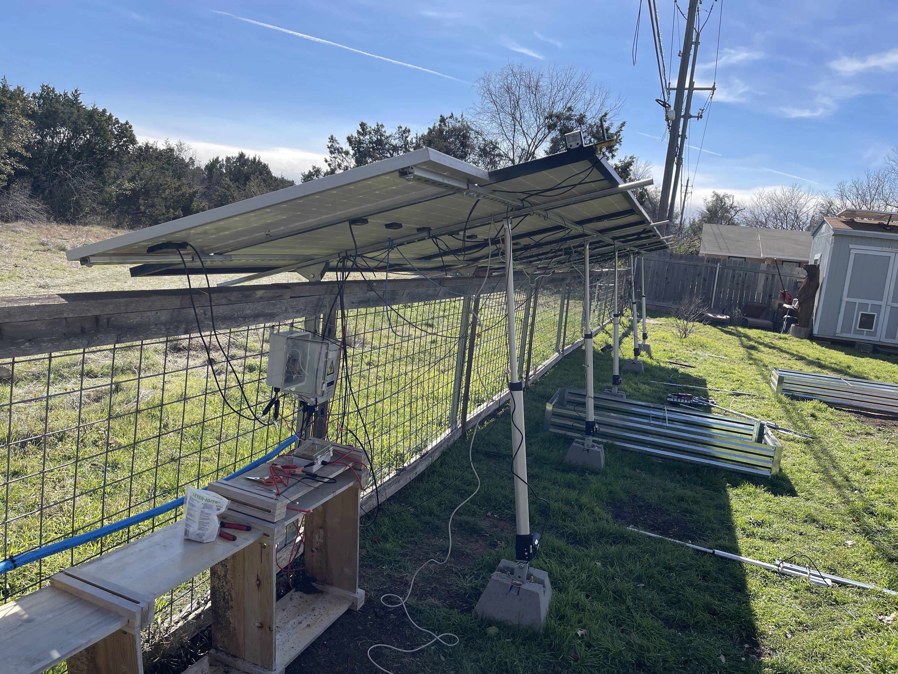

Got the Progressive Automations hall sensor linear actuators installed. I added another motor driver to the control box, and rewired the actuators with 16 gauge wiring, home runs to each actuator. When I tested the first one, it really didn't pull more amps than the ecoworthy, though. The main, noticeable difference is that these are nearly, entirely, silent. It's weird. You can really hear the ecoworthys when they are moving.
Ford F-150 Lightning Lightning off-grid charging Solar Array Build w/Agrivoltaics IMG_9957.JPG
Ford F-150 Lightning Lightning off-grid charging Solar Array Build w/Agrivoltaics IMG_9972.JPG

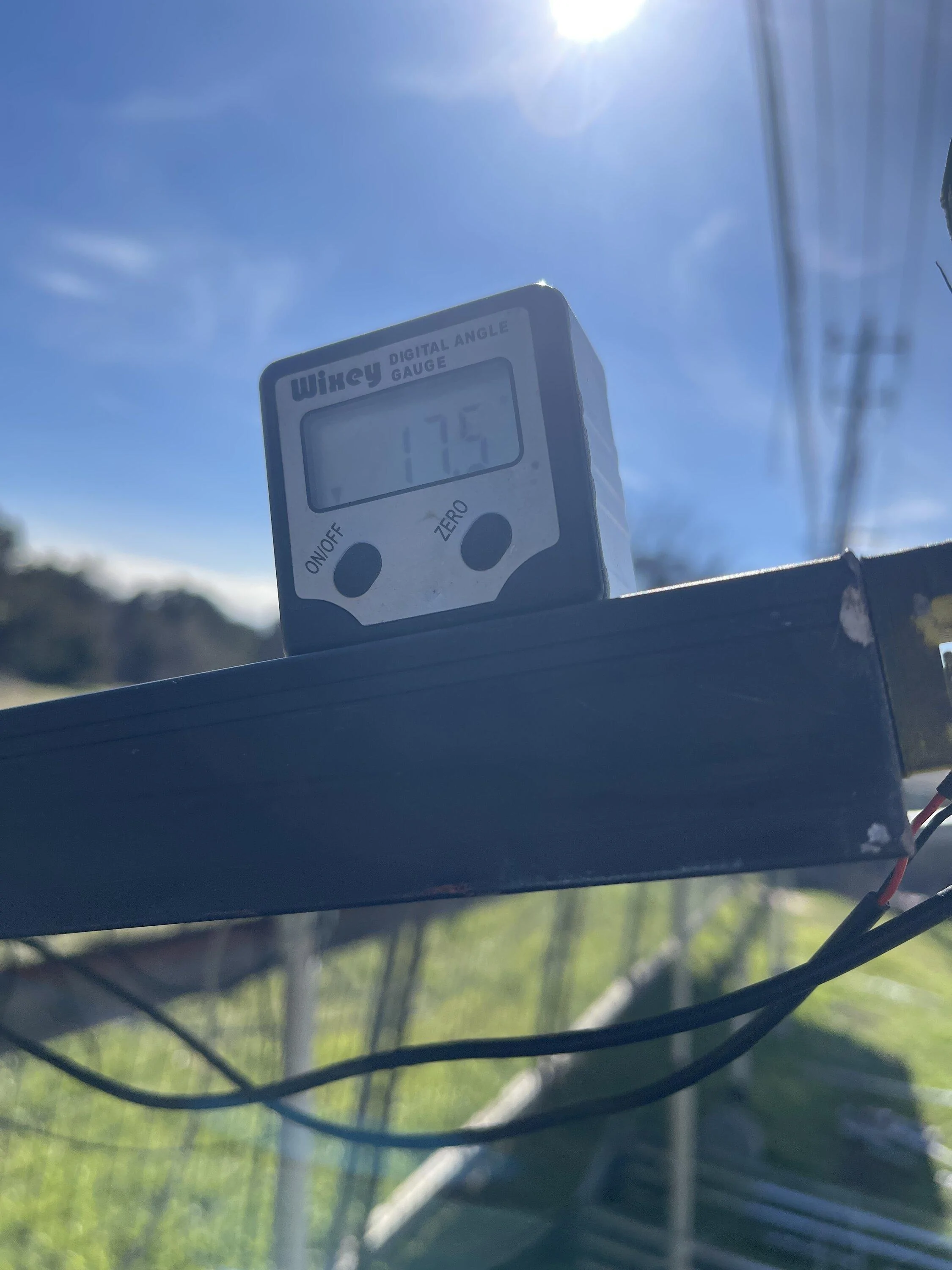

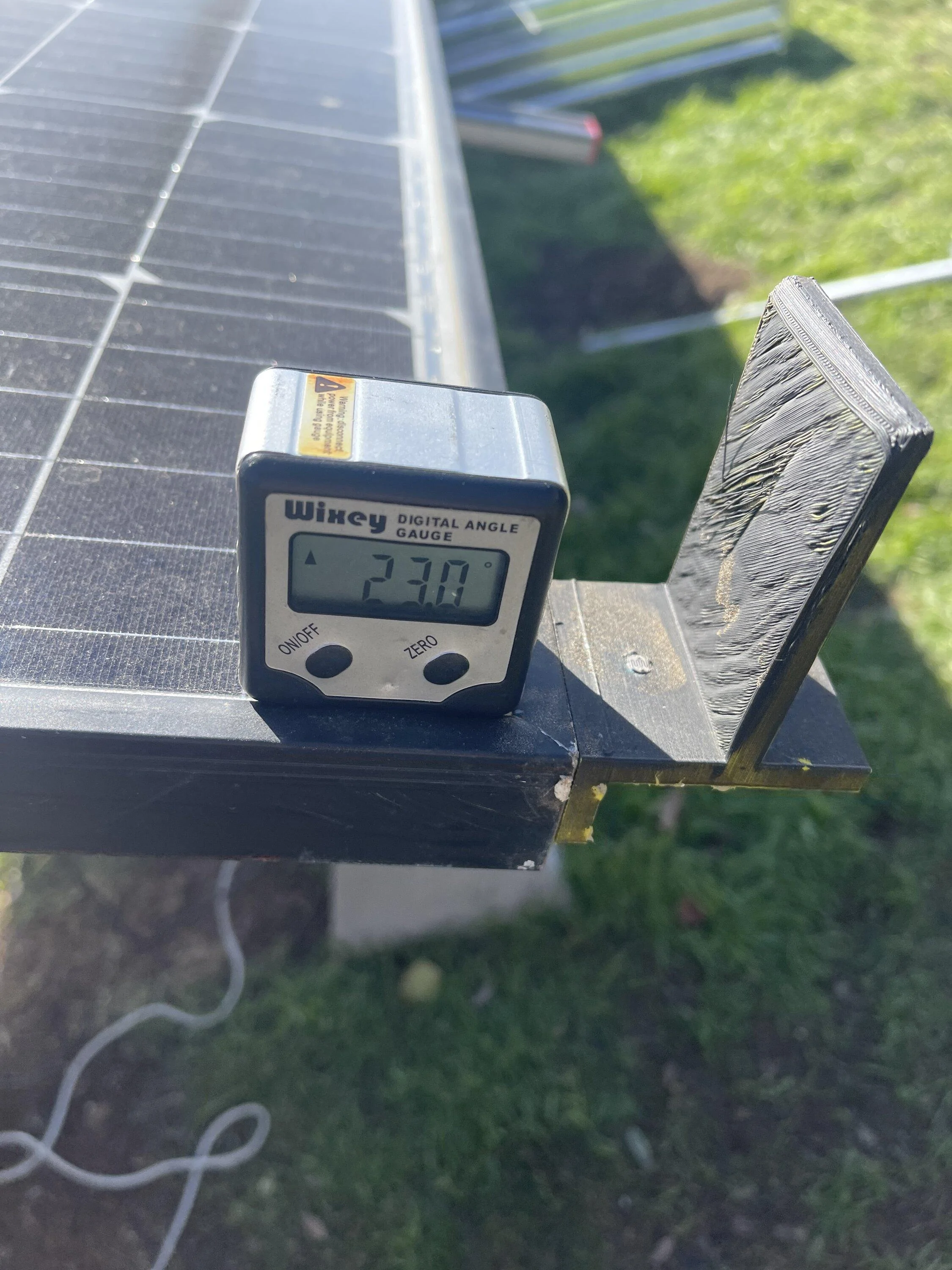

This, so far, with no tweaking, has resulted in an increase from 13.8 degrees early morning tilt, to 17.5 degrees, and from 15 degrees evening tilt max, to 23 degrees. We'll play with that, but I'll bet we'll see some increases in output, especially in the evening.

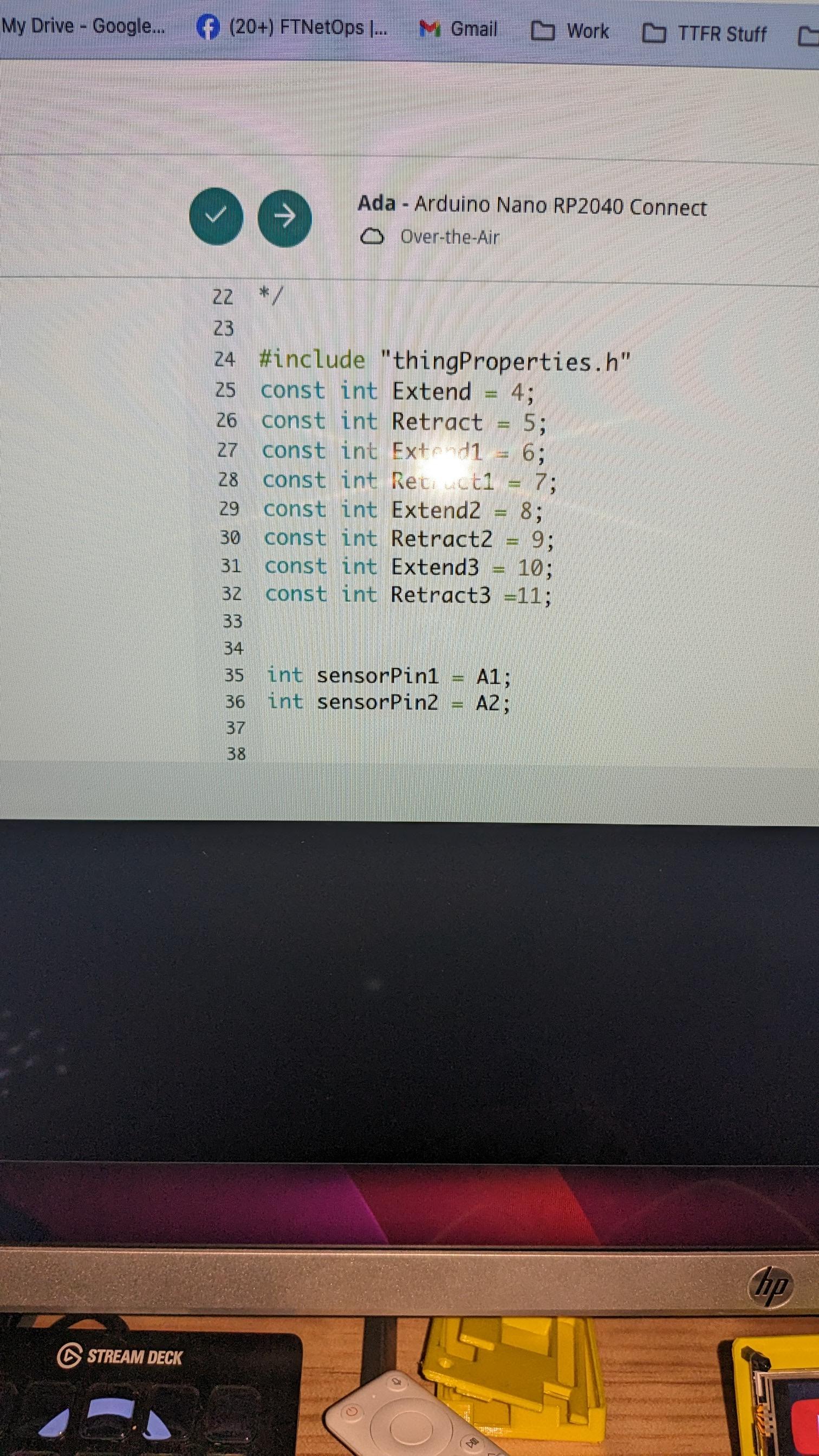

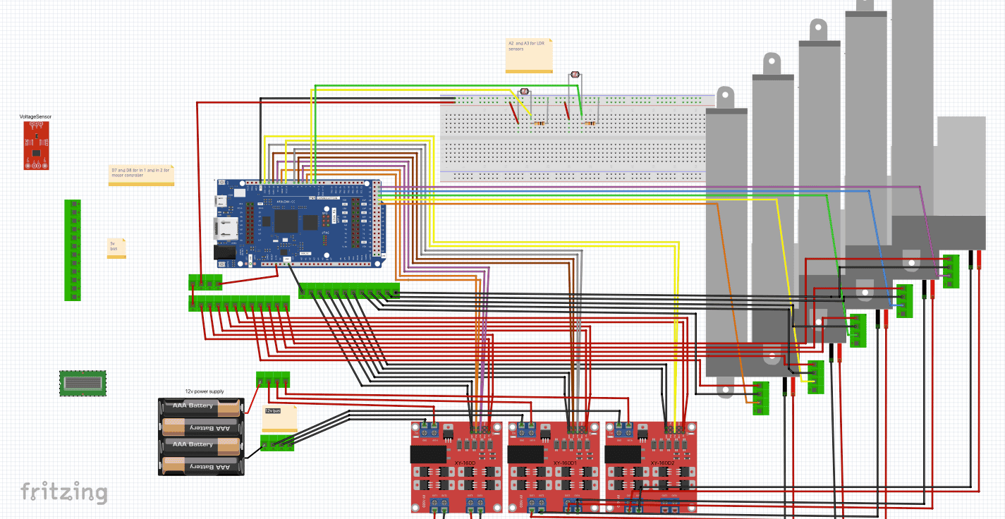

And the code adjustments( I know, ugly code with no comments...) and control box modifications. Still have to stack one more motor controller. These have two 8 amp outputs, so I need one more output for the 5 actuators.

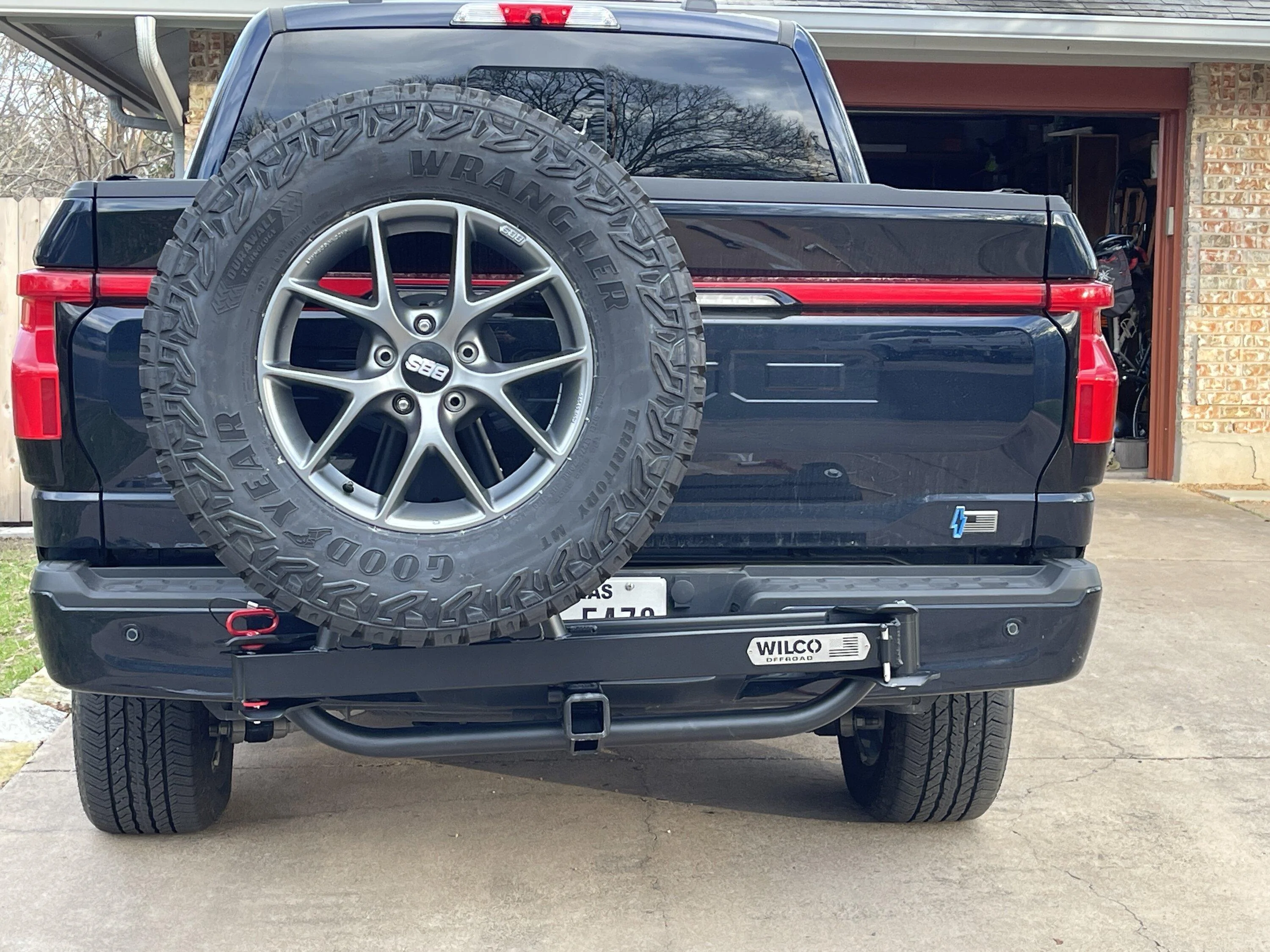

Test fit for it's Wilco Offroad, swing out tire carrier on the Lightning, though...

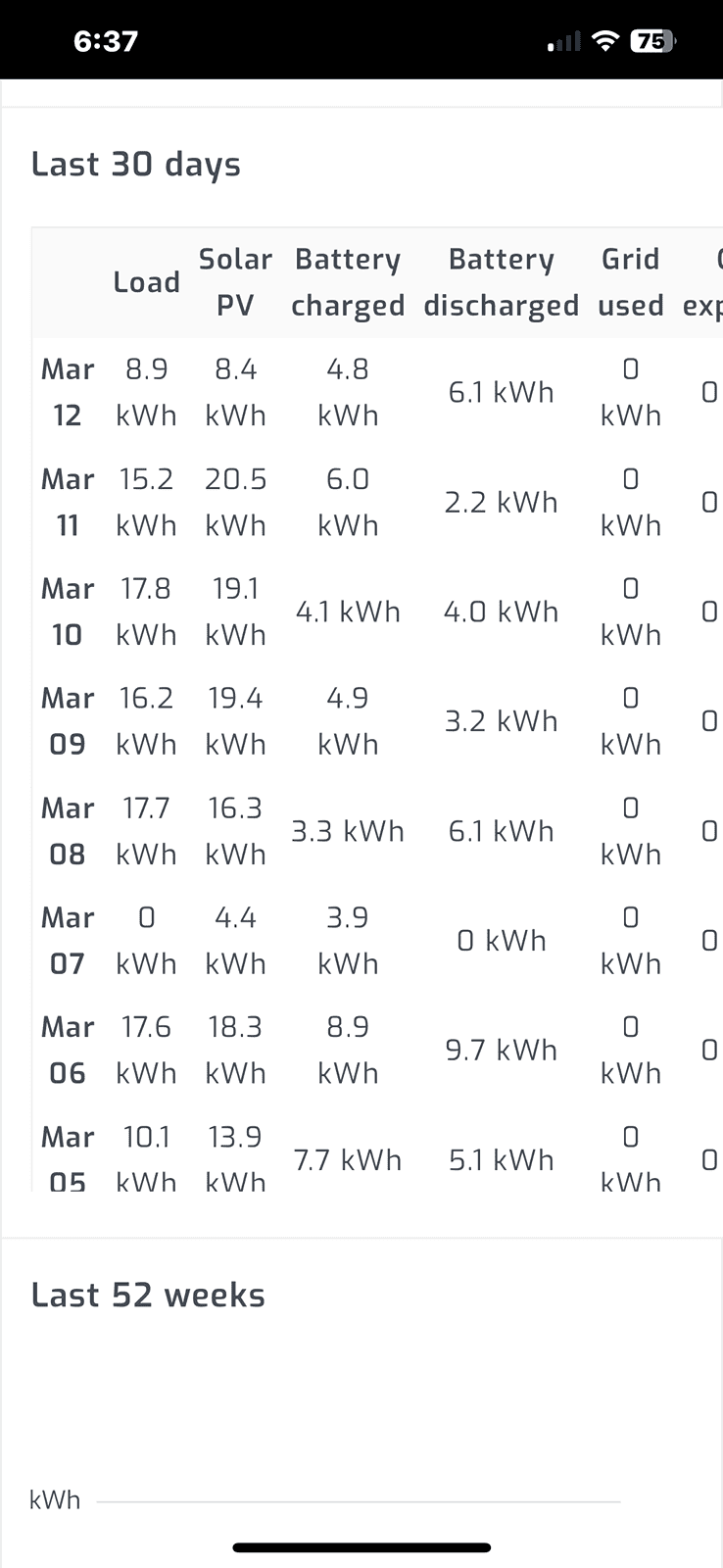

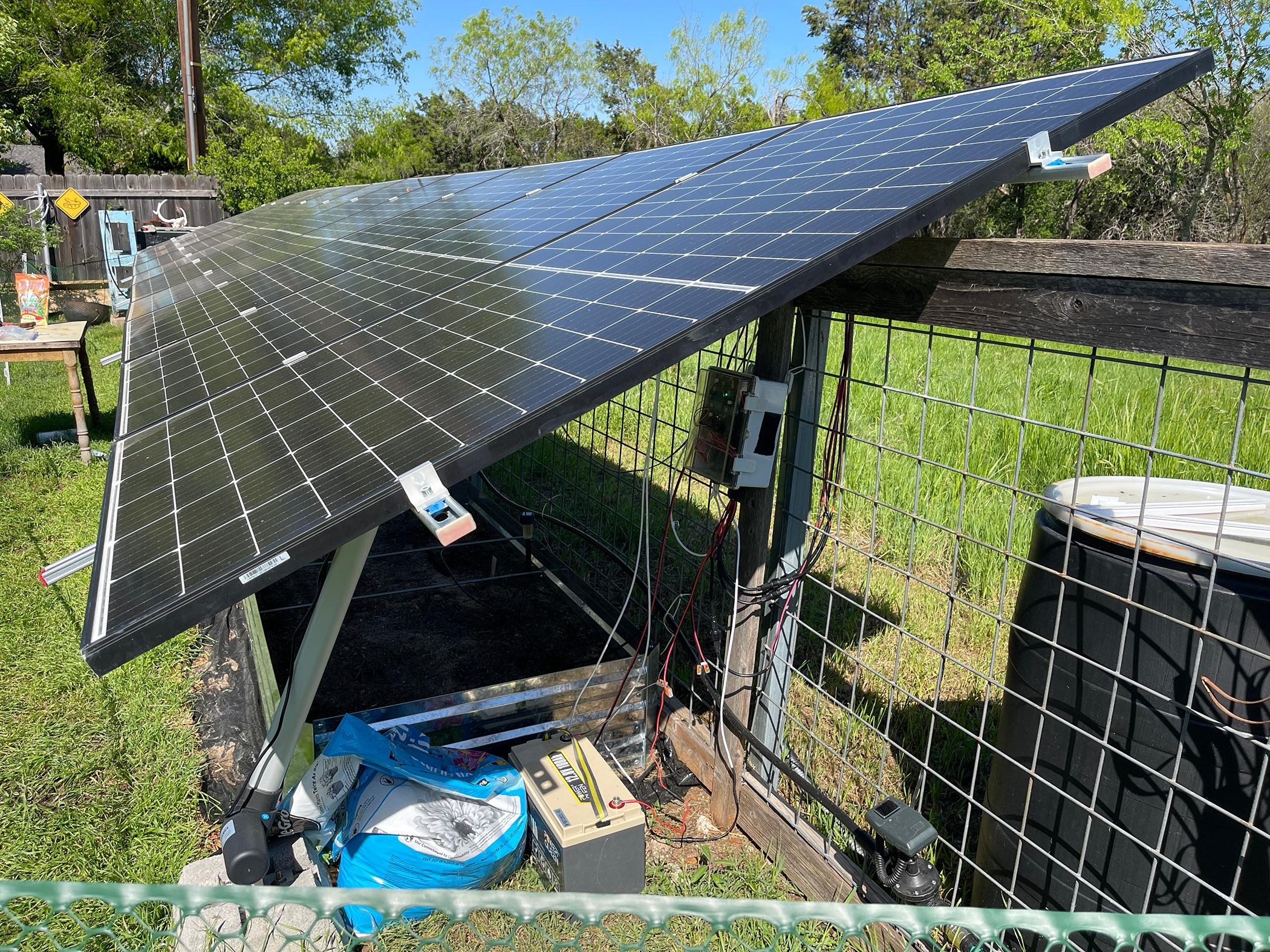

Making a tons of progress with raised beds installed, control box coding just about complete, and new records for output:
Crossed a signficant milestone of 20kw of output in a day on march 11th, and have been getting consistently high output and input:
Ford F-150 Lightning Lightning off-grid charging Solar Array Build w/Agrivoltaics IMG_0510.PNG

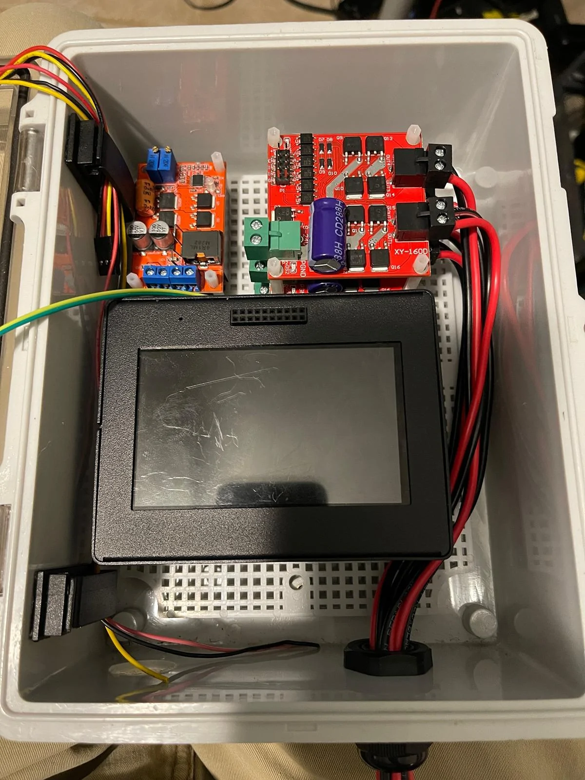

Control box now with an Arduino Giga R1 Wifi, and Giga Display in a case I found on Ebay:

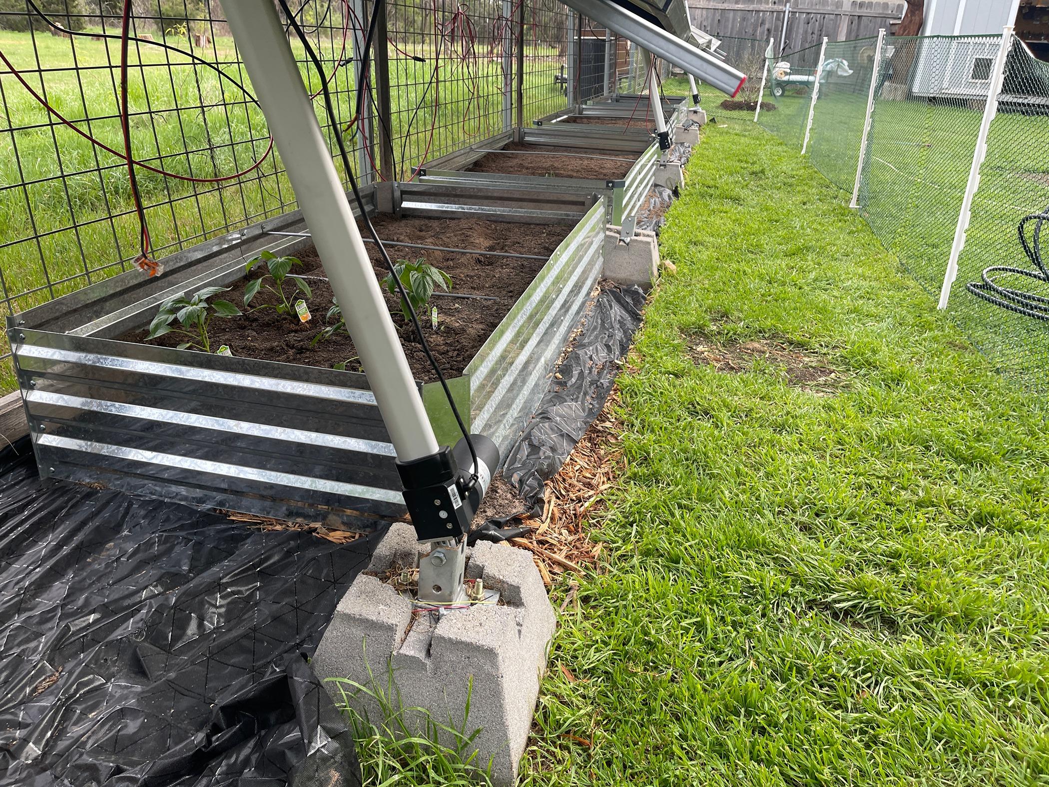

Beginning of the bed planting fenced off from our Curious mutts:
Ford F-150 Lightning Lightning off-grid charging Solar Array Build w/Agrivoltaics IMG_0468.JPG

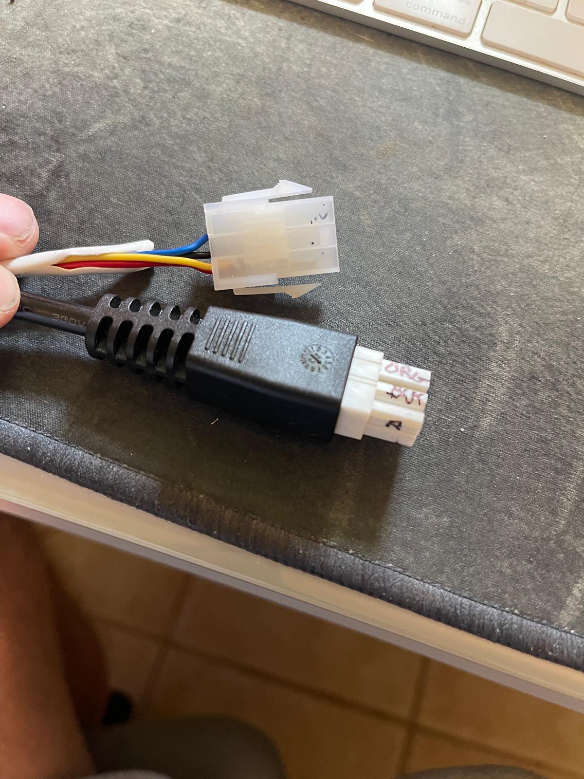

One of my least favorite parts of the project, making molex connectors...

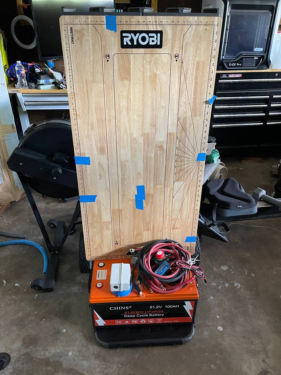

And the next project... Making at least some of this mobile with 30-40 flexible 100watt panels, and 10kw of batts, and a quick-disconnect system for the Hybrid inverter, or another one, to move to this trailer, which will be lifted a bit, and have a no-weld kit to build the frame up for Electric overlanding adventures:
https://compactcampingstore.com/collections/trailer-rack-kits
(need to finish the Audi Q7 overland conversion in the background first, though)
Ford F-150 Lightning Lightning off-grid charging Solar Array Build w/Agrivoltaics IMG_0513.JPG

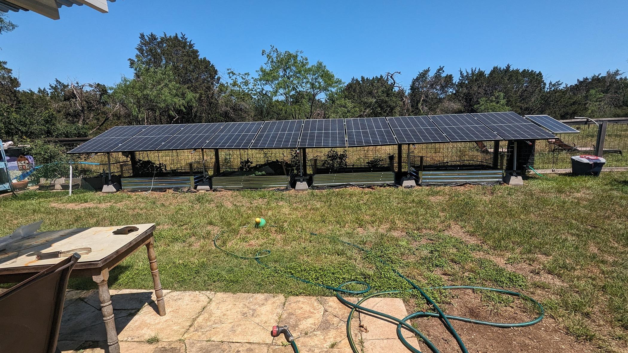

Getting pretty close to complete. Implementing some gutters to feed the rainbarrel in the foreground, moving the 100watt panel that powers the control box over to this side, and then getting the automated microcontroller controlled watering going, and then it's just waiting for harvesting!
Ford F-150 Lightning Lightning off-grid charging Solar Array Build w/Agrivoltaics IMG_0608.JPG

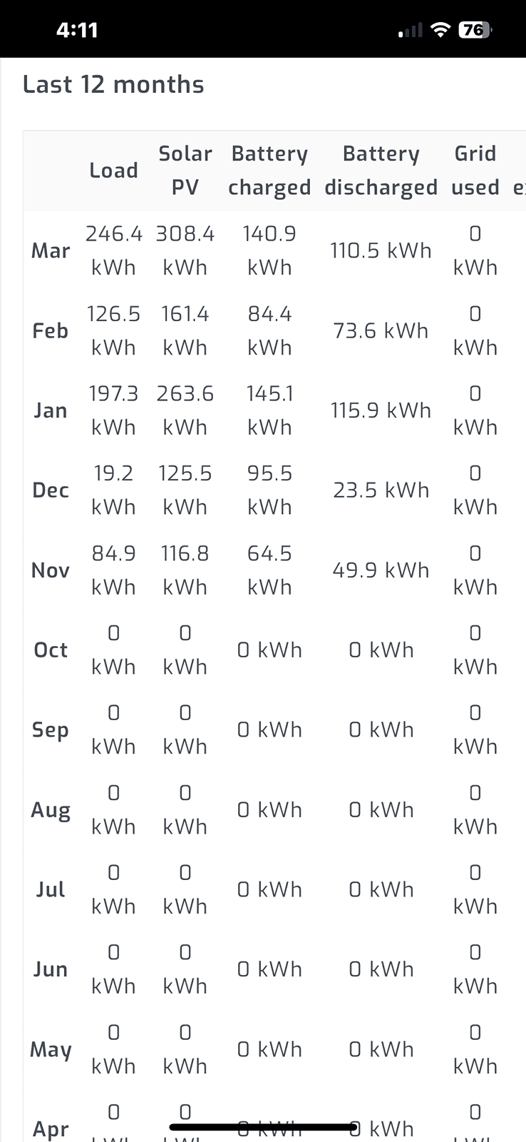

Producing more than expected. Hitting 3kW peak during the days now, and went over 300kW for the month with only sporadic use at times and lost the 100kW we put in with the chargepoint quick charger:

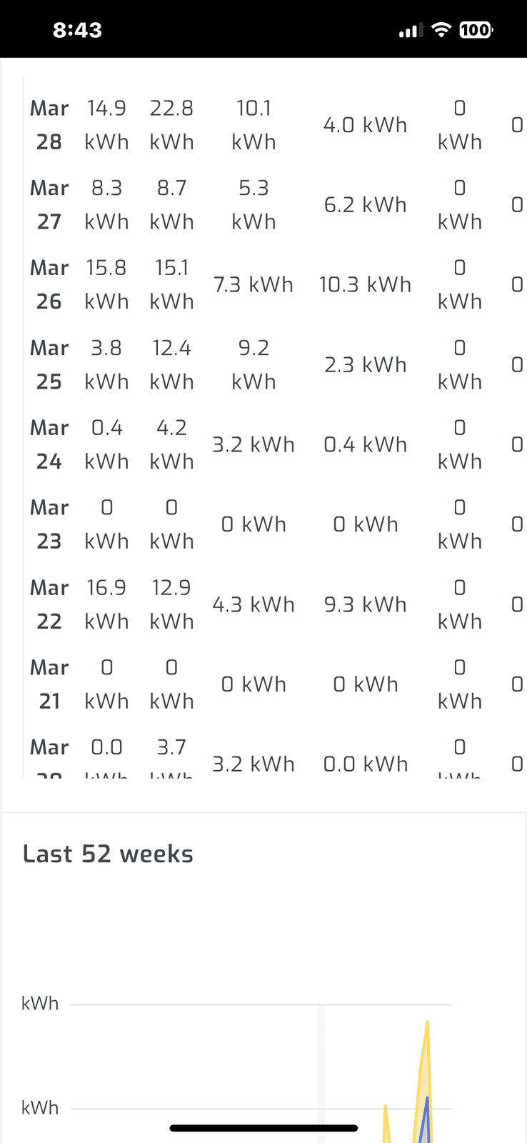

And broke a daily production record by over 10% yesterday...
That's the benefit of the automatic tracking which is just back up and operational.

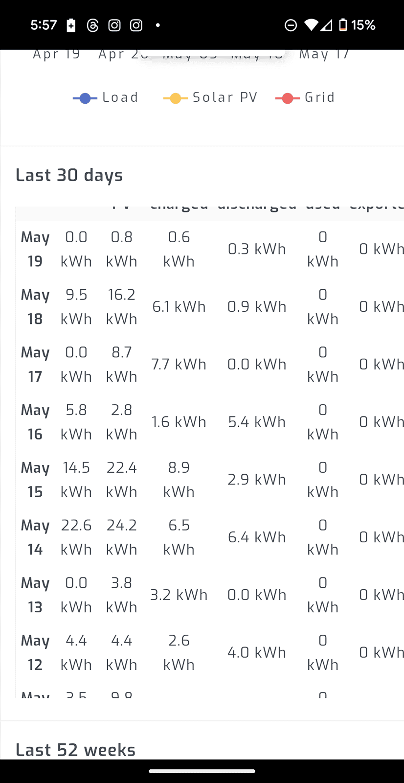

Hadn't had much to post that was new, but started another phase of the project and broke another record for production.
Hit went over 24kw in a day for the first time, which at the beginning of the thread, I think someone mentioned they drove 48 miles in a day, which this would now cover(with some additional battery storage, as we only have 10kw, but soon will have 20kw.
Ford F-150 Lightning Lightning off-grid charging Solar Array Build w/Agrivoltaics Screenshot_20240519-175758

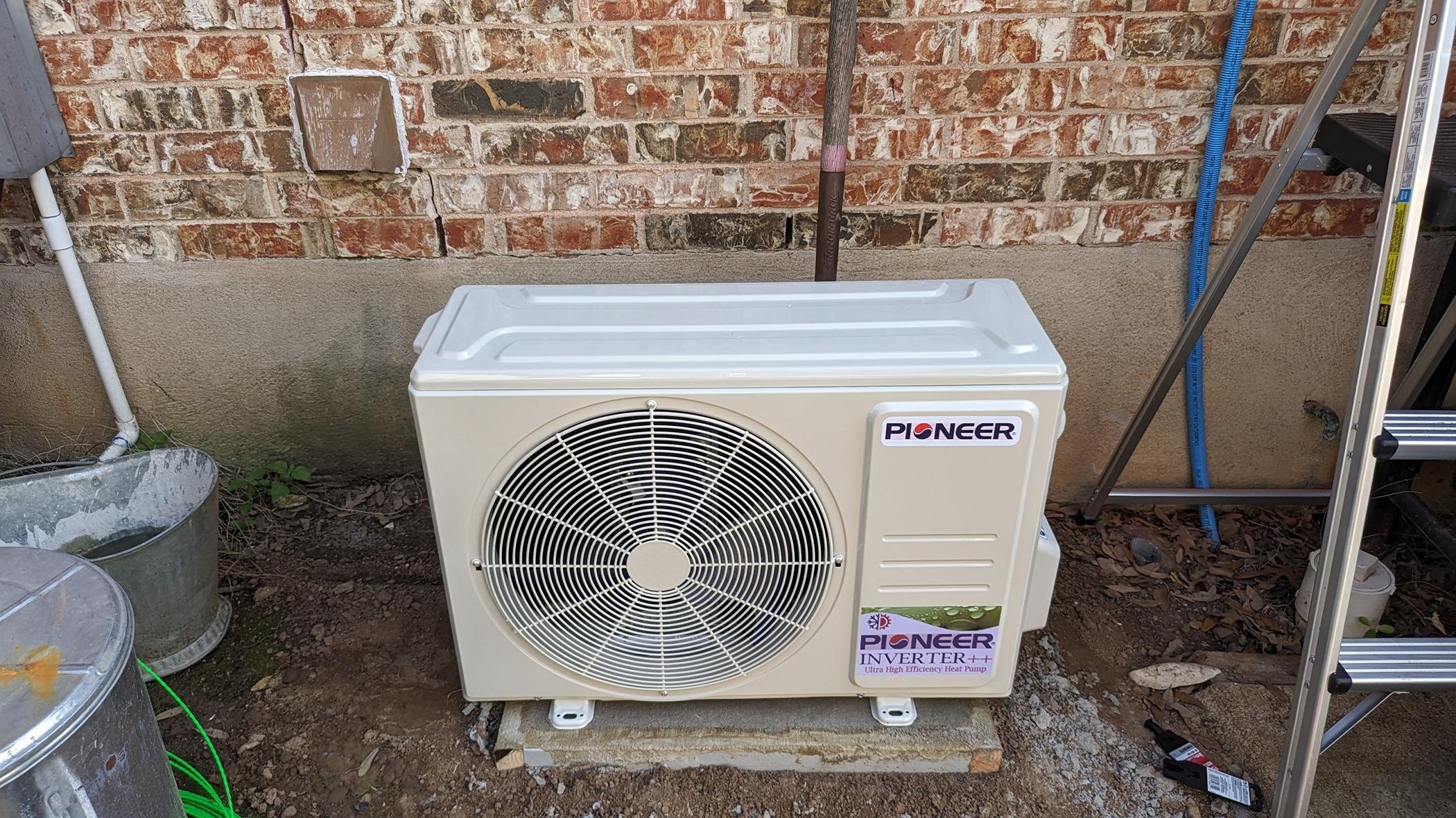

And now we'll use the rest of the output now, and I'll have a cool mancave, which will eventually pay for itself.
12k Btu Pioneer 23 seer.
Ford F-150 Lightning Lightning off-grid charging Solar Array Build w/Agrivoltaics PXL_20240519_225153571

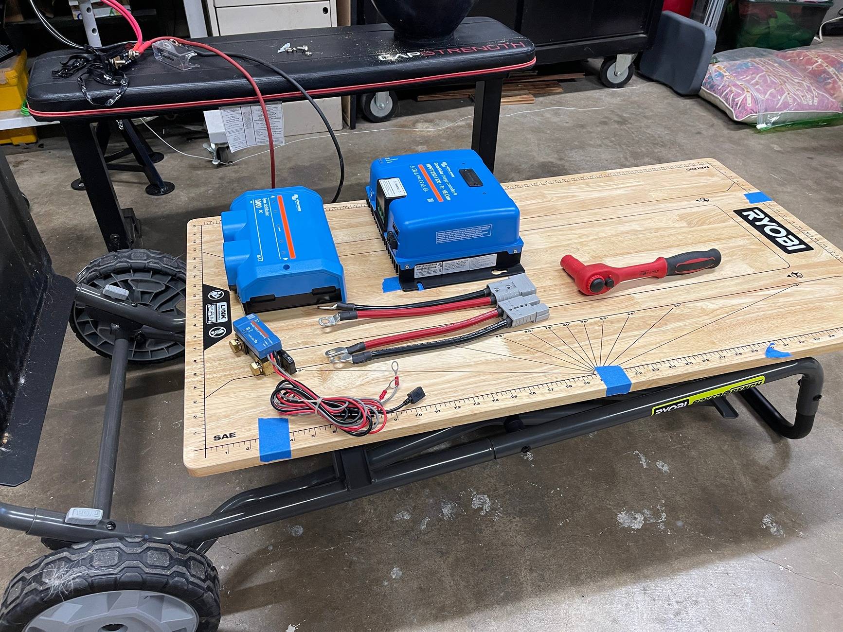

Impatiently waiting on UPS for the Inverter/Chargers.
Already testing the charge controller.
