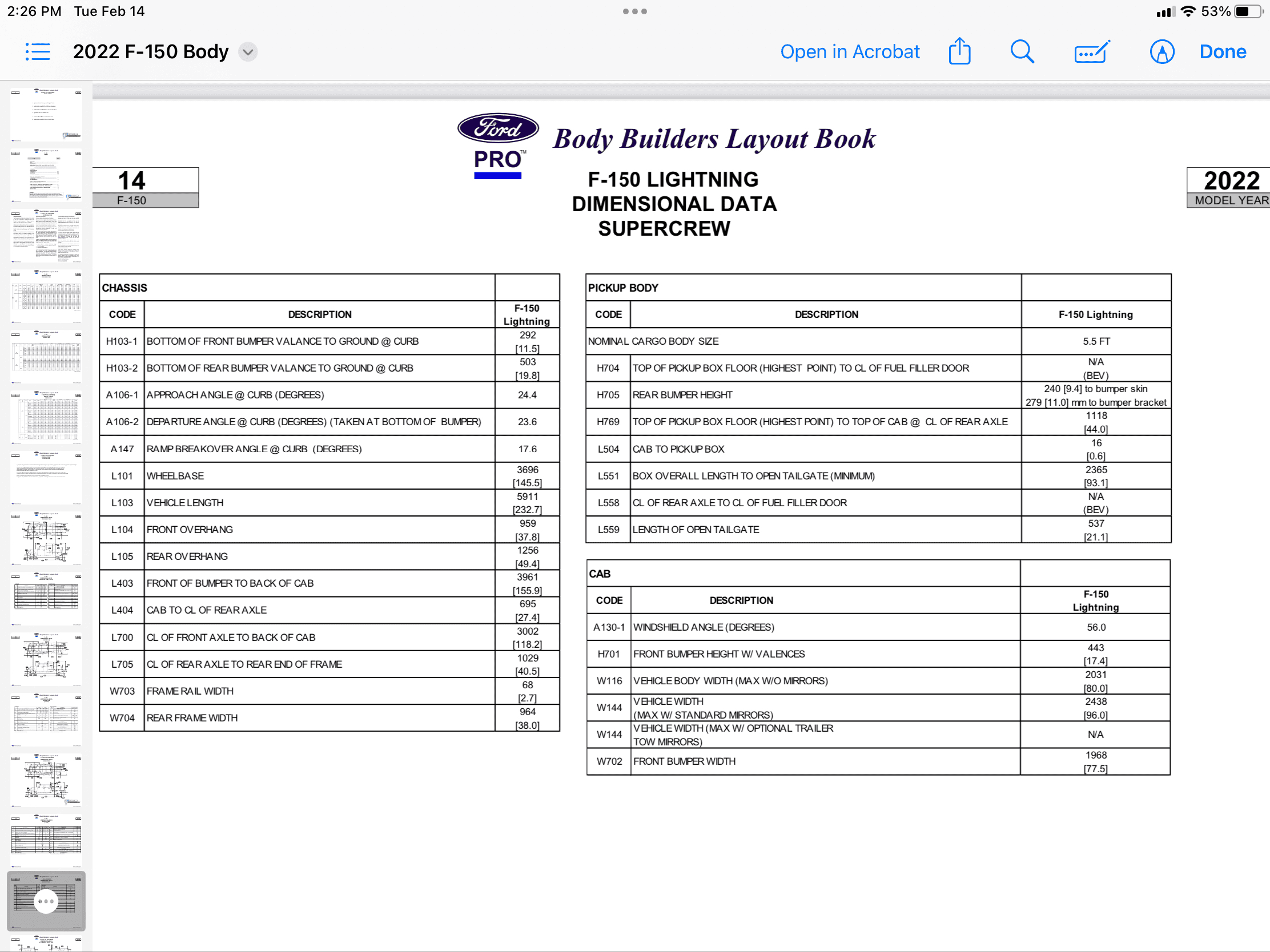

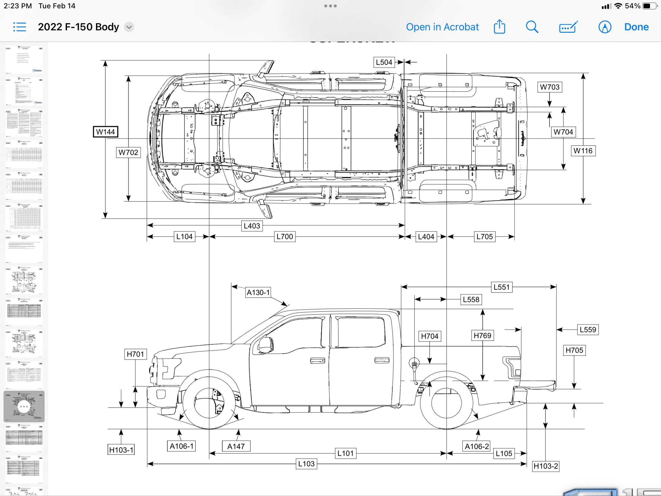

Look at these
PERFECT! The blueprint, that's what I searched for and couldn't find, but it's not showing the dimension I'm looking for. but if no one else can give me the front to door hinge measurement, I might be able to derive it from these drawings.

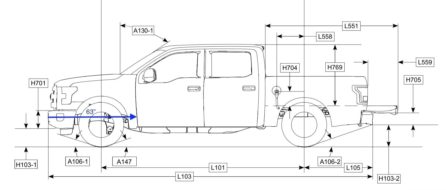

I get 63" with the license plate holder (holder is about an inch with the license plate and trim ring).
Thank you much! that's exactly what I need. My Avalanche is about the same so I'll just have to deal with the extra foot being all at the rear. It will work!
