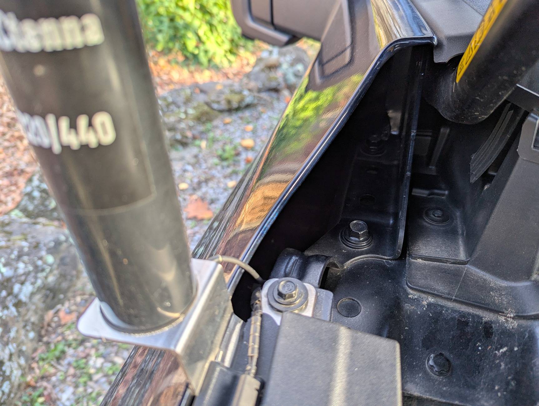

This message is generally for amateur radio operators. I'm trying to attach a 2M/UHF antenna to my 2023 Lightning XLT. A mag mount is a no-go as it won't stick to any surfaces. DX Engineering and others make an angle bracket that attaches to a 10 mm bolt on the driver's side finder. I just looked carefully at that area and I found the bolt but there is a plastic channel that comes right up to the bolt with a cable running through it. I guess that's so the frunk can be opened via the fob.
Any hams out there? How did you mount your antennas?

priceb
Price
May 31, 2023
75
Western North Carolina
2023 F150 Lightning XLT
College Instructor
Alan Rovner
Alan
Jun 10, 2023
Vancouver, WA
Thanks Price that's a great tip. I didn't think about cutting back the plastic trim. Have to be careful with that wire running thought it. I'll lookup the parts you used.
