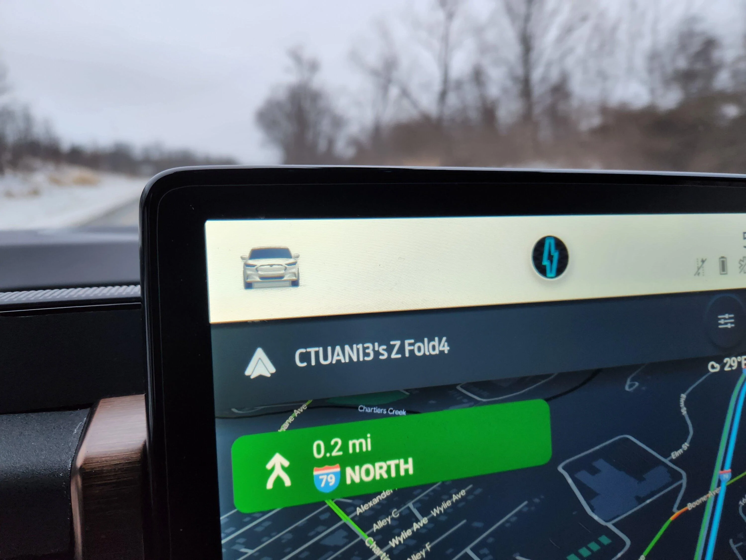

So although I've otherwise had zero issues with my Lightning, I've had a persistent 12V battery draining issue that results in the truck going into deep sleep after at most three days sitting idle.
With the cold weather I experienced some peculiar issues yesterday. After driving and parking at my destination for four hours, when I got back to the truck it was clearly in "deep sleep". No approach lighting, screens dark upon opening the door and chime only emitting from dash speaker on startup.

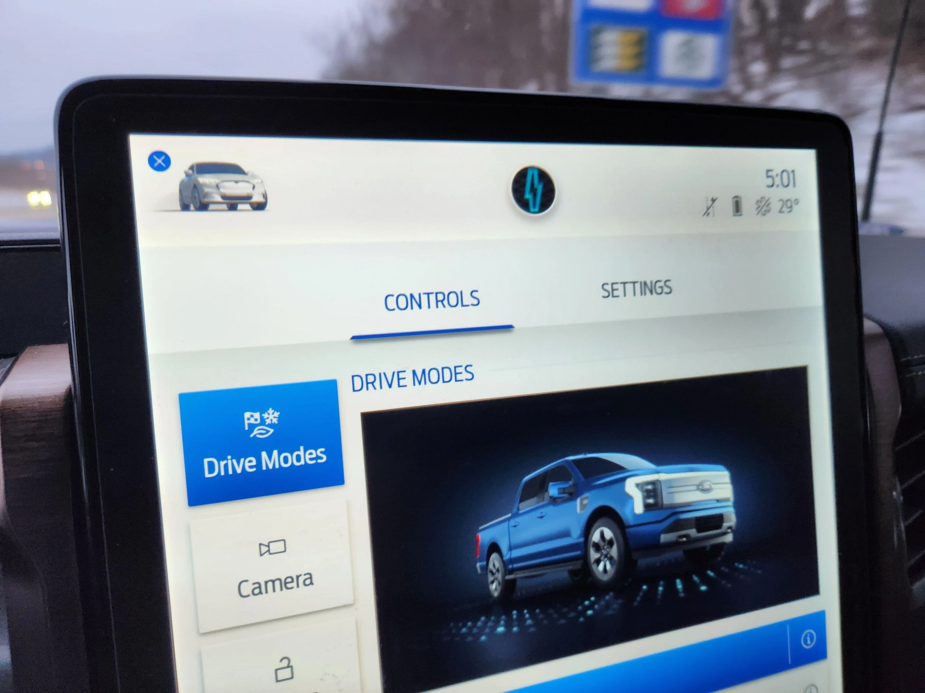

But the weirdest issues took a minute or two of driving before I actually noticed. The icon for the settings menu was displaying a white Mach-E even after forcing a reboot on the Sync system (pictured below) and the GOM was wildly inaccurate with the number rising and falling by several miles every 10-15 seconds (didn't manage to get a picture or video of this) and the percentage seemed to be falling alarmingly fast (ie somewhere around 15% in 5 minutes of highway driving.
So I pulled over and disconnected the 12V battery for a minute, reconnected and this solved the issues, but still annoying to have repeated 12V battery issues, though this is the first time I've experienced this sort of major glitch, usually the only symptom is a persistent "deep sleep" that persists through several key cycles.

Is your 12 volt battery up to proper charge? That is weird that unplugging the 12v battery "fixed" the problem. I would make sure the battery is at adequate voltage and also see if you have something that is draining your 12v battery. I would just take it to your dealer and have him look at it under the warranty.

Well at that point it wasn't up to perfect charge (I was monitoring the 12v battery parameters using an OBDII dongle) but it charges up normally during a drive and sometimes when I can ill throw a charger on it when I plan to park it for more than a day or so.
But it's odd because definitely, I can see using the wireless OBDII dongle that often after shutting off the truck, there continues to be a draw on the battery. It starts at 25A, then drops to 20A, then 16A, then 11A and finally after 15 minutes it'll drop to 6A, but it never seems to cease entirely or at least not while I'm monitoring it. But obviously while charging the main battery pack, the DC-DC converter is charging the 12V and also while the truck is on.
What's interesting is that even though initially thought it was just some sort of failed component static parasitic draw. If I disconnect and reconnect the 12V battery, the parasitic draw dissapears...at least until I open a door or start and shut off the truck.
But yeah I guess I'll have to bring it to a dealer at some point. Just odd because despite other incidents of 12V battery issues, I've never experienced a software glitch quite like that!

Yes. That constant draw is coming from somewhere. I would definitely let the dealer service people look at it. I'm thinking it's something simple going on and hopefully a simple fix. I wouldn't rule out the 12v battery needs replacing.
