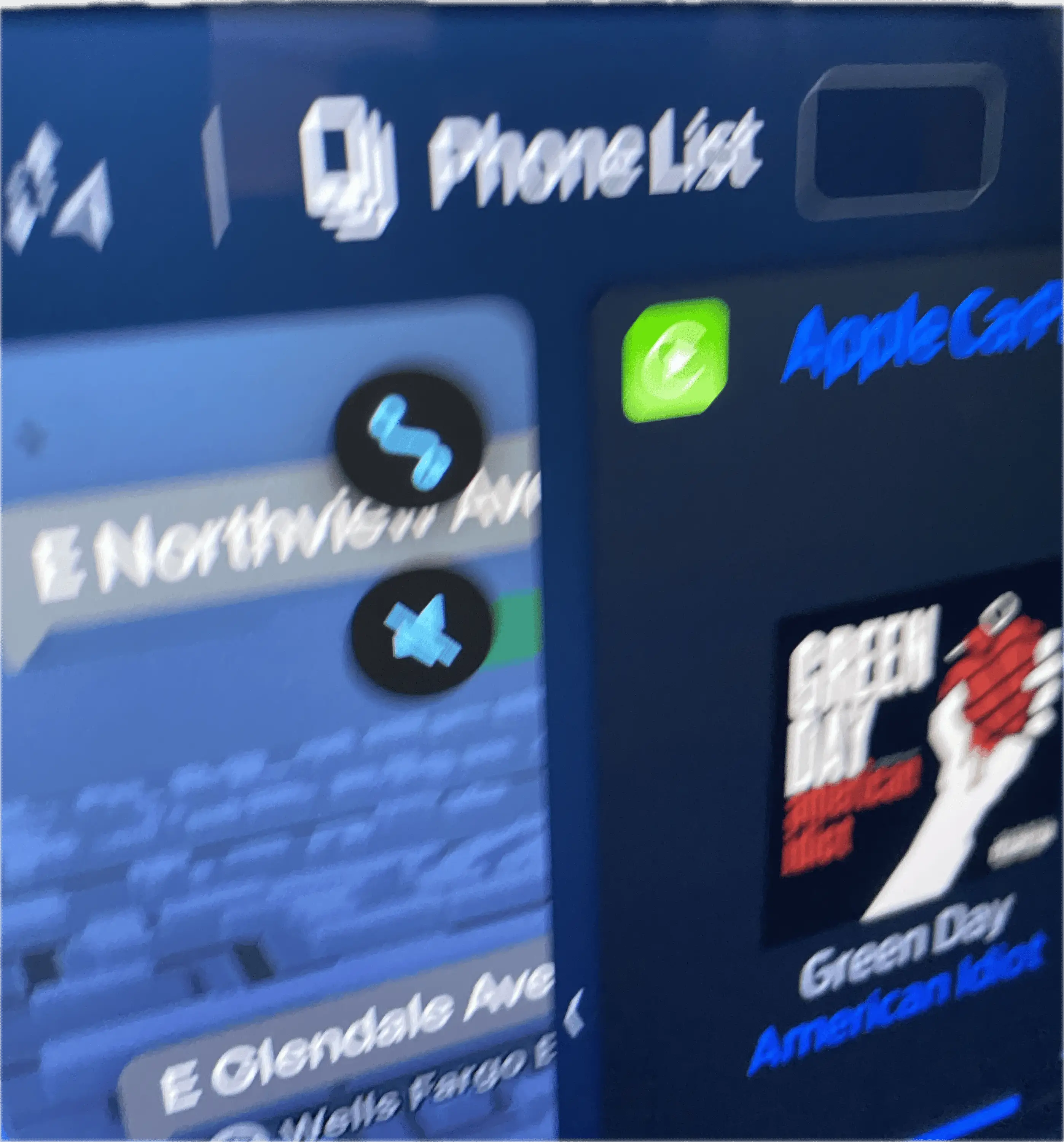

I might have you figured out @Konakid .
Assuming you’re using Apple Maps and car play. Set a destination. Then if it still has UI buttons up (they disappear after a bit, tap the screen to get them back) you’ll see one in the upper right that is a speaker with the line through it.
Ford F-150 Lightning Navigation directions from phone silenced while in truck. 1705539962385
tap that bad boy and you can choose between full audio or just alerts. Forgive the screen shot fuzziness but it gets the point across. Your view may be slightly different in a lariat or platinum.
