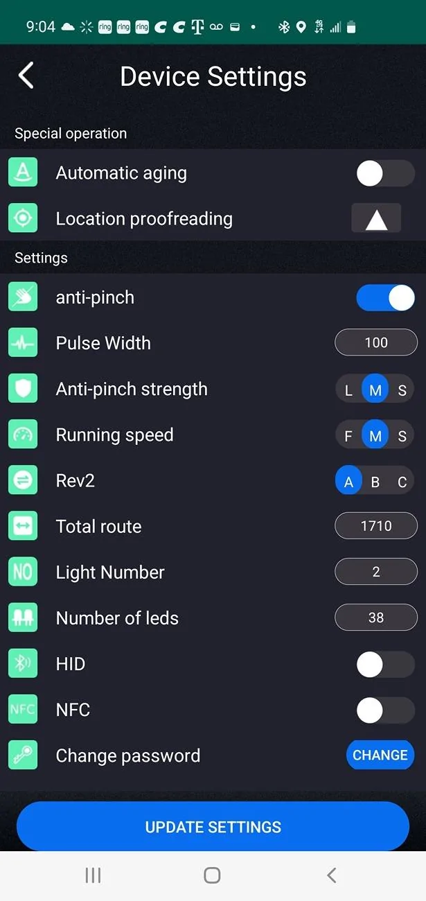

Here is a photo of the settings. Of course the limited instructions that are included with the cover never got into setting up these variables. Just how to mount the cover.
The manufacturer has been good at trying to resolve my concerns, but later found out that power can't be disconnected from the cover. Who knew a cover is this involved and more than just fixed limit switches designed specifically for our f150's bed length.
