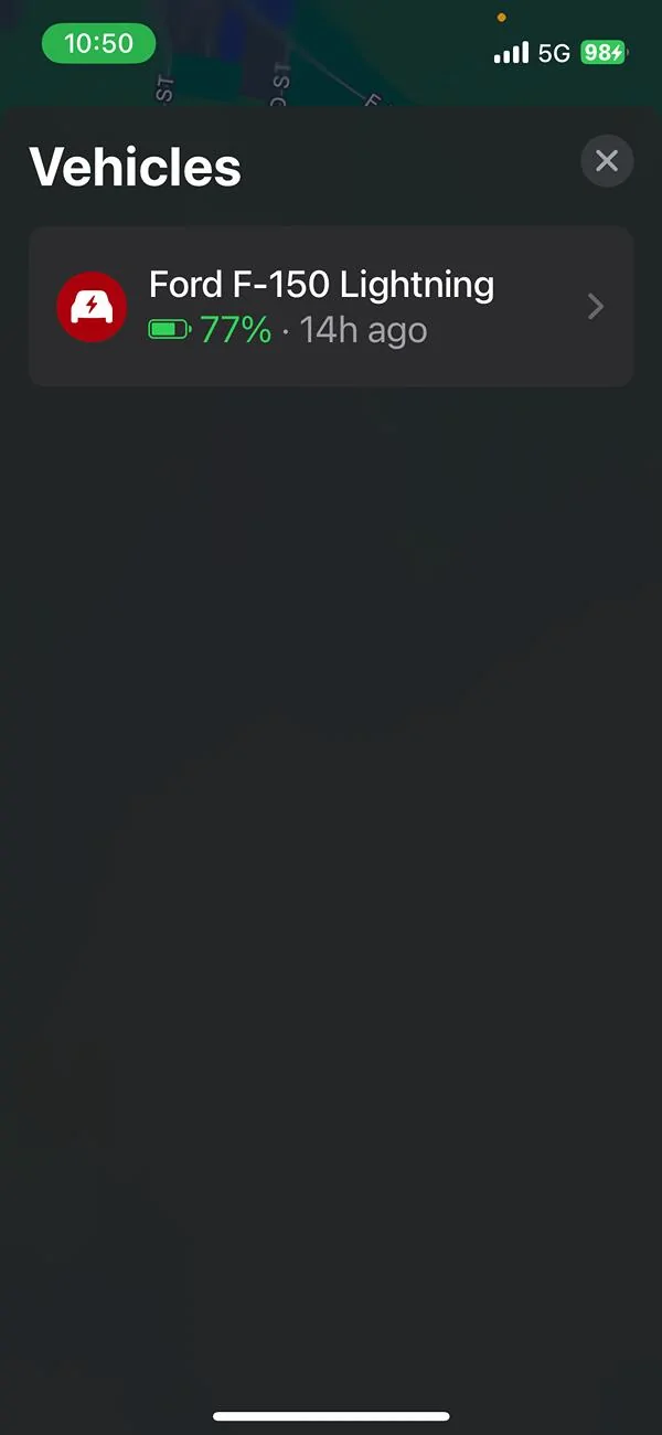

Apple Maps EV routing will just work. Update your iPhone, in the Apple Maps app settings select your profile and add your car and select your charging network to Tesla Supercharger ( you might get an adapter from Amazon for the conversion, unless your dealer gave you one).
You might have some Apple Maps settings that require the CarPlay to be connected.
I use the Blue Oval charging network from Ford and Tesla is plug and charge.
