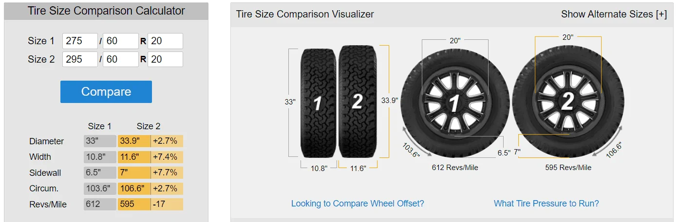

As with any wheel, of any size, your not going to want to beat it like a rented mule. I would not have any reservations about the 20" wheel being tough enough for what it sounds like you are going to be doing with the truck. I would suggest going with an all-terrain tire of your choice, but in a bit more robust size. I am taking off my 275/60-20's and replacing them with 295/60-20's. That is going to result 1.5" of sidewall height and about an 1" of increased width. An inch doesn't seem like much when you look at it on a tape measure, but that additional bulge will protect the wheels better when both inflated and give you more tire contact when underinflated (also more protection).
It is my understanding that a 295/60 will fit without leveling, but if your concerned, you could go with the factory size or bump up to a 285/60 or 275/65 tire and be good to go.

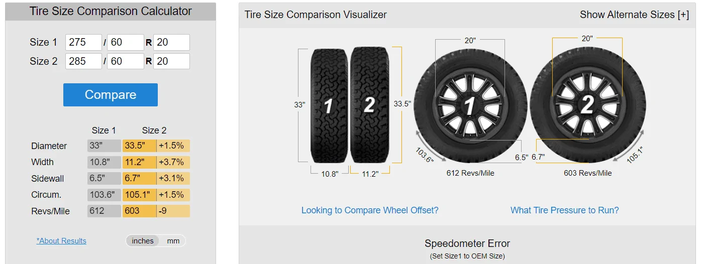

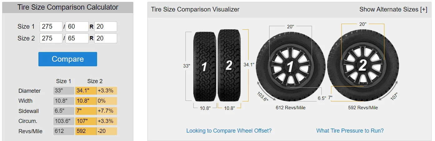

Excuse my ignorance new to all this, just got 2021 XLT , XLT Sport, want to add beefier tires but NOT level or lift etc,,, stock is 275/60/r20,,,,,,,,, so you mention one could add 285/65/20 (thinking of BF Goodrich Ko2),, and NOT level or lift and NO rubbing???? THanks,,,
Here are some comparison numbers 'Stock vs. Alternate Size'. In my early post, I believe I fat fingered the 285/65, that number should have been 275/65. I will correct it. It is possible it could fit, those are big wheel wells, but I can't say for sure.
I would consult your tire purveyor as to potential rub of any size you choose. I'm adding a 2" level, so my options are bit more open. Shop all the applicable sizes, as some sizes cost significantly more or less.

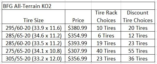

To circle back on my comments above, below is a chart based on Tire Rack/Discount Tire pricing, which shows size, price, and available tire choices (Nitto, Falken, Yokahama, ect). I used BFG's as my base for pricing, as most folk are very familiar with those. This chart also serves as a reminder to price check your local dealer to get the best deal.

Thanks so much @05RubiconLJ for these charts. They are incredibly helpful and much appreciated. Here at my local tire shops, the K02 285/60/20's are $100 cheaper per tire than the 295/60/20's. Crazy. Currently I'm in the research phase - factoring in change in feel, mileage, longevity and of course look to my stock tires.

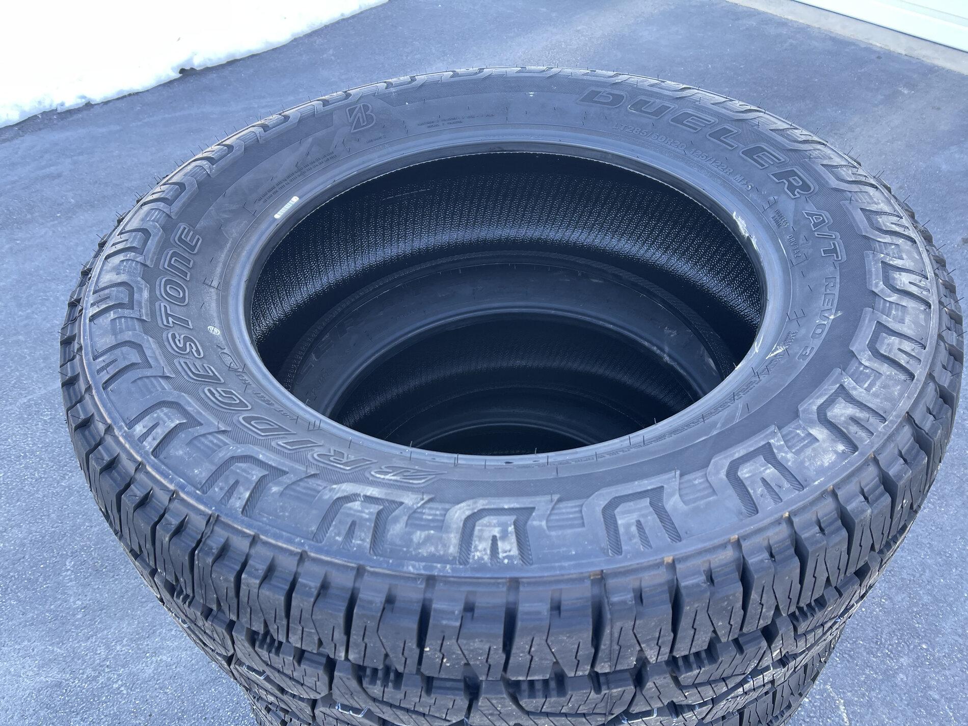

Just grabbed my tires today, going on Tuesday with a slightly larger 285/60/20 on stock Lariat chrome wheel and no leveling kit...I like the look of the Dueler and also it won't give up much ride quality.
