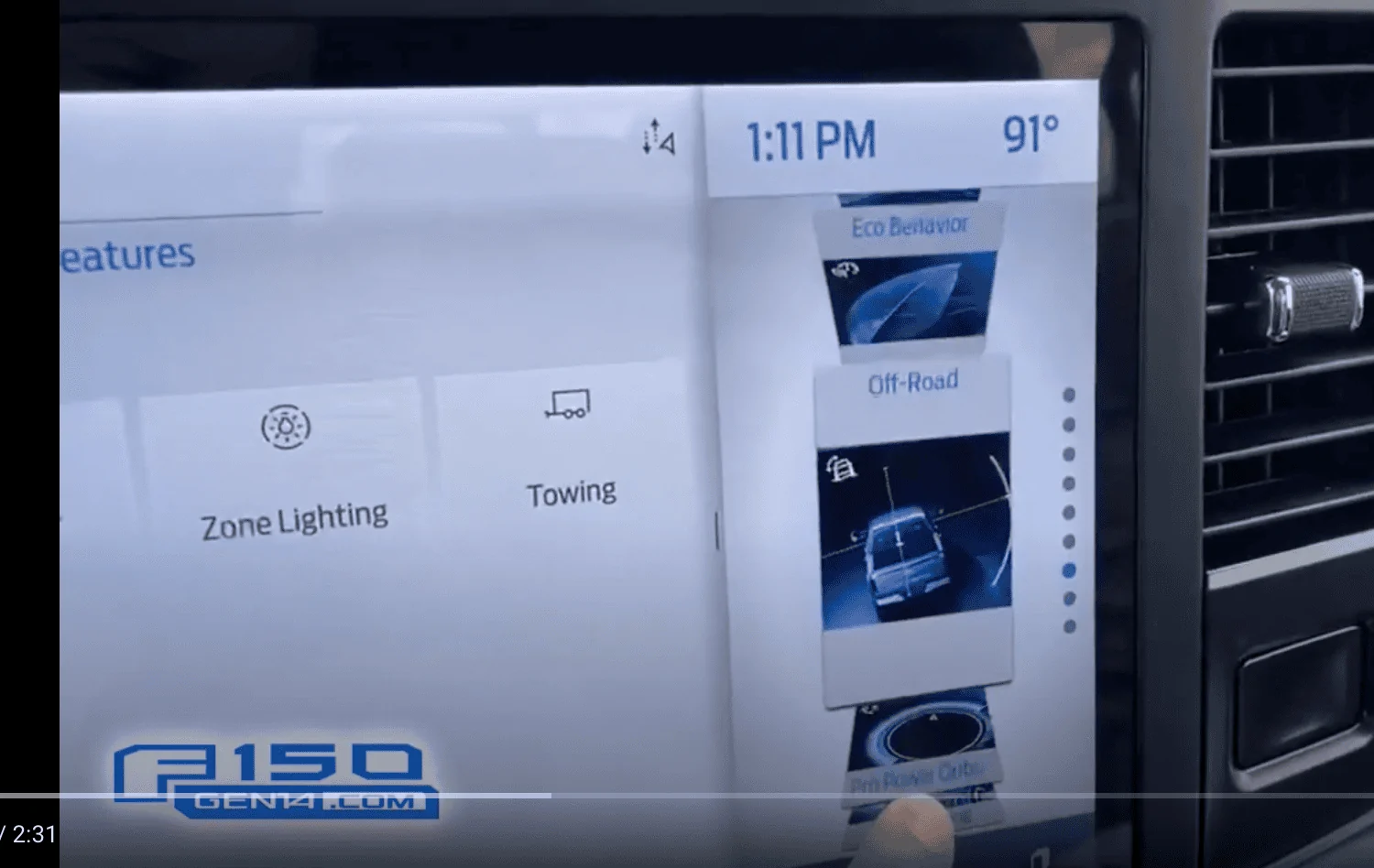

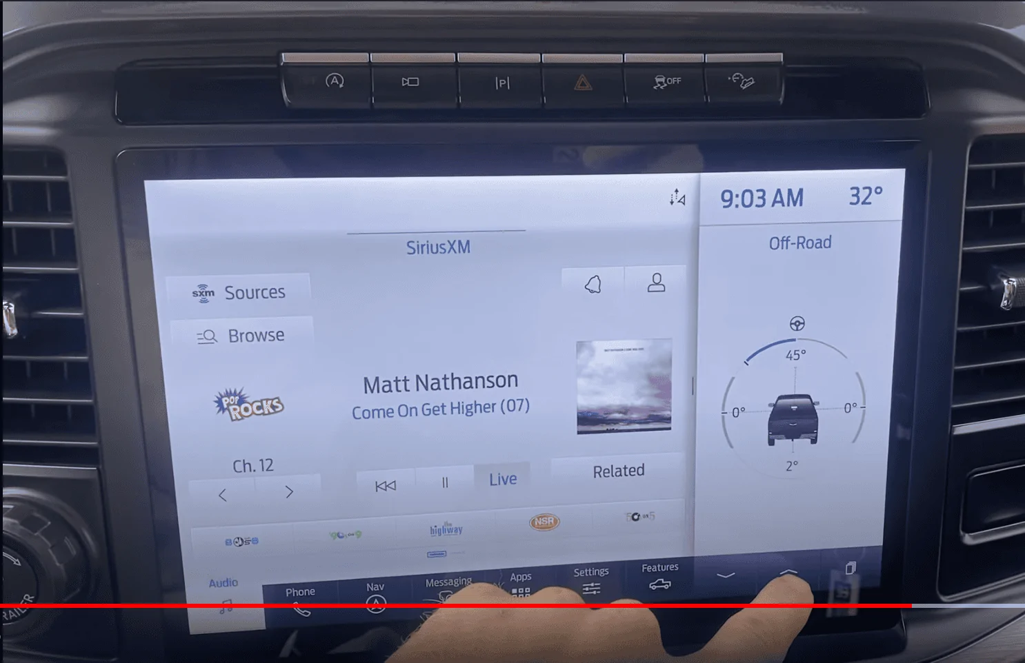

Thought I would add to this thread rather than start a new. Looking through the various Forscan threads. On Gen3 raptor forum came across the coding to add OFF ROAD screens. Have a Lariat 2021 with the post mid year upgrade to Sync. Tried it and they worked. Also added digital temperatures to the dash under the gauges.

Credit to Antho of Fordraptorforum.com
As with anything using Forscan, back up origional files before doing any changes and carryout them at your own risk. IOD is Off-Road screen and IOD #2 is Off-Road Status screen.
