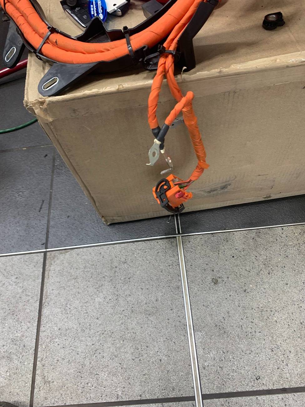

On 1/13/25, after multiple charge failures, the final charge attempt resulted in a "Service Vehicle Soon" message. After returning the truck to the dealership, their diagnostics indicated a charge port failure. The necessary part, RL3Z-14A303-A, was on backorder, but they tracked one down at another dealership.

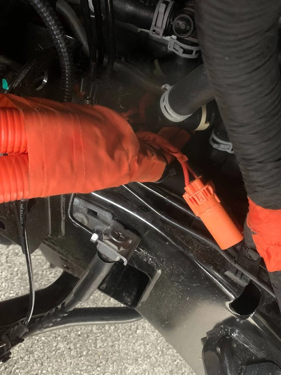

After installing the new part, they discovered that it has an "extra connector" the original part does not have. They confirmed the part and shipping container were stamped with the correct part number, and doublechecked (cross referencing by VIN) that RL3Z-14A303-A was the correct part number. I also tracked down another source for the part, asked the parts tech to double-check their part on hand, and he indicated it too had the extra connector, despite being stamped RL3Z-14A303-A

1 - Can anyone identify the "extra connector" shown in the 2nd image I have attached. First image shows the original port removed from my truck.
2 - Can anyone provide more information regarding the differences between RL3Z-14A303-A and RL3Z-14A303-B, and if those differences include the extra connector on RL3Z-14A303-B

-A is for single onboard charger vehicles (48A charging)
-B is for dual onboard charger vehicles (80A charging, 24MY fleet option only)
The difference in part numbers is the single vs dual onboard chargers. I would wager that for simplicity, all the parts are now the same. The service tech should have the maintenance instructions applicable to the assembly. Were they positive that it wasn't the actuator though?

Just the info I was after, thanks so much!
Sorry for the double message, but by this do you mean to suggest that the -B part is interchangeable, and instructions for using it in place of the -A should be available? I've been told by the service advisor that this is not the case?
