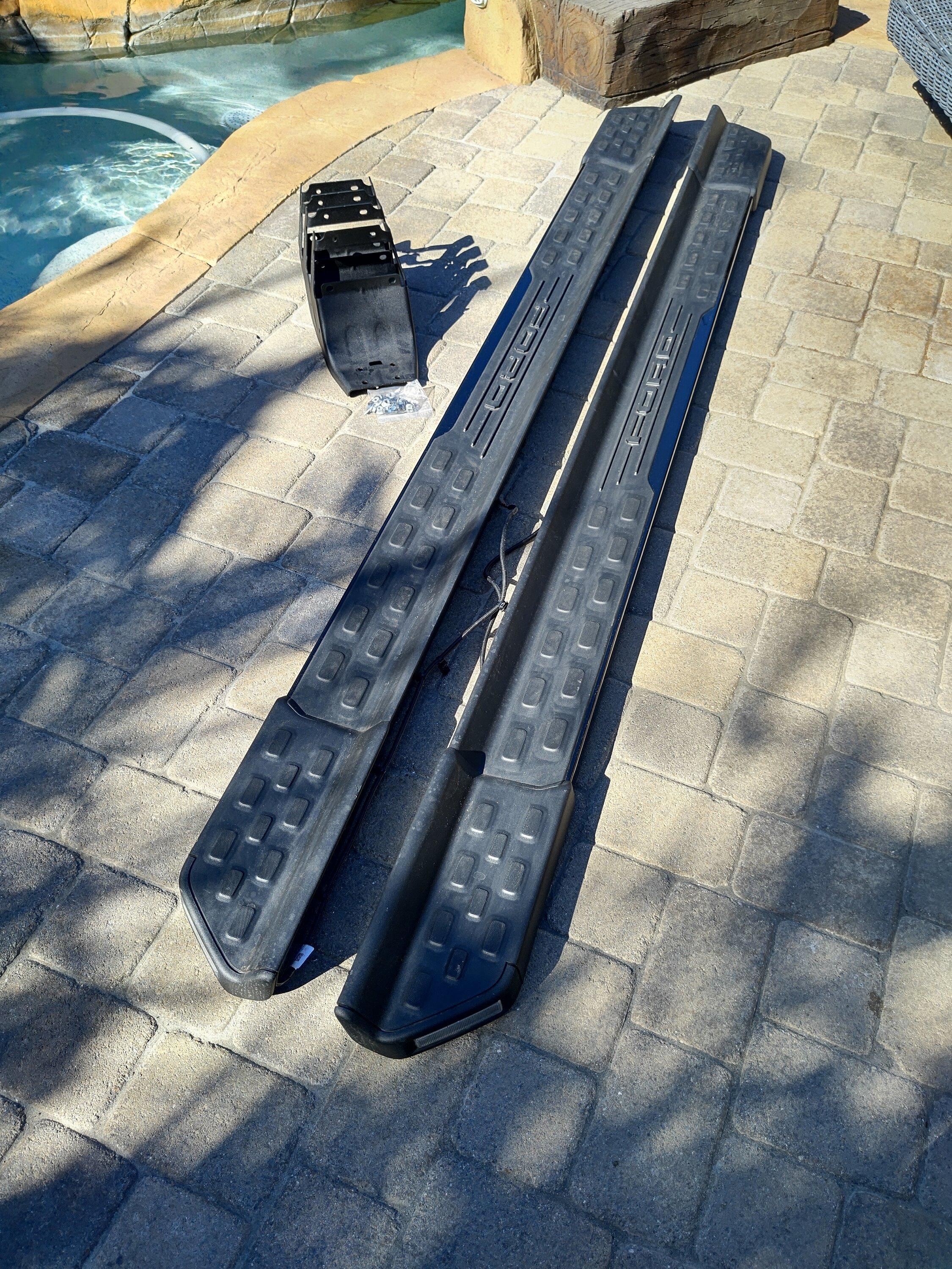

Just 1 set. The delaminating occurs in high heat, keep it out of the heat. Once it cools, it appears to return to shape as well - at least for me so far.
Does it sound like all of them experience this? I’m in NC so it obviously gets hot here

I don’t think there’s been enough data… but it does seem to be a common problem.
I’m north of you and it delaminated, but it returned to form for me when it drops below an estimated 75F would be my guess (not scientific!)

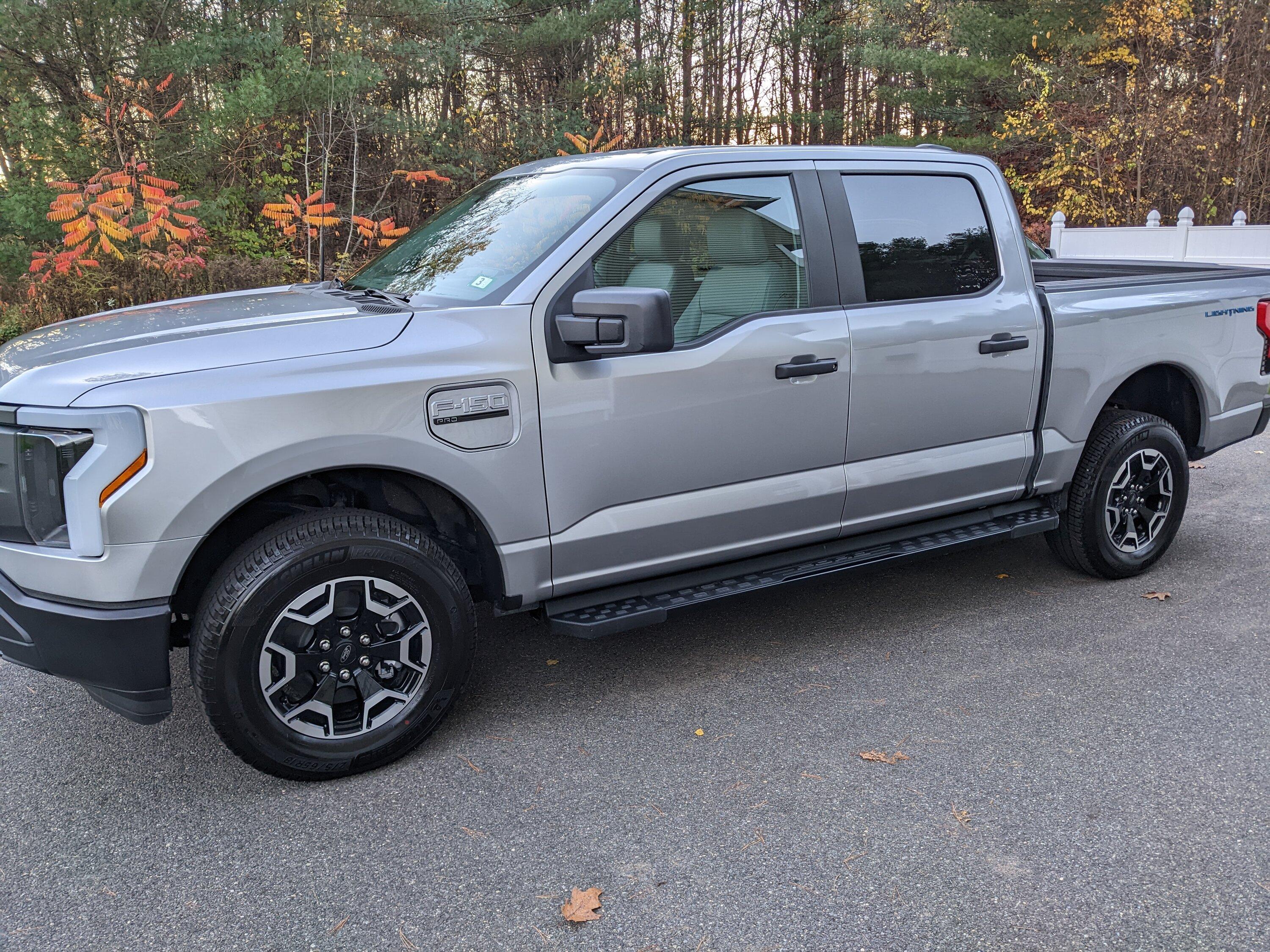

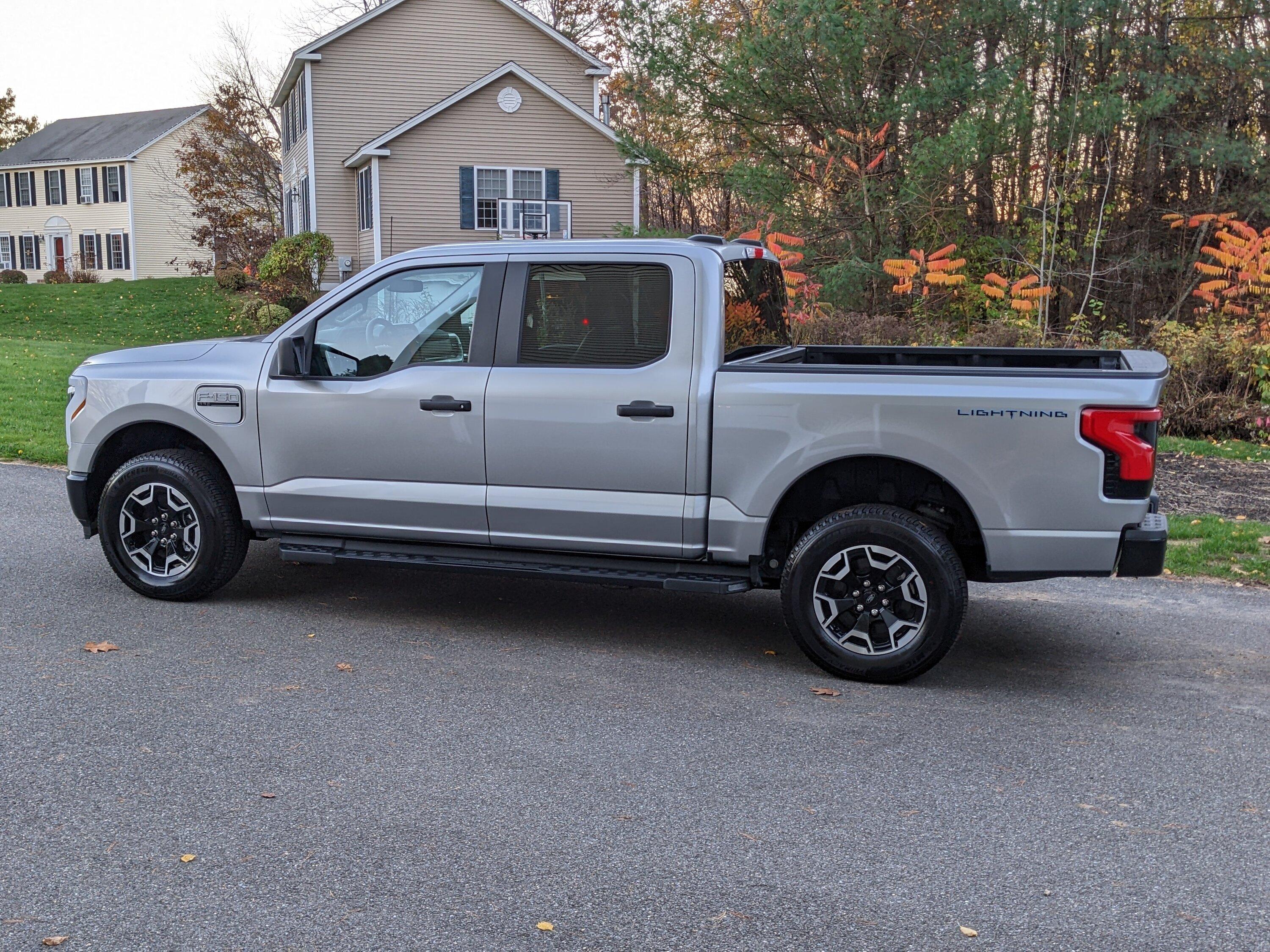

All trucks have the pre-existing wiring and it will plug right in. However, you need to have the tow tech package (or FORSCAN) to make them operational.
If you don’t have tow tech, the boards will bolt on, it will plug in, but you will not have lighting.
@gymgeek can confirm what @Yellow Buddy stated. I don't have tow tech so no lights on the boards for my pro.
