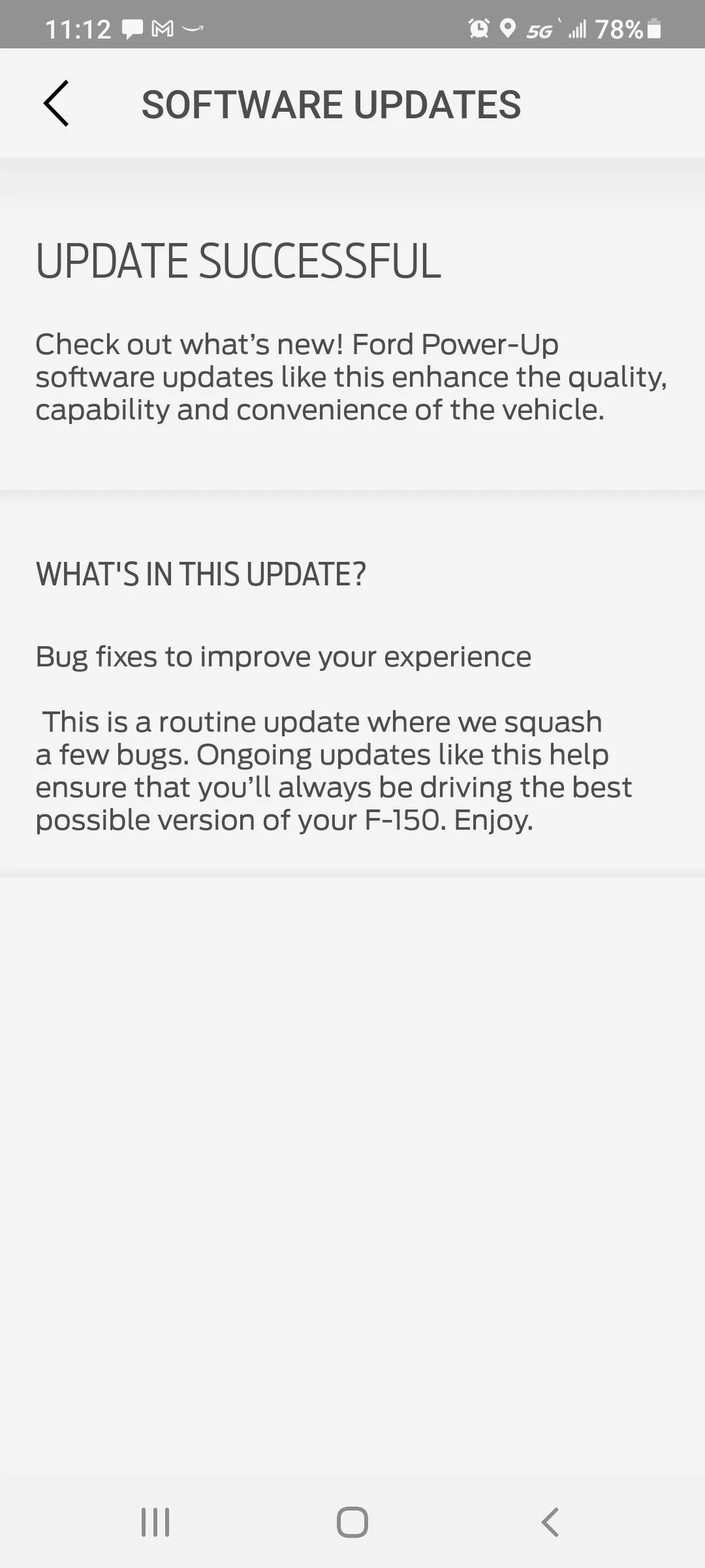

How can I tell what update I got. I cant find details of what update I got. This is the only info I can find
Ford F-150 Lightning Power-Up 2.3.0 OTA rolling out 20220108_173412

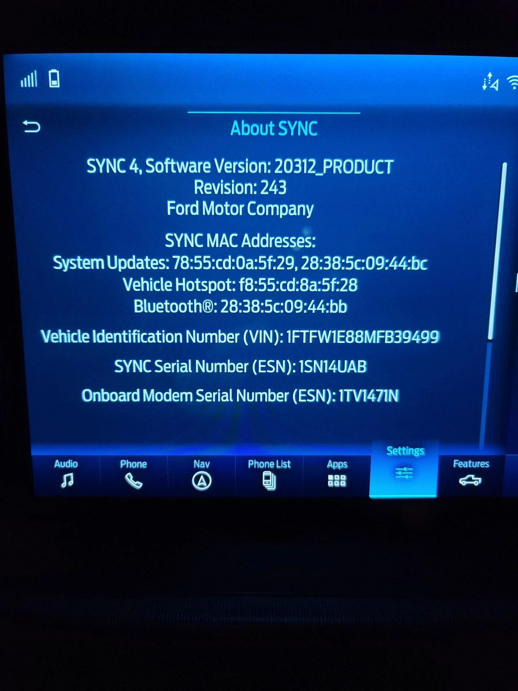

Is there any way to find out which OTA we have actually received?
Your apim is not updated. That is a version it shipped with. If you dont mind I can pull your vin and tell you if you have received anything
Please do I would be very greatful!

I did recieve notice that I recieved an update but there were no details
Ford F-150 Lightning Power-Up 2.3.0 OTA rolling out Screenshot_20220109-111212_FordPass
