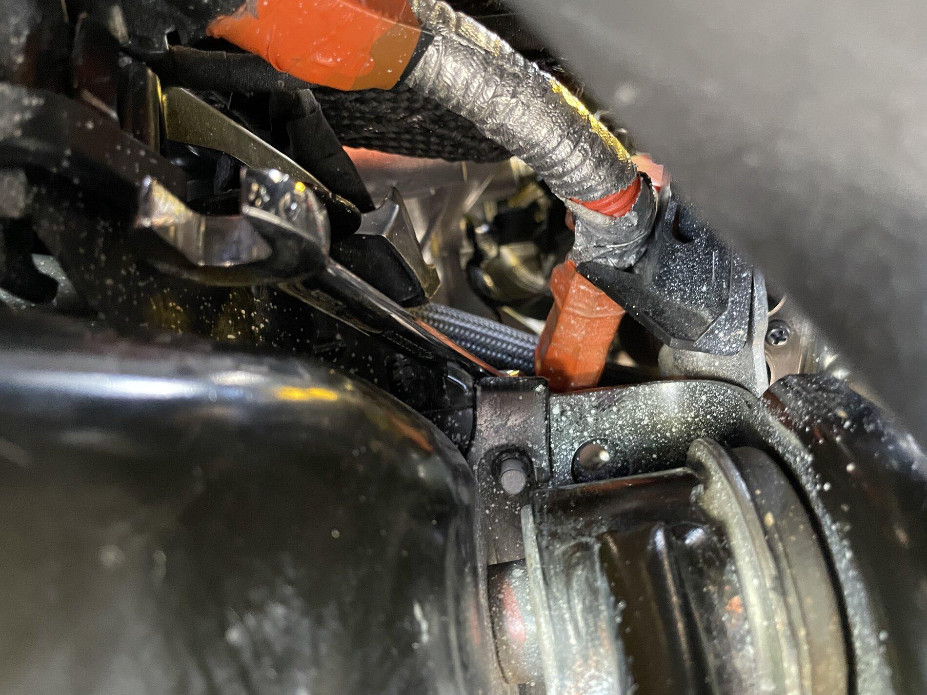

I was wondering if anyone has attempted a DIY level kit with the powerboost. I need information specifically with the removal of the passenger side strut. I can access two of the top nuts for removal but the third one looks to be in a pretty inaccessible spot with the thick orange cord and various other obstacles. I've looked from the top and underneath and cant visualize a way in without removal of a lot of parts. Can anyone shed light on this for me?

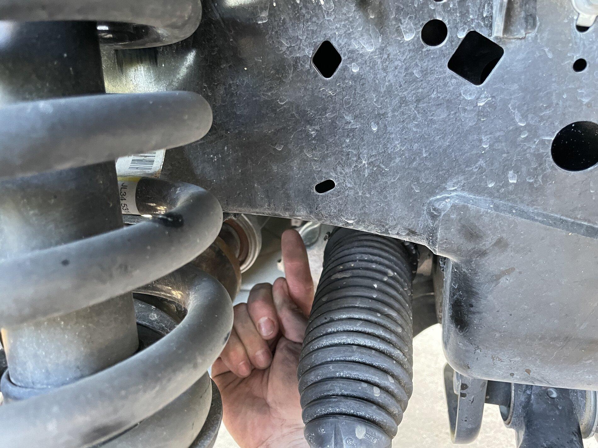

Finally tackled this today. What I did was remove the bolt holding the bracket which secures the wires, it is just in front of the bracket on the shock tower, between the shock and the upper control arm mount (you can see where my flex wrench was on it from inside the wheel well in the first picture). I started on it with a 13mm flex head ratcheting end wrench, but then realized I could reach from under the truck and get a small 3/8 ratchet up in there much easier. MAKE SURE THE ENGINE AND EXHAUST ARE COOL before you reach up in there.

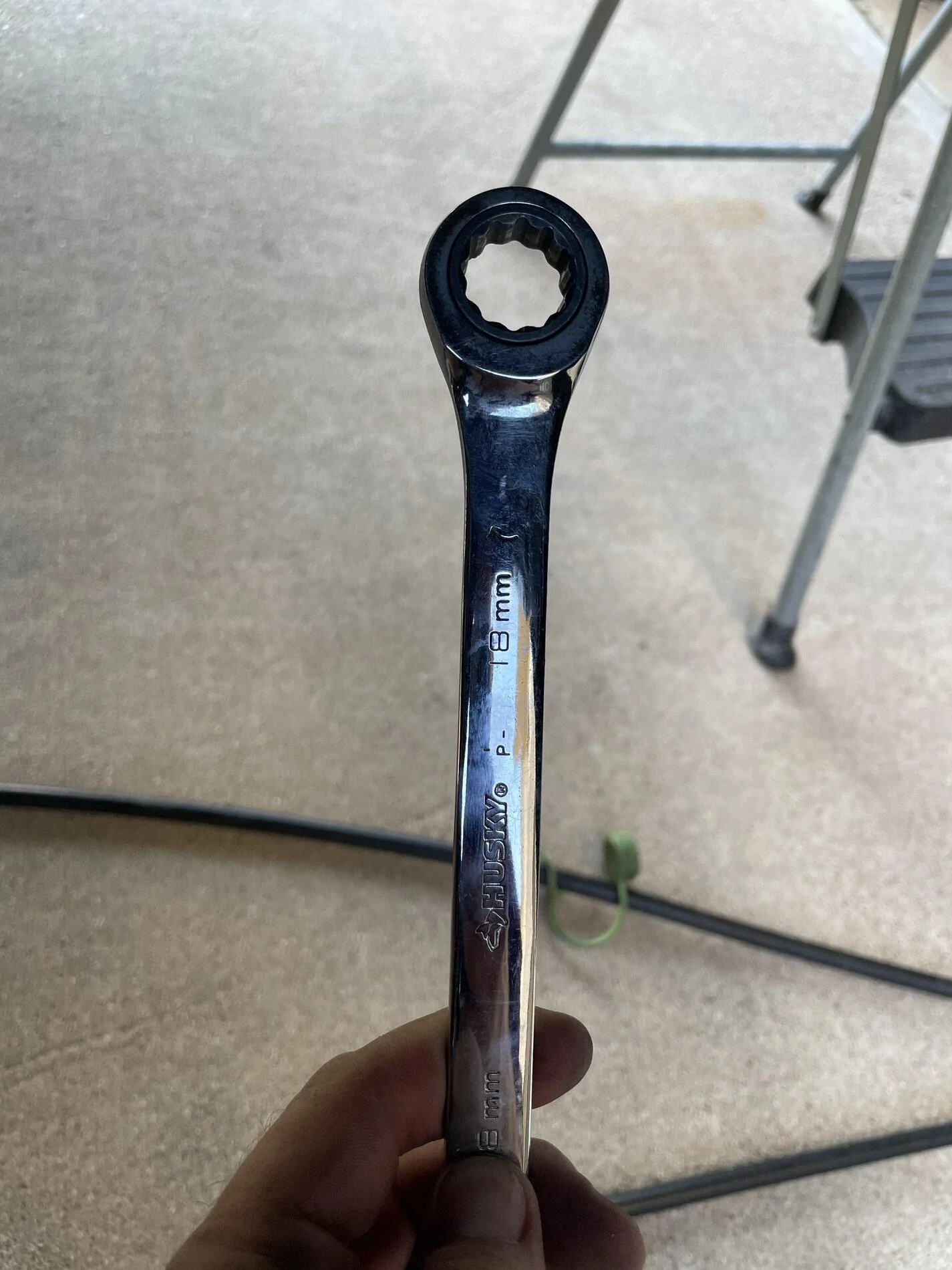

Once the bracket is loose, you can lift it just enough to slide in a ratcheting 18mm end wrench and loosen the back nut.
