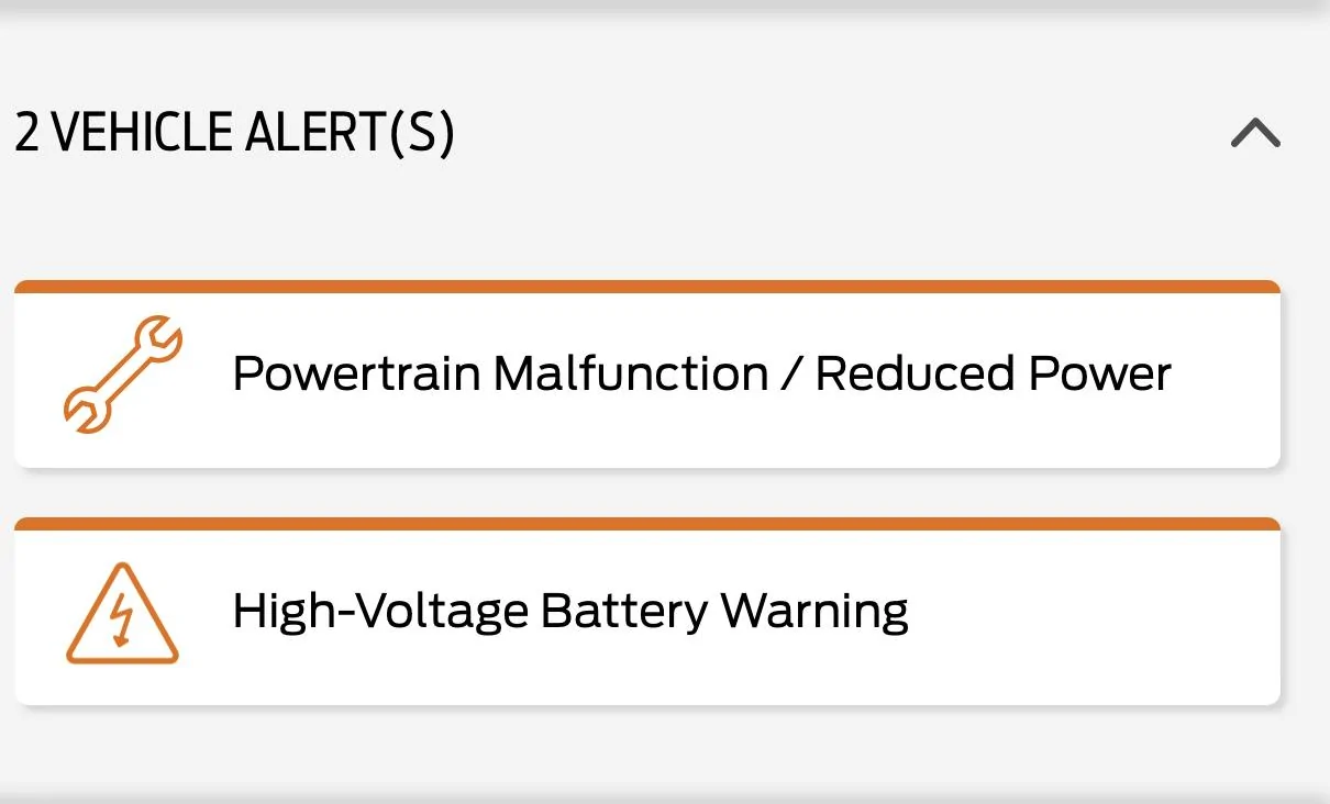

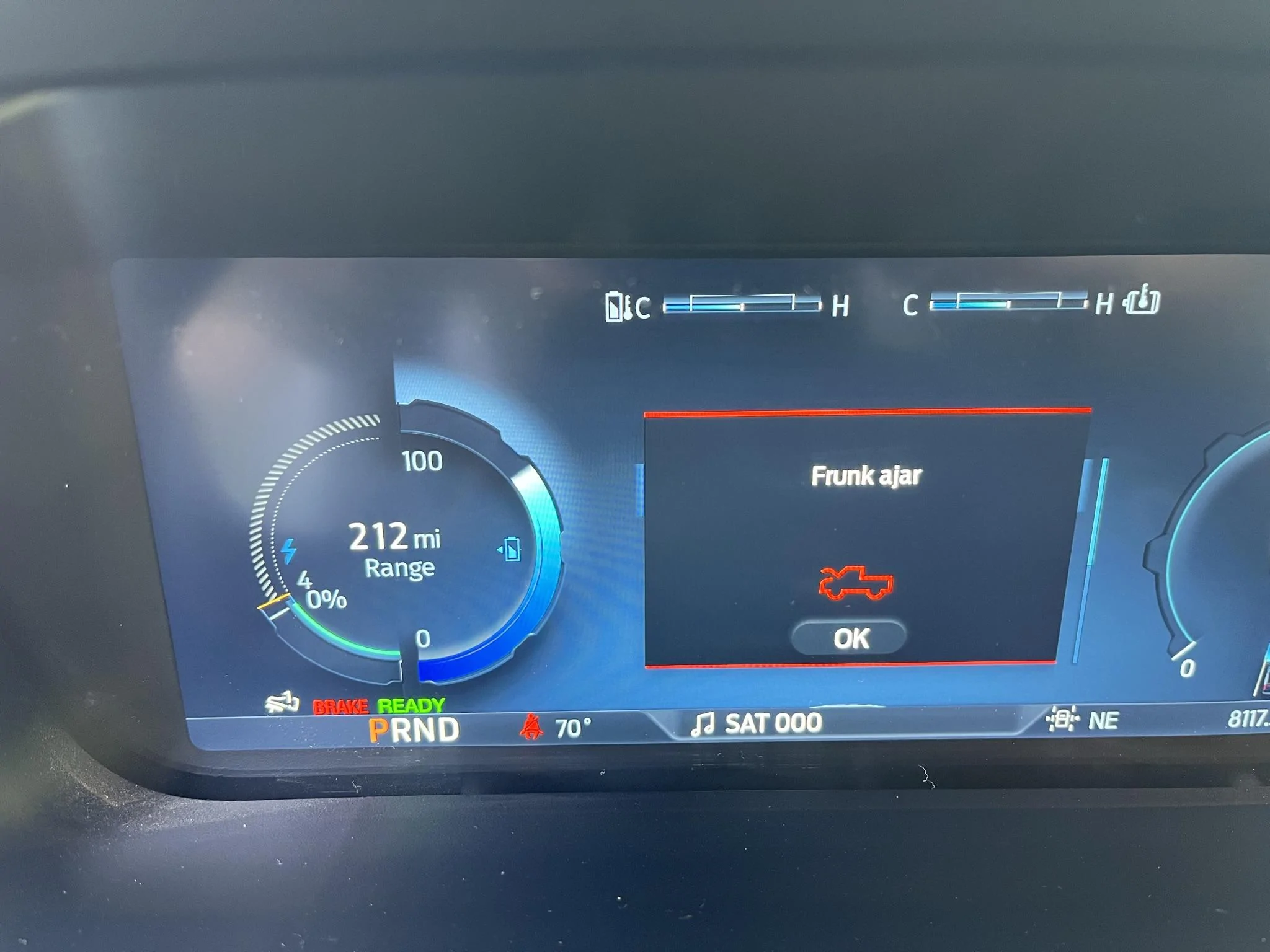

Not to start another thread on this(and moderators feel free to combine), but I have the same issue now. Not sure if all have the high-voltage warning too. Checked the 12v connections. I guess a call to the towing company is what I’ll be doing today.

I did notice that when I unplugged truck this morning it briefly said 100% and then went back to 90%.

I was having similar issues charging and then it dropping to 83%. Got the recall notice. Just charged at electrify America and got fault for first time and now dead in water and stuck. What was your resulution?

Sorry to hear about another issue. They had to replace one of the battery modules (module 3). The early ones took forever to get parts, but the repair seems to go much quicker now.
