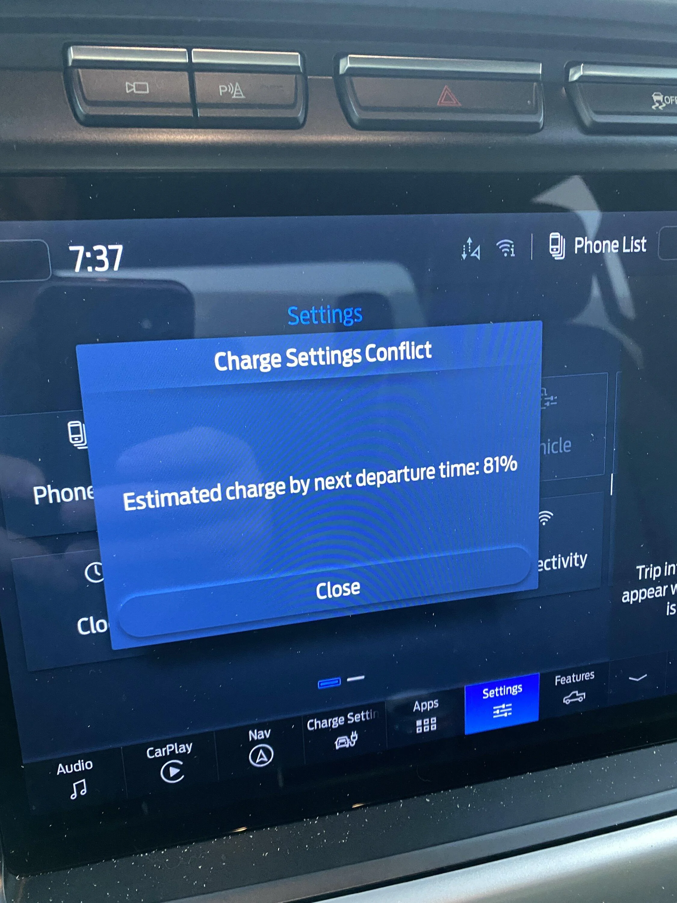

I'm having issues with departure preconditioning and charging times not working. about 10-20% of the time, my predeparture I have set every day, will work. Otherwise, the truck doesn't precondition in the mornings as I have it set, unless, about 30 minutes before departure, I unplug the truck and then plug it back in. Then the predeparture will work.
Also I had charging times set for a night to charge over night, but I had an instance where the truck did not call for charging from the charger and it wasn't charging when it should have. I opened the door, and the truck "woke up" and started charging, as it should, but this was an hour after it programmed to start charging. I could have been stuck at home not able to go to work if it hadn't charged overnight so this spooked me and I turned off charging set times.
I'm now getting a pop up on my screen sometimes when I turn off my truck after driving with a message that says "estimated charge by next departure : xx% , charge settings : conflict". I attached a picture below of the notification....
This pops up without my truck being plugged in after driving.

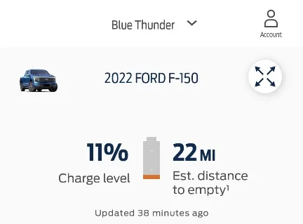

Not charging overnight got me last night. I had to drive my 100 mile round trip commute in 30 degree weather with no heat to make it to work and back. Can you imagine having to explain to your boss that you couldn't come to work because your vehicle didn't have enough charge?
This is what I ended up with. My original DTE was 128 miles. No way I would have made it with heat.
Exactly. I gave up relying on the charger timed, too risky for work
