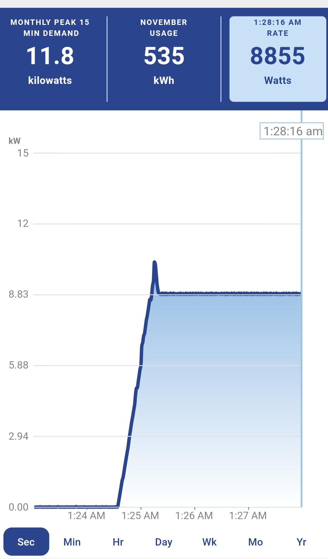

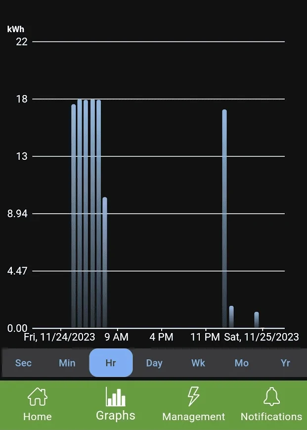

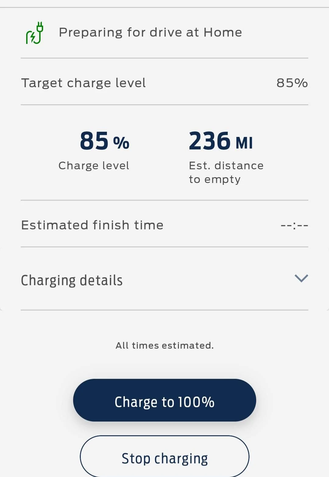

Temperature in WI hit 21f. Looked at my Ford Pass app and says "preparing for drive at home". Emporia app shows it just started pulling 8.8kw. I only charge to 85, battery shows 85, so it must be pulling power to heat the battery. I don't have any departure times set. I've kept it plugged in because yesterday it gave me a message saying it's cold out and to plug it in. Something new I learned, thought I'd share.
