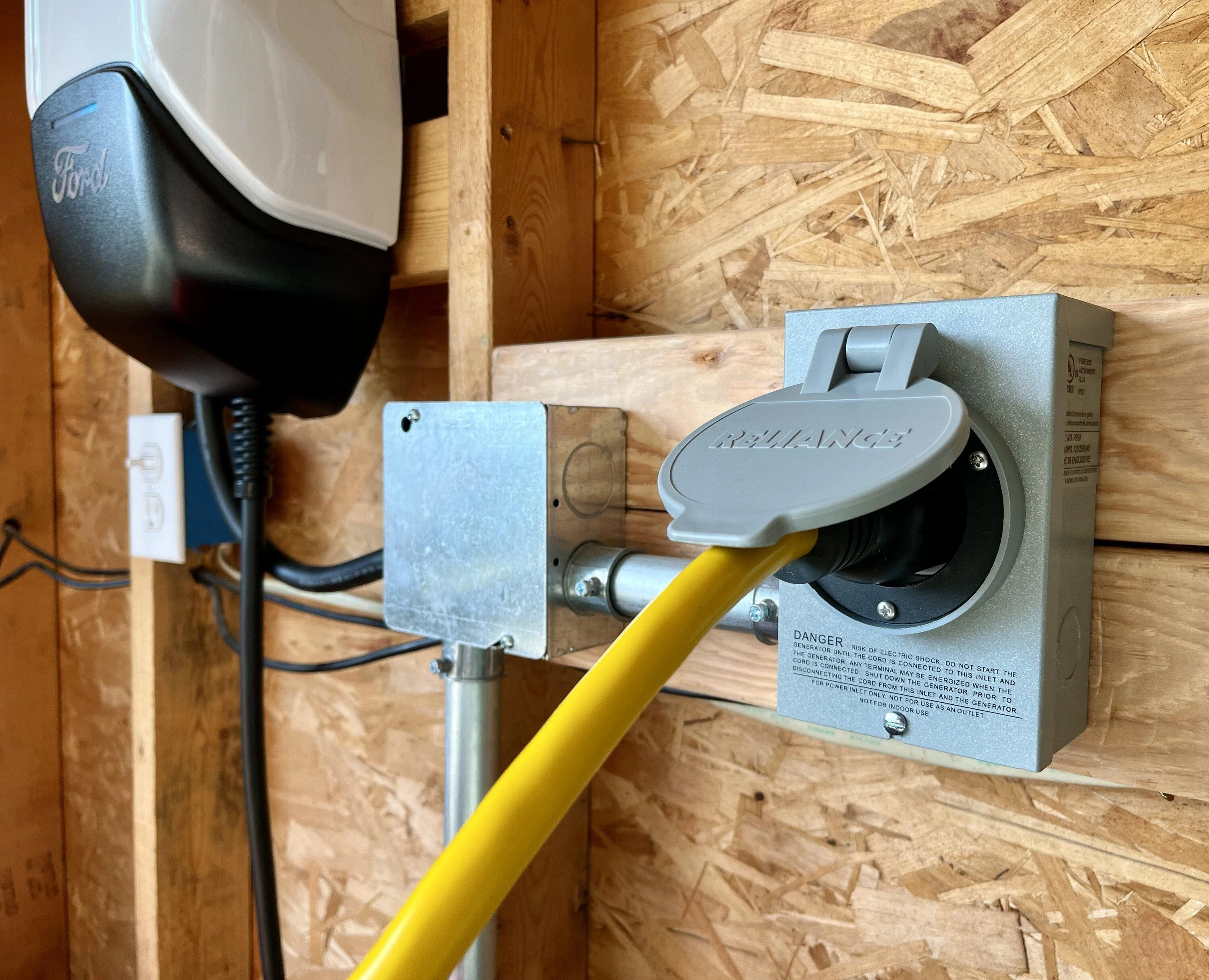

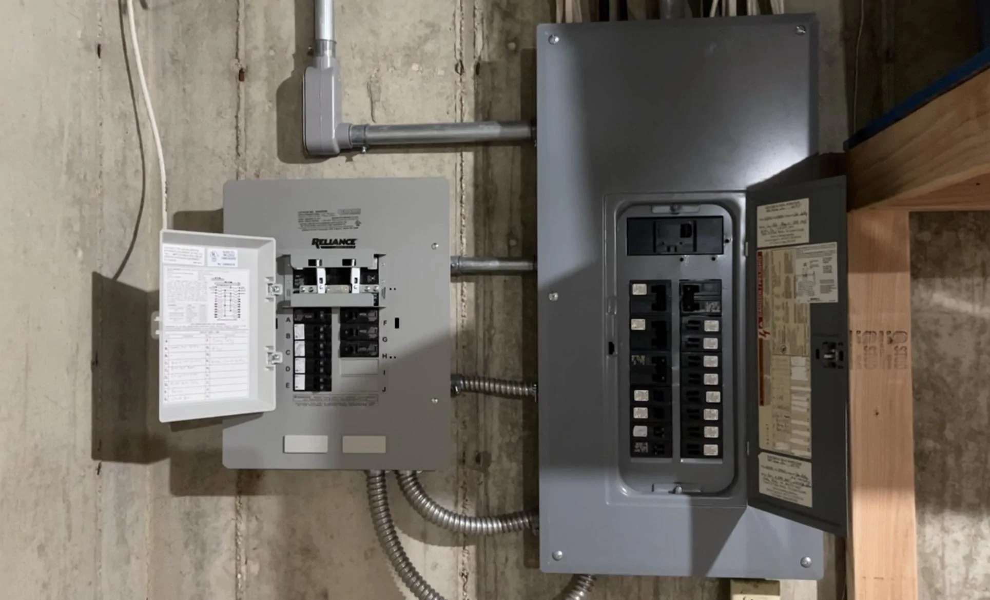

I successfully sent power back into my home from the 240V/30A Pro Power outlet in the bed, the truck did not trip. I had an electrician install a Reliance LinkX neutral-switching transfer switch for GFCI generators, moved most of my home’s essential circuits into the transfer switch… tested it out by connecting my Lightning to the inlet, cut off utility power, turned on the transfer switch, and it worked like a charm!
This is basically the simplest and cheapest solution to power your house within code using the truck’s 240V bed outlet… no “suicide cord” and no questionable ground or neutral switch on the inlet. I won’t say what the cost (since there are so many variables to each installation) but it was a fraction of the reported cost of the Intelligent Backup Power system.
Please note: You have to use a transfer switch specifically designed for GFCI (neutral-bonded) generators. A normal transfer switch for backup generators will not work because of the neutral-switching issue.
30 amp generator cord connected to the Lightning:
Generator cord inlet’ed to the transfer switch:
The Reliance neutral-switching transfer stitch (it switches off one of the neutrals in the loop so you don’t get the fault in the truck):
Pro Power Onboard powering the circuits in the transfer switch… only drew about 500W:
