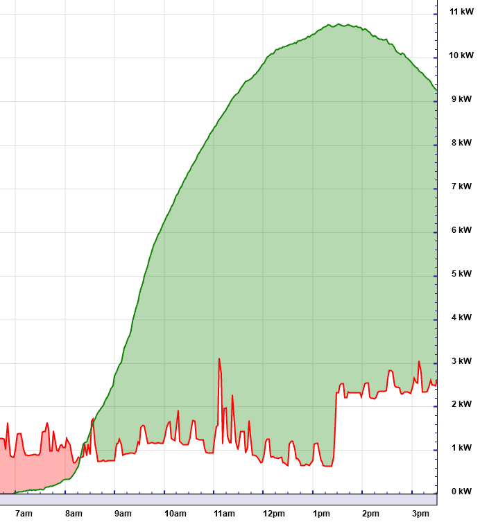

80% is a decent number for the MAX output at the peak part of the day but don't count on it all day.
Snapshot of my system performance today. Again this 14.5kw in panels.
Ford F-150 Lightning Rack mounted solar/PV, power generation - calculations/math help 1661977951780
This shows my max at about 75% (10.75 / 14.5) and my math says I average 55% over the 10 hours of sunlight (8kwh average over 14.5; 80kwh/10 hours)
