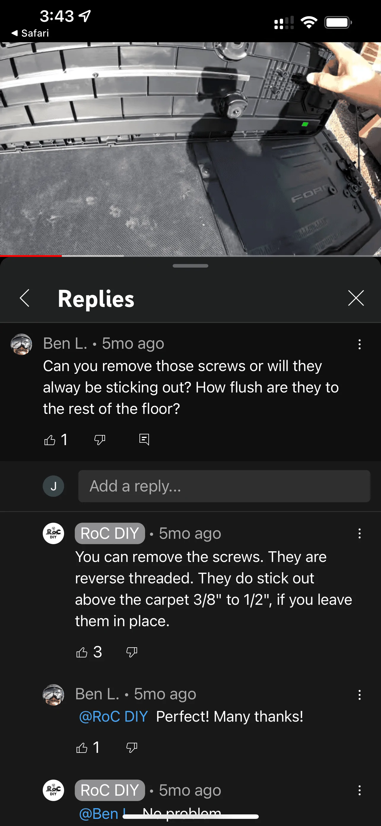

Check this out:

I would bet that the bolts are 'all thread', and should be able to be unscrewed using vice grips.
I agree.l with ya. Only issue is you’ll damage the bolts thread when you remove it so if you want to reinstall it later you’d have to replace the bolts (aka go to ace hardware).
A less damaging to the threads way is to run 2 nuts on the stud, tighten them against eachother, then use the wrench on the 'lower' one to unscrew it (assuming RH thread). The above implies it might not be all thread, and is instead a different thread on the bottom, so you'd use the 'top' nut in a tightening motion.

Studs can not be removed because they are not studs. They are a bolt that come up from the outside of floor and up into interior. If you try to back them out they hit the top of the battery pack before they are all the way out. You cant reach them because the pack is in the way so even if you were able to back them out you'd never get them back in. Only way I could see them was with a mirror.
You could probably screw them out about halfway then but a nut on the remaining threads to keep them from backing out further. That would save you about half and inch of thread poking through carpet.

When you say you saw them with a mirror, were you able to get the mirror in between the battery and the underside of the floor? Meaning, could a telescoping magnet be worked in there to remove the bottom side of the bolts if they fell down?
This is a huge bummer if you can't remove these. I would cut them but don't want them rattling around. The flat floor on the F-150 is the THE reason I'm shopping it. Why did they ruin it with this stupid design? I mean, it's a challenge to design the seats so that they don't require a lower bar support in the first place. Then they junk up the flat area with this thing? Ugh...
You can't pull them out because they hit the top of the battery pack before they are out of the floor. I suppose you could cut them off from inside to make them shorter then unscrew them, but you'd never get new ones in again.
I might suggest cutting it short enough to get them out, and when you want to put them back in, just use a double-sided stud, and it would have the same effect/usefulness.
