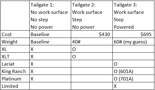

I just put together what I remember from deep diving into it a while back. Each trim (except Limited) only has 2 out of the 3 tailgates possible, as you can see here. X means base and O means optional and I listed the package that forces it as well. Otherwise O means a la carte. Regarding the weight, 40# is payload impact from previous generation and is likely similar in '21. My total guess for the extra motor is additional 20#, I have not seen a definitive conclusion on that (would require 2 equivalent Lariats to share payload stickers with and without tailgate)
Ford F-150 Lightning Retrofitting Tailgate w/ Step 1614289435357

The gee whiz factor of the power tailgate and pull out step is obvious. I'm trying to get as much payload capacity with the PB 502a Lariat and the ~60 lb. hit of the step seems like a lot. A small step stool will have to suffice for our truck.
