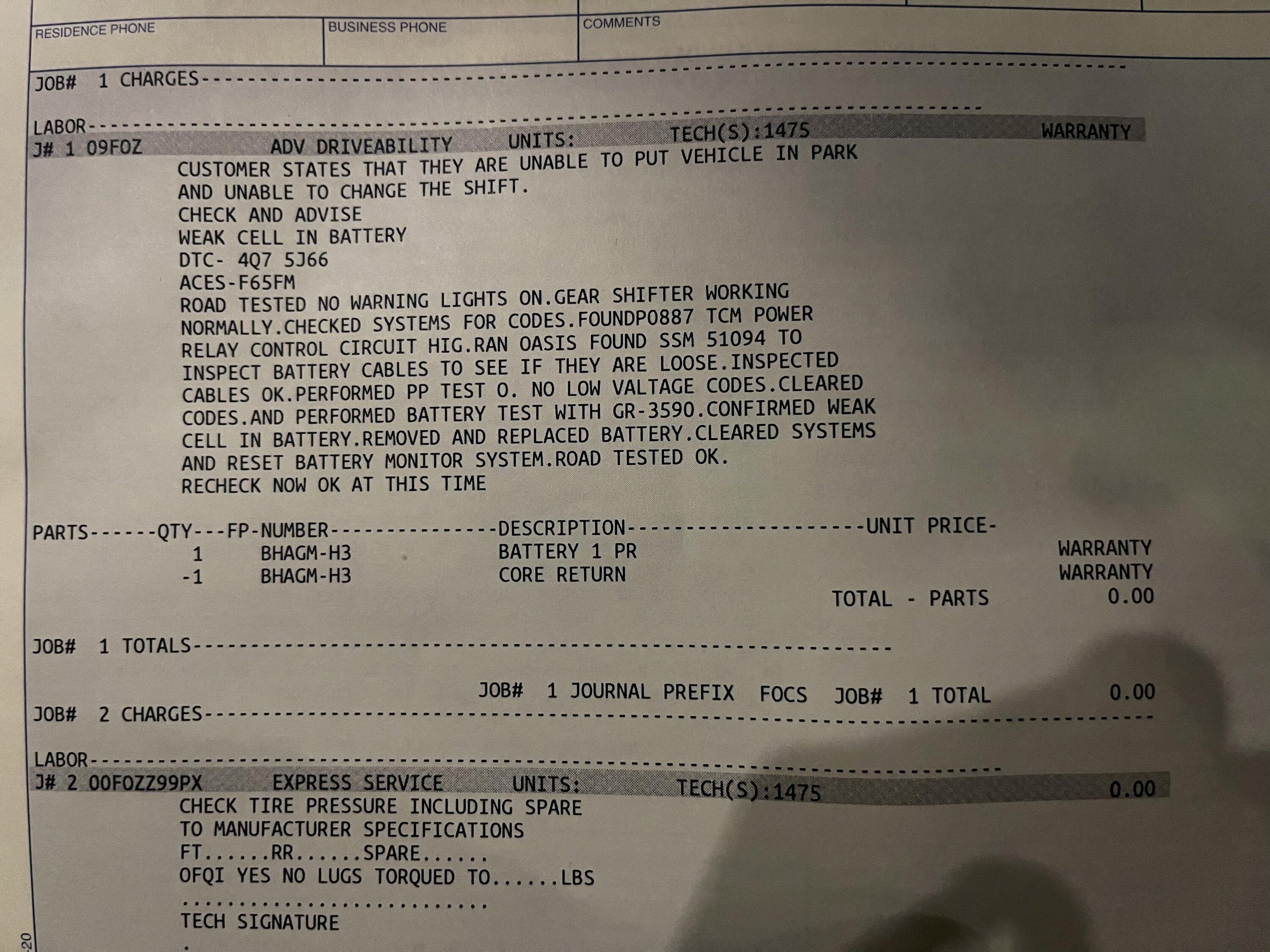

Alright, so I have a bit of an update. The dealer I took the car to was pretty good about communicating with me. They were able to resolve the issue by replacing the 12V battery in the car. Apparently my 12v battery had a bad cell in it, causing the shifter to not engage park.
i attached the service record that they typed up.

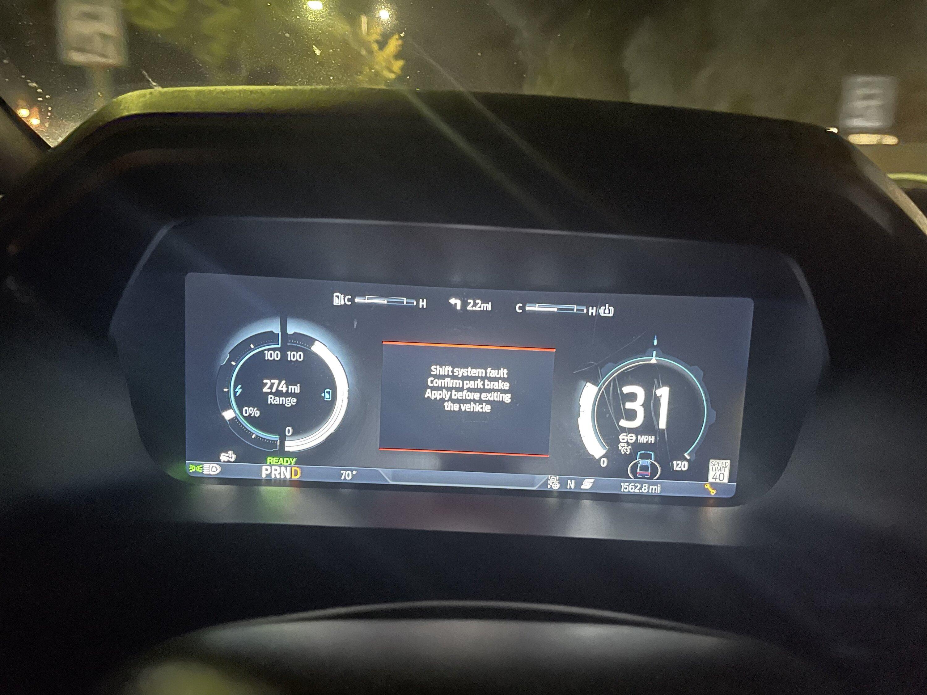

but then, today when I was driving home, the issue happened again! But this time the car was in reverse.

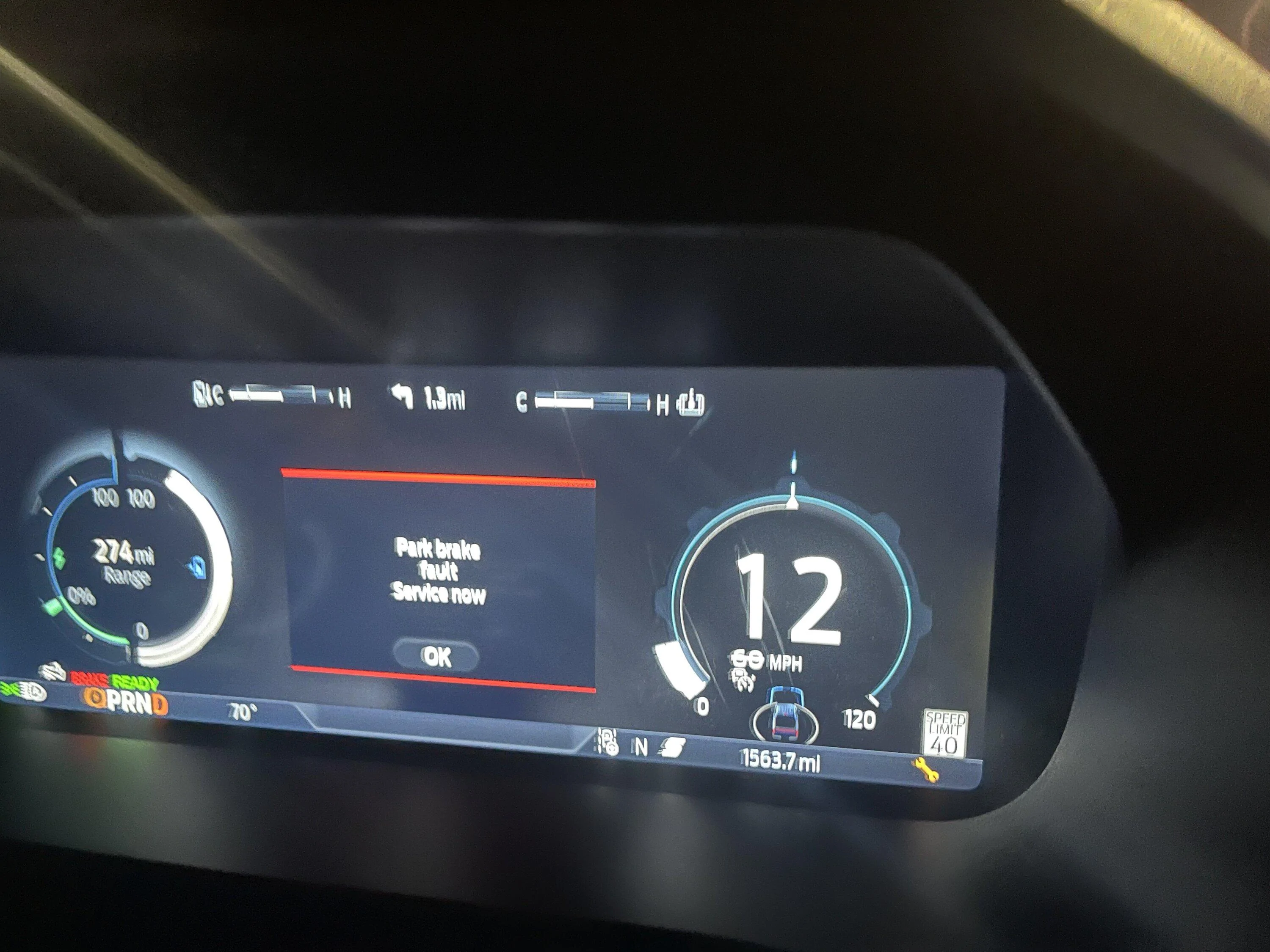

I was trying to park the car. I pulled into a spot, but I needed to correct my parking job. As soon as I put the car in reverse, I got an alert that the shift system had a fault. I was able to put the car in drive and get out of the spot I was in. The parking brake was also engaged, and would only disengage if I held down the button.

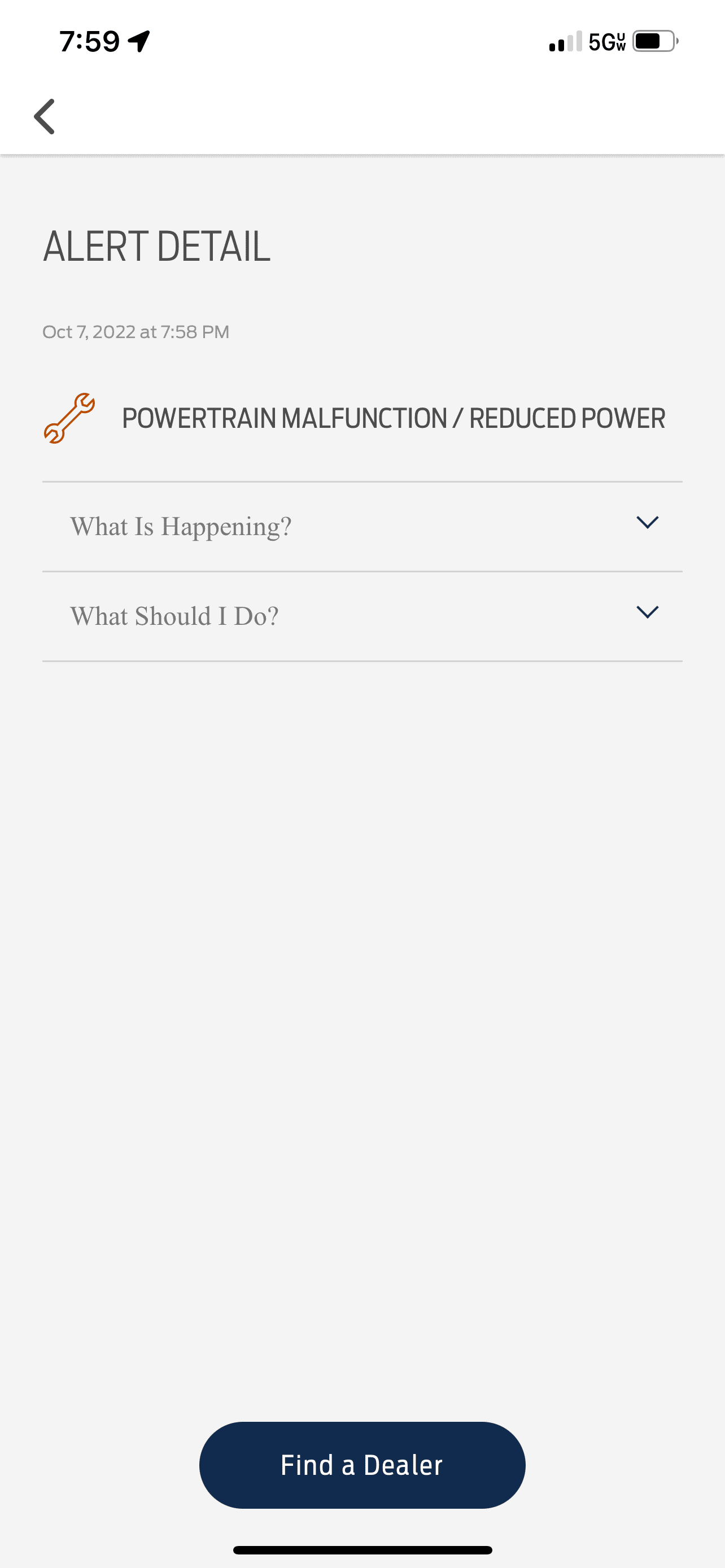

I was too afraid to turn the car off. I also checked the Ford pass app, and it said that there was a power train malfunction. I attached this photo as well.
I drove for 3 miles (while holding down the parking break button) to the dealer that completed the service and turned the car off. I was fully expecting the car not to let me put it in Park. I turned the car off, I hoped out of the car. I waited a second and then turned the car back on. The alert went away.
My FordPass app also says there are no active alerts. At this point I’m going to take the car home and return it to a dealer tomorrow.
