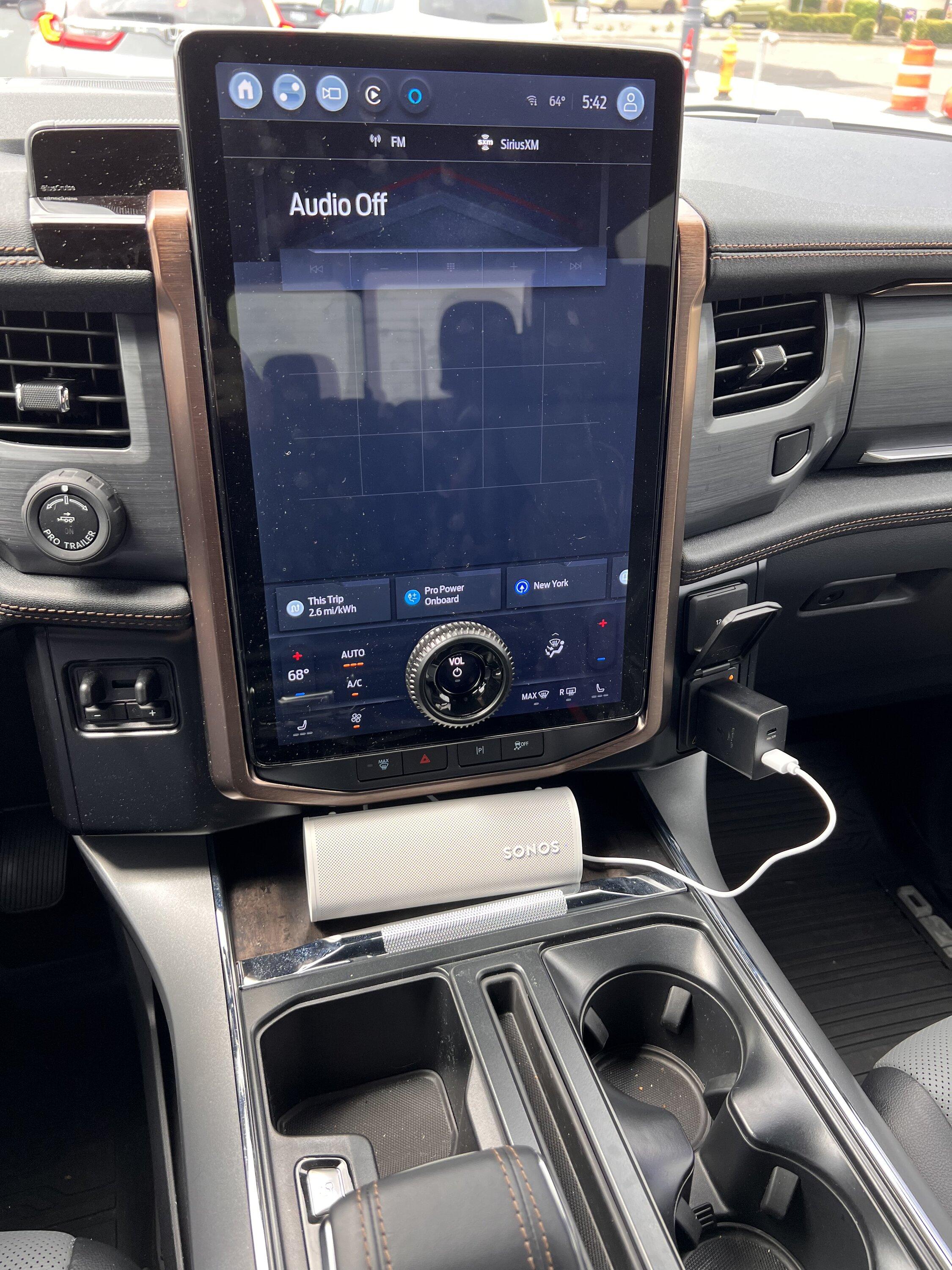

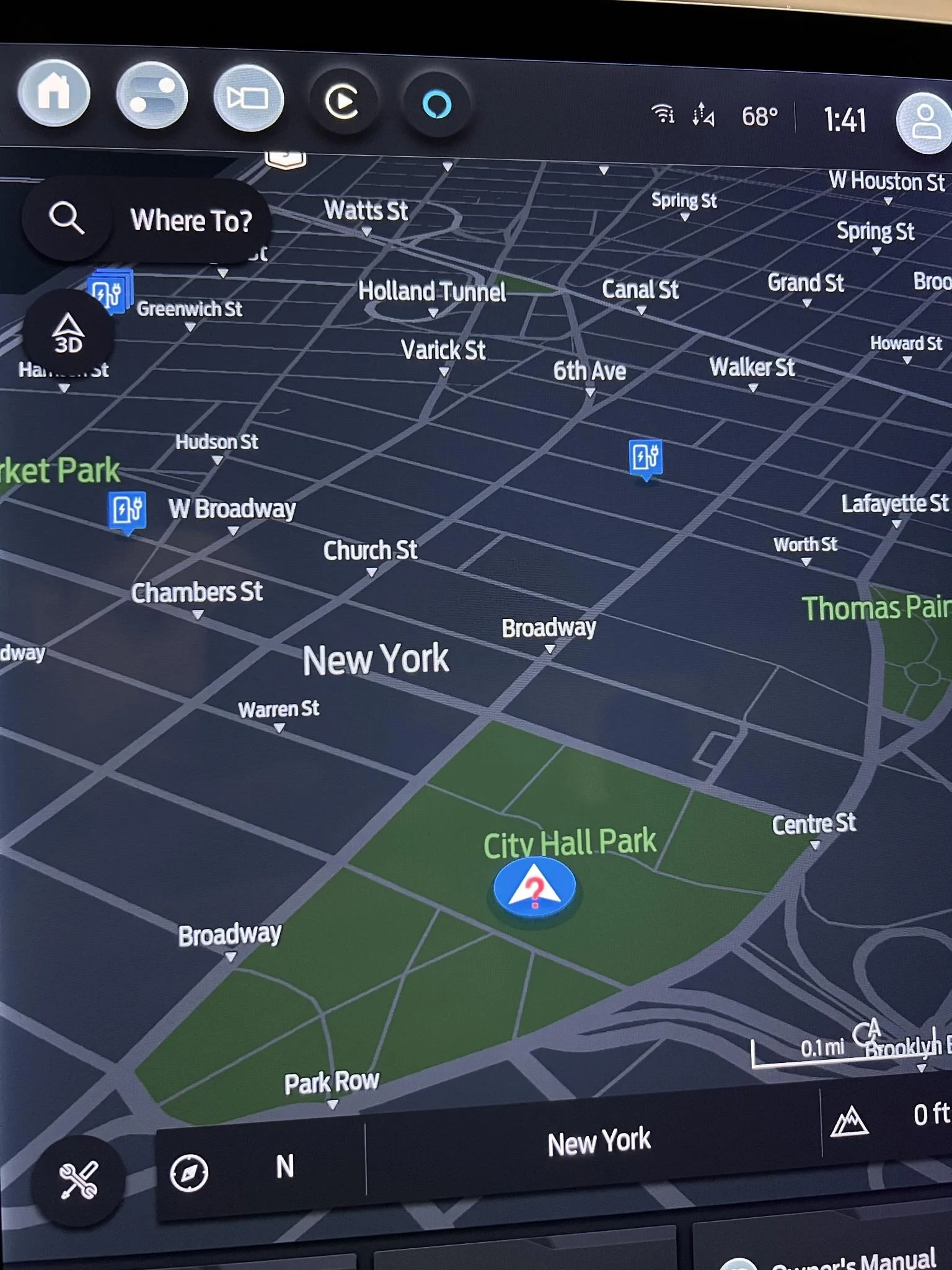

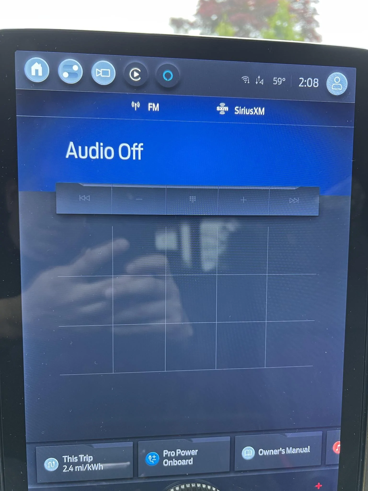

I recently had some work done on my truck, including having the bed sprayed, installing PPF, and applying ceramic coating. However, after picking up my truck from the shop, I encountered some electrical issues that I'm seeking assistance with.

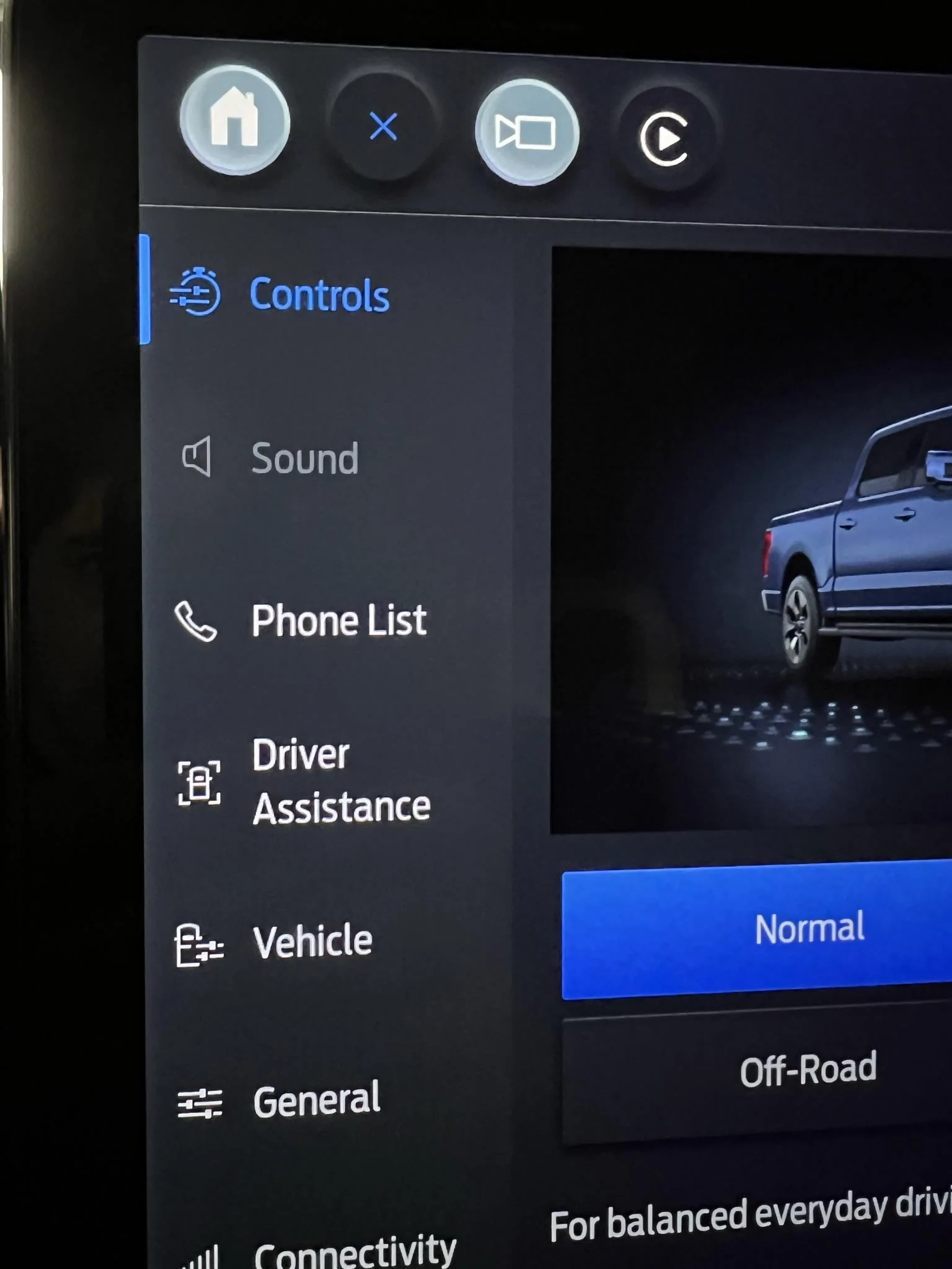

Upon receiving a low voltage message for the 12V battery on my phone, I realized that the sound system was off and unresponsive. Additionally, the GPS wasn't updating, the time wasn't auto-updating, and I noticed that the sound settings are greyed out in the system settings, preventing any adjustments. I've tried troubleshooting the problem myself and here are the steps I have taken so far:
  1. Checked power: I tried pressing the power button, but the sound system wouldn't turn on.
  2. Steering wheel button reset: I held the volume down and forward buttons on the steering wheel to see if it would restore functionality.
  3. Battery power reset: I disconnected the power from the 12V battery for 5 minutes and then reconnected it, hoping to reset the system.
  4. Factory reset: I performed a factory reset on the SYNC system to see if it would resolve the issues.
Despite these attempts, the electrical issues persist. To provide a clearer understanding of the problem, I have attached some pictures of the error messages, the unresponsive system, and the greyed-out sound settings in the system settings.
If you have any insights, advice, or suggestions, I would greatly appreciate your help in resolving this matter. I'm unsure if the problem is directly related to the work done on my truck or if it's coincidental.
Thank you in advance for your support and expertise.
Best regards, Mandalorian

Did you go into the Connectivity tab–bottom of first picture–and make sure that they haven't been turned off? (not that that would explain the sound system issue, but who knows?)

Yes. The connectivity is all on.
